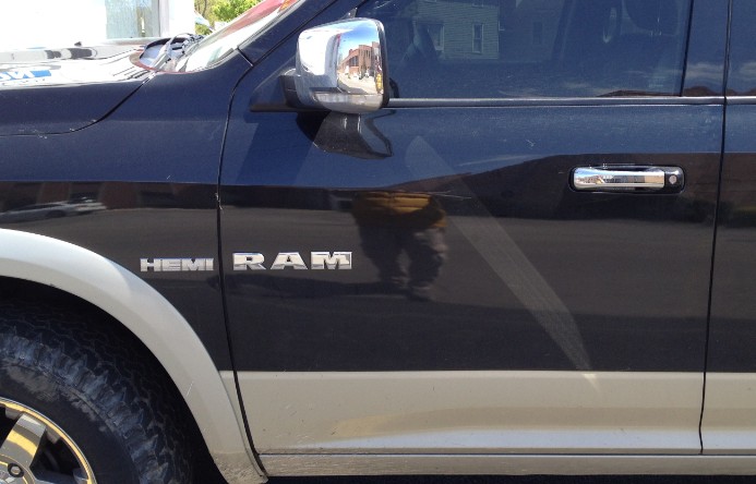

Removal of Dodge RAM emblem
Dennis Schaub
the photo...
letterman7
Just tape, I usually put a plastic scraper behind them and gently lever them off the door. Remove adhesive with your choice.
sar bossier
We recently wrapped our Dodge - high test fishing line, heat, and "saw" the line across - removes most (if not all) of the adhesive, and the logo ...
