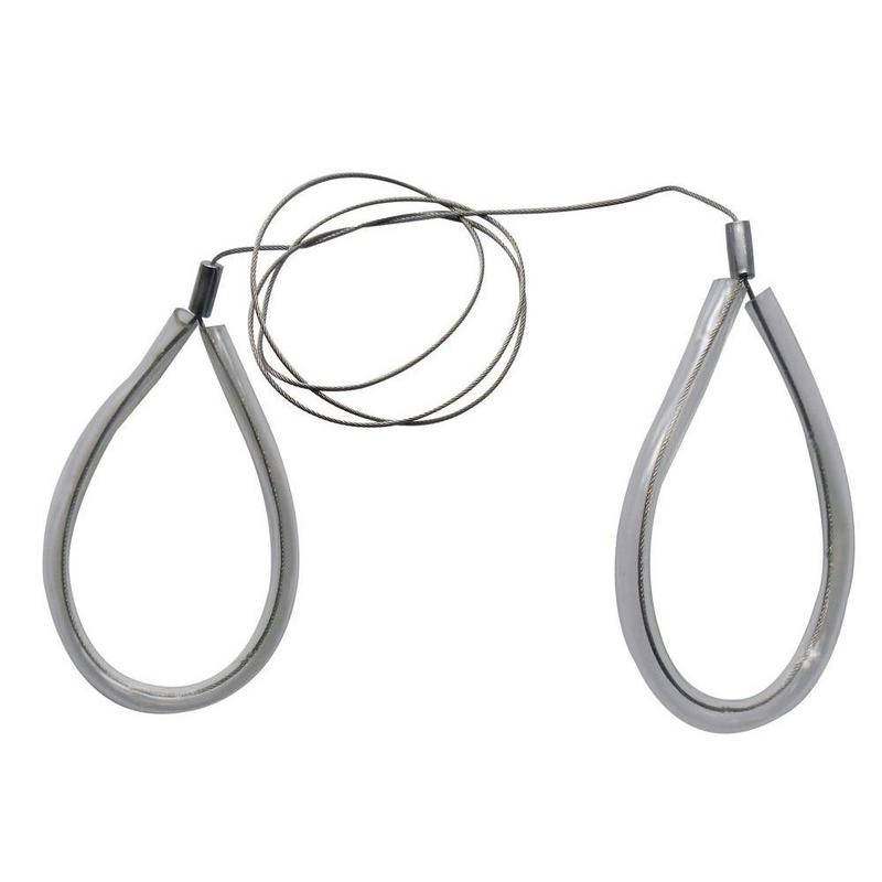

Over the years I have used the classic PVC Cable Saw to remove letters and graphics glued to the wall. They are cheap ($6) and have a fine tooth like quality to the wire (more like a spiral) and padded handles at the ends. It does a good job and does not cut into the wall as you pull back and forth and down at the same time.
When you notice the work is getting harder, just start using a new one until it the work slows down again. I keep one in my install tool bag all the time.
http://www.homedepot.com/p/HDX-PVC-Cable-Saw-TUO0002J/204284854?keyword=PVC+Cable+Saw

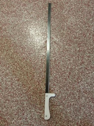

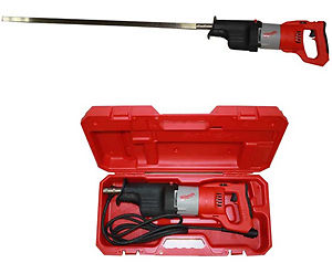

Another idea is to put a long flat blade into a replicating saw (with no teeth), and let the saw do all the work starting at the top and letting the weight of the saw do the work as you move down the wall.
The pre-made is a little pricy ($400+), however we all have a replicating saw, so all we need is a blade, even if you have to cut the handle off the manual saw and grind the end to fit into your replicating saw. This would be the fastest and easiest way to remove so many letters.
