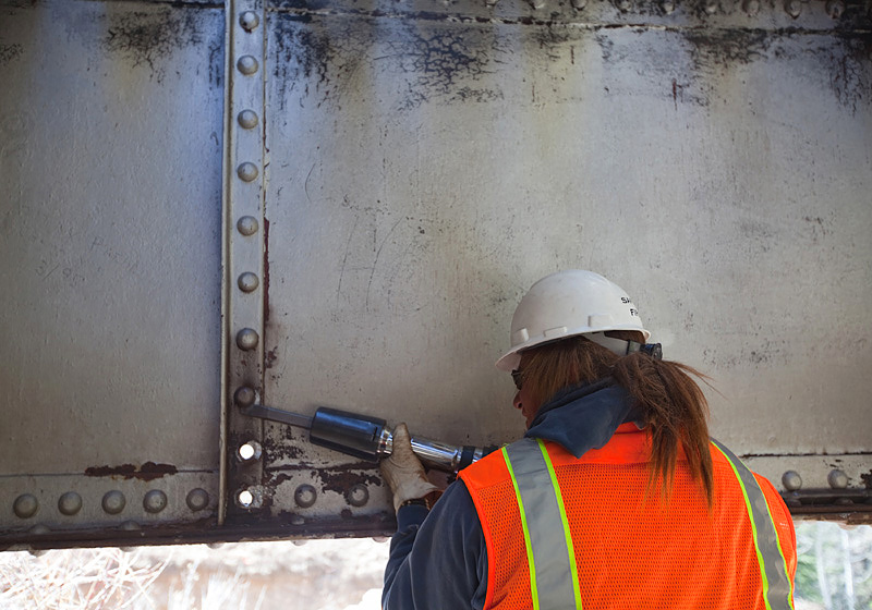

If it is a matter of time one of these will make those rivets a distant memory in no time flat.
(just need a good air compressor).
