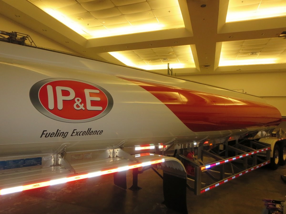

Good wrap
GAC05
Quit buggin' me
Good design but paint and a small decal would be the better method and last longer. Probably cheaper too. We could do it for $4-5k all in with a nice profit.
We are not allowed to paint in our current location - no space - no booth. They did try to save some money and had a few of their tractor heads painted to match. They saved too much money and soon had pink tractor heads fading fast pulling wrapped trailers that have stayed bright red for a pretty good number of years 6-8.
