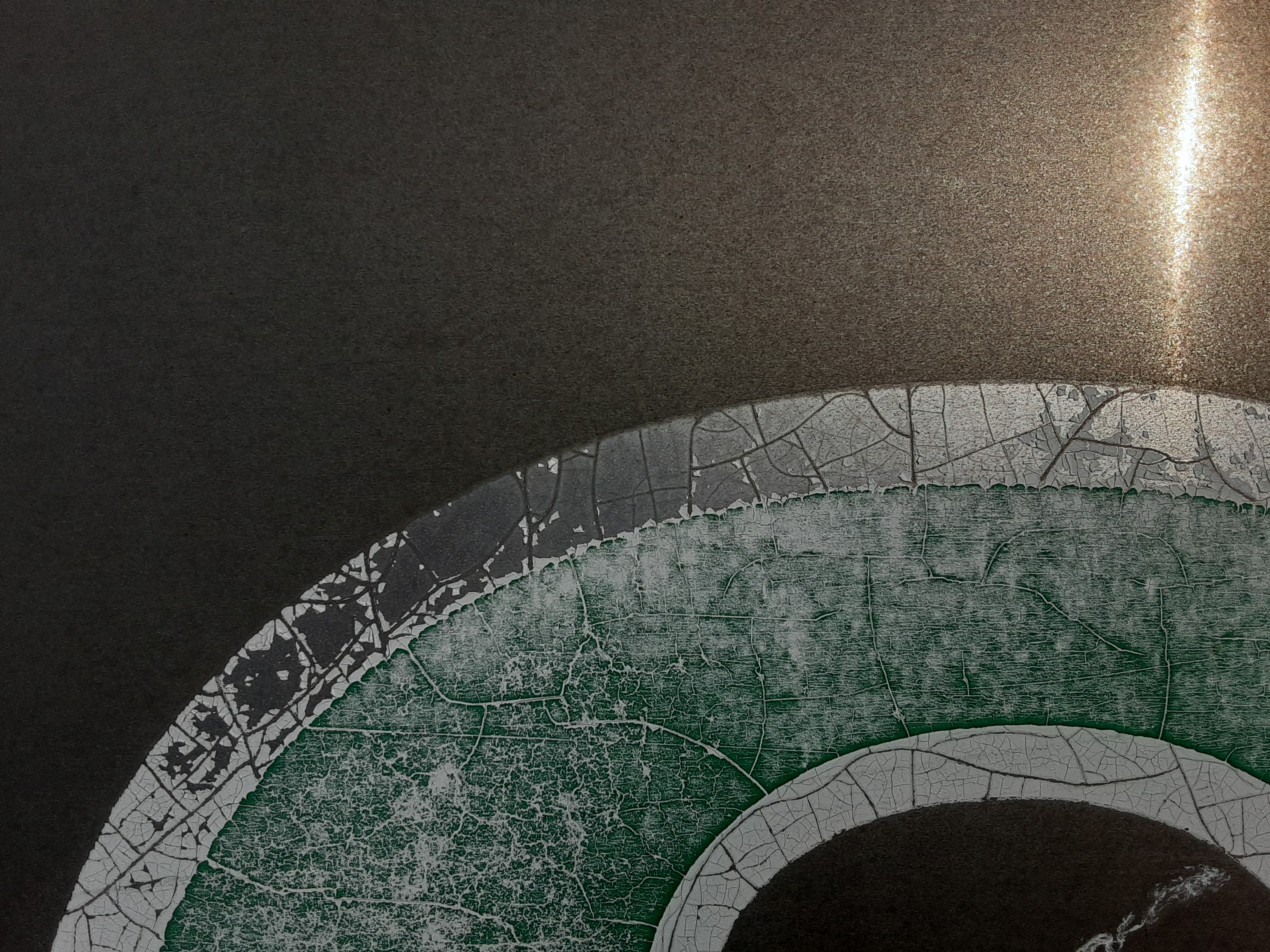

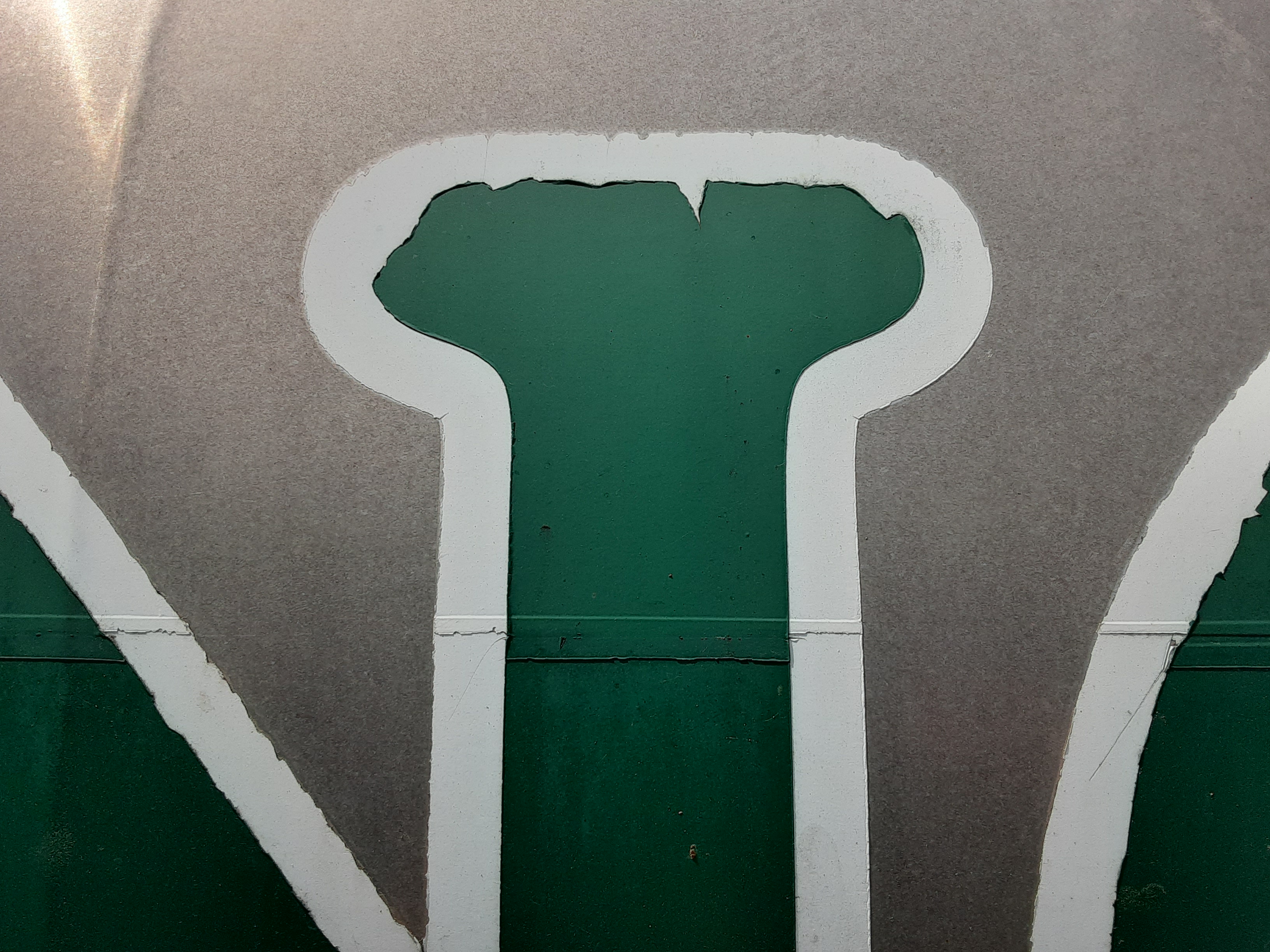

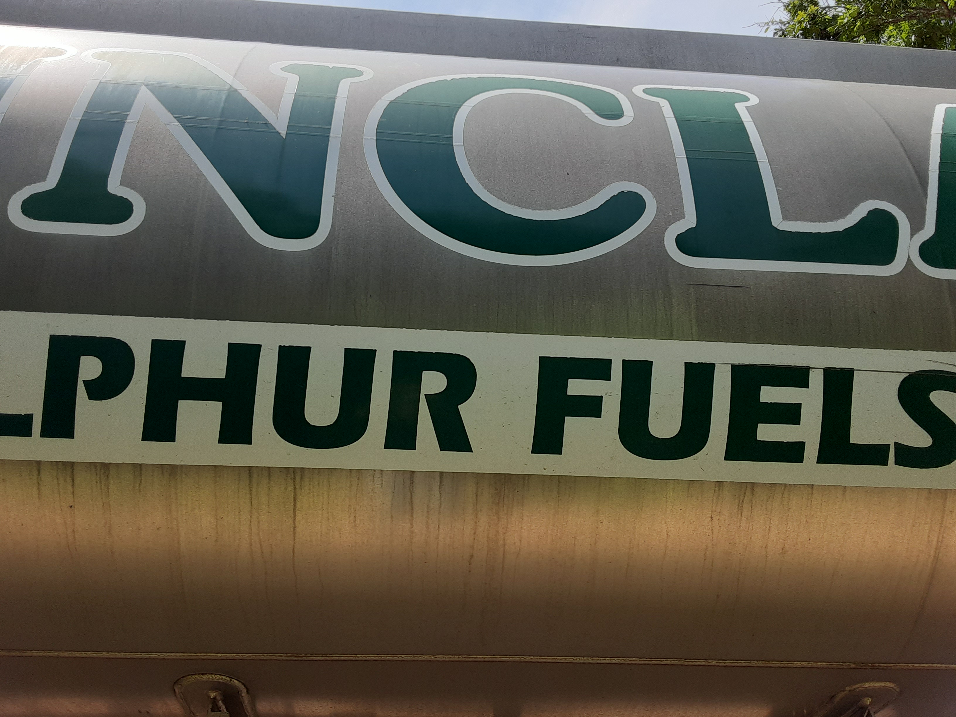

We lettered this tanker 22 years ago using Gerber 220. Customer wants it removed and replaced. Any tips on removing w/out destroying background and our hands. It's an aluminum tanker.

With really old and weathered decals as long as it not polished or painted, we brush on Paint remover until it melts off. Unfortunately this leaves solid adhesive, which we pre-spray with adhesive remover or apply more more paint remover then pressure wash off.
