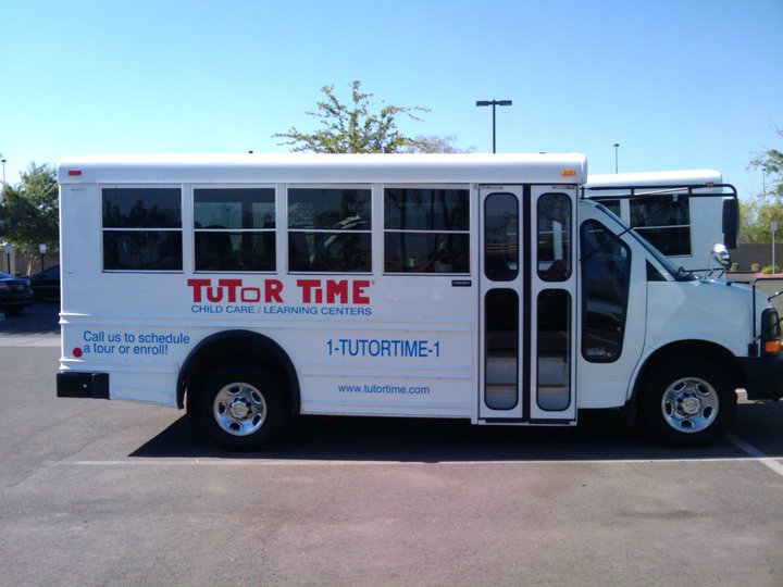

Just registered here. Thought I'd give you my 2 cents. I stripped 5 vans like in the first pic. Took me and another guy 2 12 hour days. And that was in 115 degree outdoor temps. Used blow torches and elbow grease to get the vinyl off. Then goof off (in jugs!) to get the residue off. If your 30 are anything like those 5, plan on a LONG time. The Arizona sun is not kind to vinyl.
