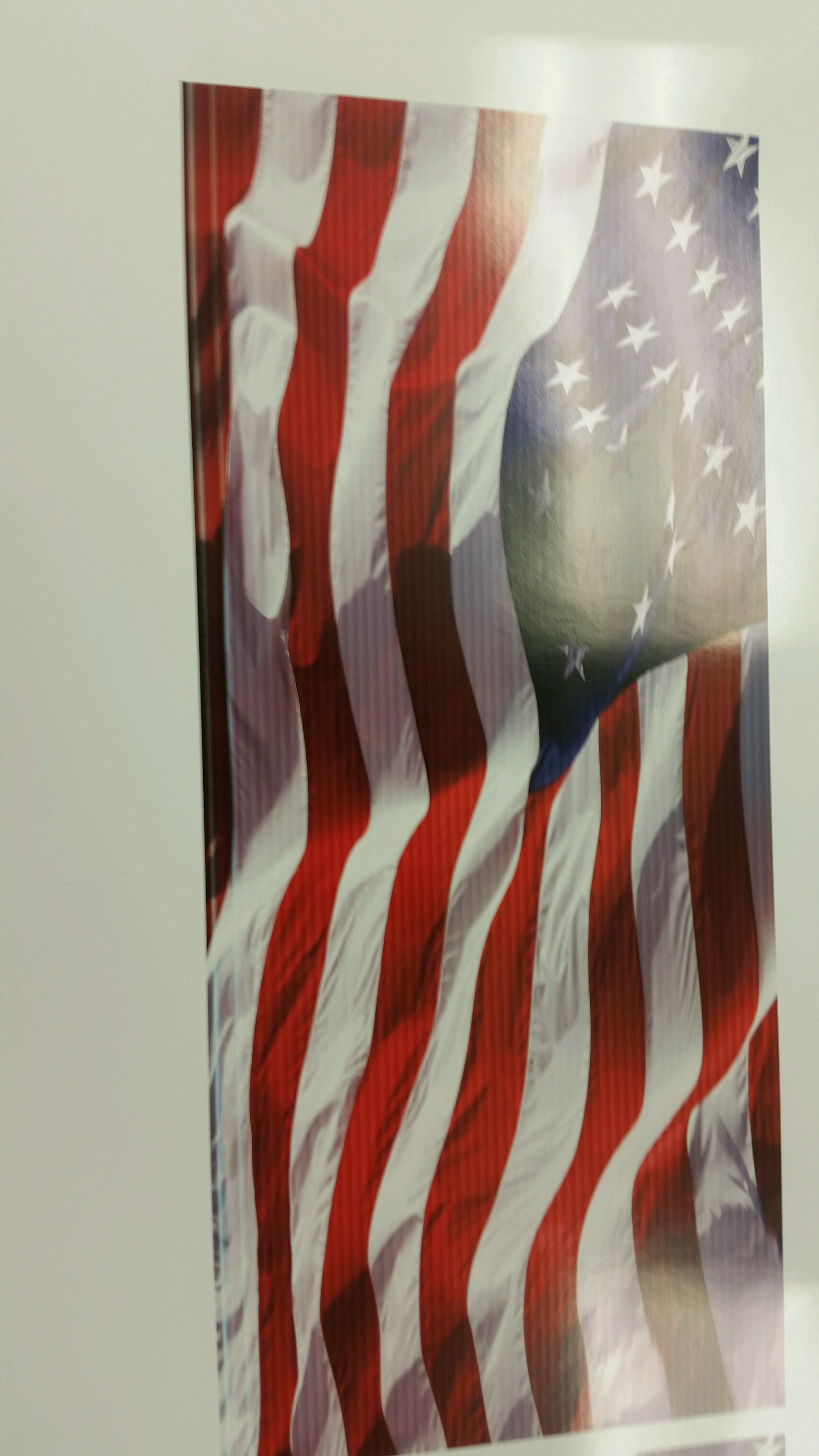

Thanks for your info. I am located in Athens, Alabama which is north Ala. 35 miles west of Huntsville. I went to the thread and read the info. I feel like I have did all that you talked about. I am new at this so I may be missing something. Just got this machine about 2 years ago. 1st year was great. Most of the problem is probably on me. I was not aware of the proper cleaning and did not do a great job cleaning the wiper. (lesson learned) After having the issues I was told that I did NOT clean it properly. Anyway, I have been fighting this battle ever since. I was told the head was clogged and was instructed what to do. So, I did several head soaks and strong cleaning, didn't work. Then I was told I would probably need a new head. So, I bought one, didn't fix my problem. Then was told could be maintenance station. So, got one, didn't fix it. Now on to new dampers and o-rings. Still didn't fix the problem.
I left the printer (on) overnight. Came in this morning and did 2 nozzle checks seemed almost perfect (both of them). Printed 2 American flags 8x18. They weren't the correct color (all most looks like a faded flag) and if you look close you can see some small lines in the print.. I did another nozzle check. Had some miss-fires.on each color
So I went in and changed the color value. Now the color looks better (brighter red and blue), but major lines/streaks.Looks like when the print began it just miss fired on the beginning lines. Did another nozzle check. Getting several miss-fires Looks terrible. Looks like all colors are miss firing most of the middle sprays.
I was hoping to solve the problem with out a lot of expense. As a school, we are always short of money. I am at the point of seeking professional help. If I wasn't already half bald, I would be pulling my hair out....................
I have added a couple pics of the flags. The darker one was the first print. Looks almost perfect. The brighter one is the second print. Notice the lines at the bottom of the flag and how they stay constant throughout the print.
Thanks again for you time and concern.

what your seeing is called banding.
you said you left the machine on. you should always leave the machine on. it does auto cleaning while idle to keep the head from getting clogged.
now your banding is either from a head issue or an encoder issue.
when you do a head test it should look like a nice grid, any deviation from this solid pattern is a head issue. missing grid lines or out of place grid lines is a problem
now your encoder is just a little disk in the side of the machine. this needs to be super clean so the sensor reads it correctly.
if you been turning your machine off. you may of clogged a few jets.
run several heavy cleanings then build 4 files 1 for each color with it at 100% for that color and 0% for the others. this will tell you which color is acting up the most.
you can build a file with all 4 colors at 100% if you just want to pump ink through the machine.
you can also set the machine to uni directional printing or bi directional to see if ether one of those will print better

Double also, banding is a generic term that can often lead to misunderstandings on what is causing it. Lines parallel the travel of the head are NOT caused by any bi-directional alignments. Without even opening the machine, simply go through the menu and print a bi-directional alignment test. It if looks fine, it is fine. Lines parallel to the print head are either ink/head quality issues, or in some cases a Step misalignment. If it was a Step issue, you would have them on every print, and never be able to get them to go away. Clearly based on your testing, this is not a step issue. It is an ink laydown issue.
Banding perpendicular to head travel, like text facing the operator that is blurry, is caused by bi-directional alignment.
