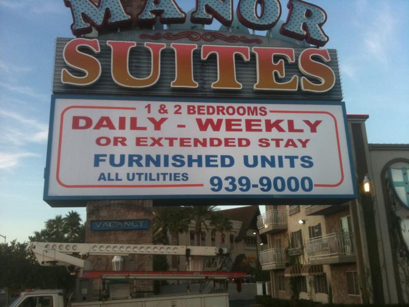

If the existing sign is Panaflex then I would replace it with the same. IT is pretty easy to change out. You can easily put your vinyl graphics onto it. Here is a pic to a 12' x 40' panaflex we changed out. Very easy, we just pull down the sign, put brackets on the new piece, and then install it. There are a few different types of brakets that are used for these installs though.

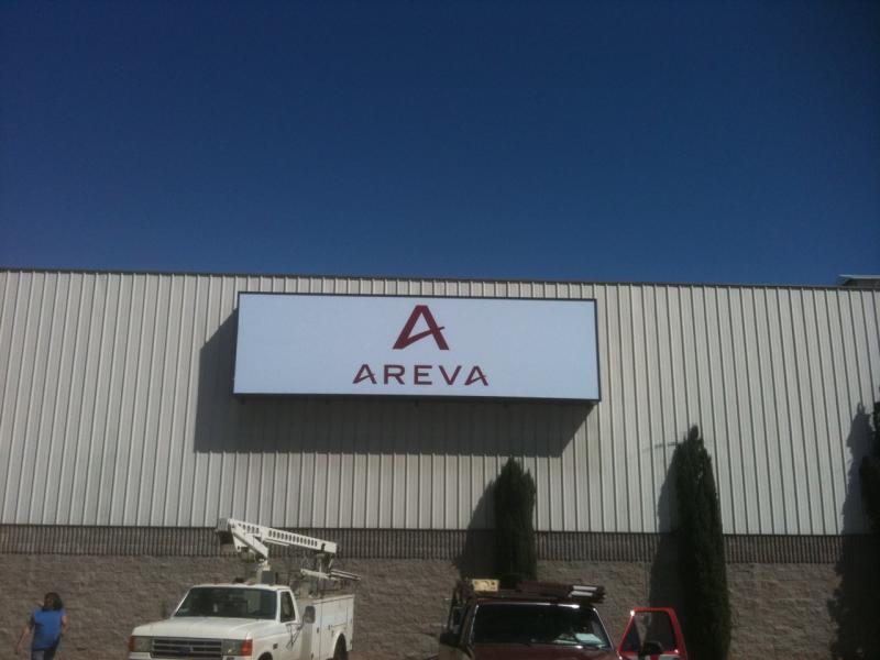

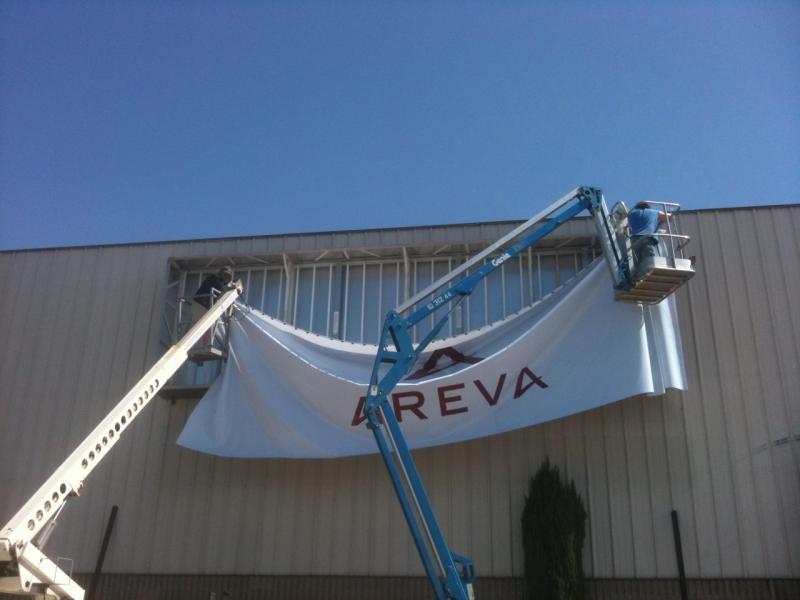

We used Cooley which we got at Montroy. I believe it is 20 oz material. It really is pretty easy. For the one in the pic it had clips attached to a nut and bolt and you vlip it on and tighten it to give it tension. I have also seen some that have a type of screw. This one has screw that went into the frame for tensioning.
