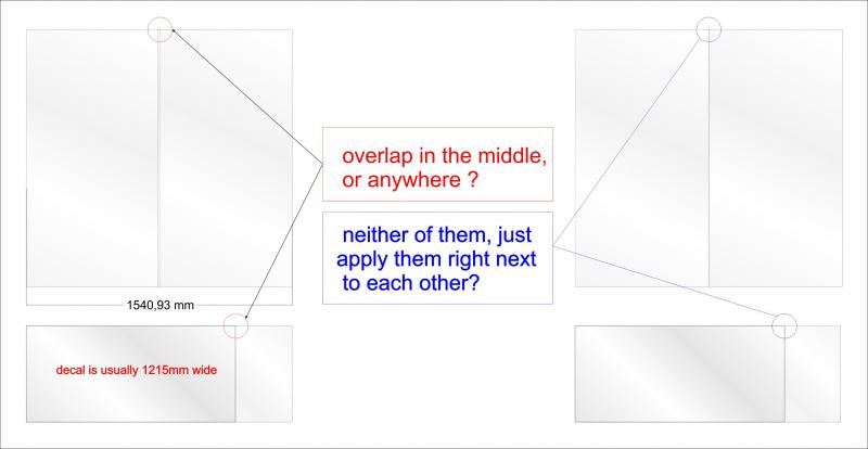

i´d like to apply sand decal to window, but unfortunately the decal is not wide enough, so i have to do it with two pieces.
i´m not sure, whether one should overlapped the other or not. it´s for outside balcony.
i´g be grateful for any tips.

you can apply the two sides with a slight overlap, then with a straight edge and a very sharp knife (and a light touch so you don't scratch the glass) cut a line down through both overlapping layers. Strip out the excess and you have a dead fit. Alas in later months the vinyl will shrink, but at least the gap is even.

the gap should be in the middle window, right?
