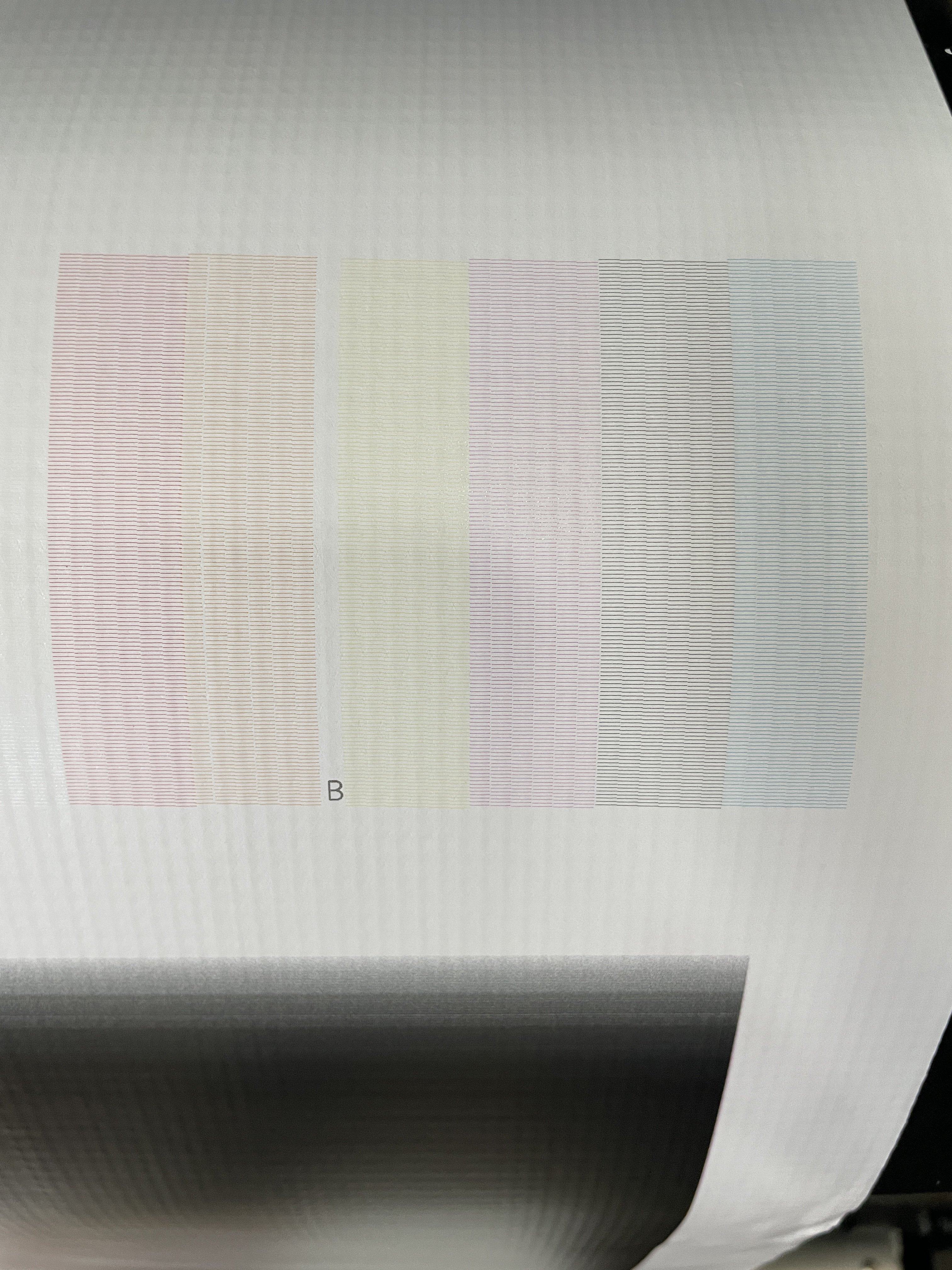

Are your 2 printhead that dirty after just one day of printing? As this would definitely give problems in the long run.
I am experiencing issues with the printer saying "no inkt." The solution (from Roland) is to switch the back plastic around the ink pouch with the black plastic casing of another color. And, unbelievable this seems to work, most of the times. But this whole inkt cassette system seems extremely iffy if you ask me. I have never had an issue with our VS, XR or VG3 with cassettes.
josephF
They are not extremely dirty no, but there is always a light misting of ink around all the print head areas where you wipe with the cleaning solution each day. The machine is just too expensive not to follow the recommended cleaning procedures. I want maximum up time for printing with the least problems I can get. So I do not mind one bit doing a manual cleaning. It takes about 2 minutes to accomplish first thing in the morning.
jlgb
josephF Thanks!
You also, ones a month, clean the glass in front of the LEDs on both sides with a alcohol wipe? Mine have largely got a bit of yellow "hue"on them from the yellow ink.
josephF
Yes I do the UV lamps once a month as well. Usually on the 1st just so I remember. I also vacuum the sheet cutting groove on that day as well. Machine needs a lot of love and care. The ink waste is a lot better since the update. I went a full week and 3 days and it was only maybe a little under a 1/4 in the jug. That is significant compared to before were it would be over 3/4 by a week.

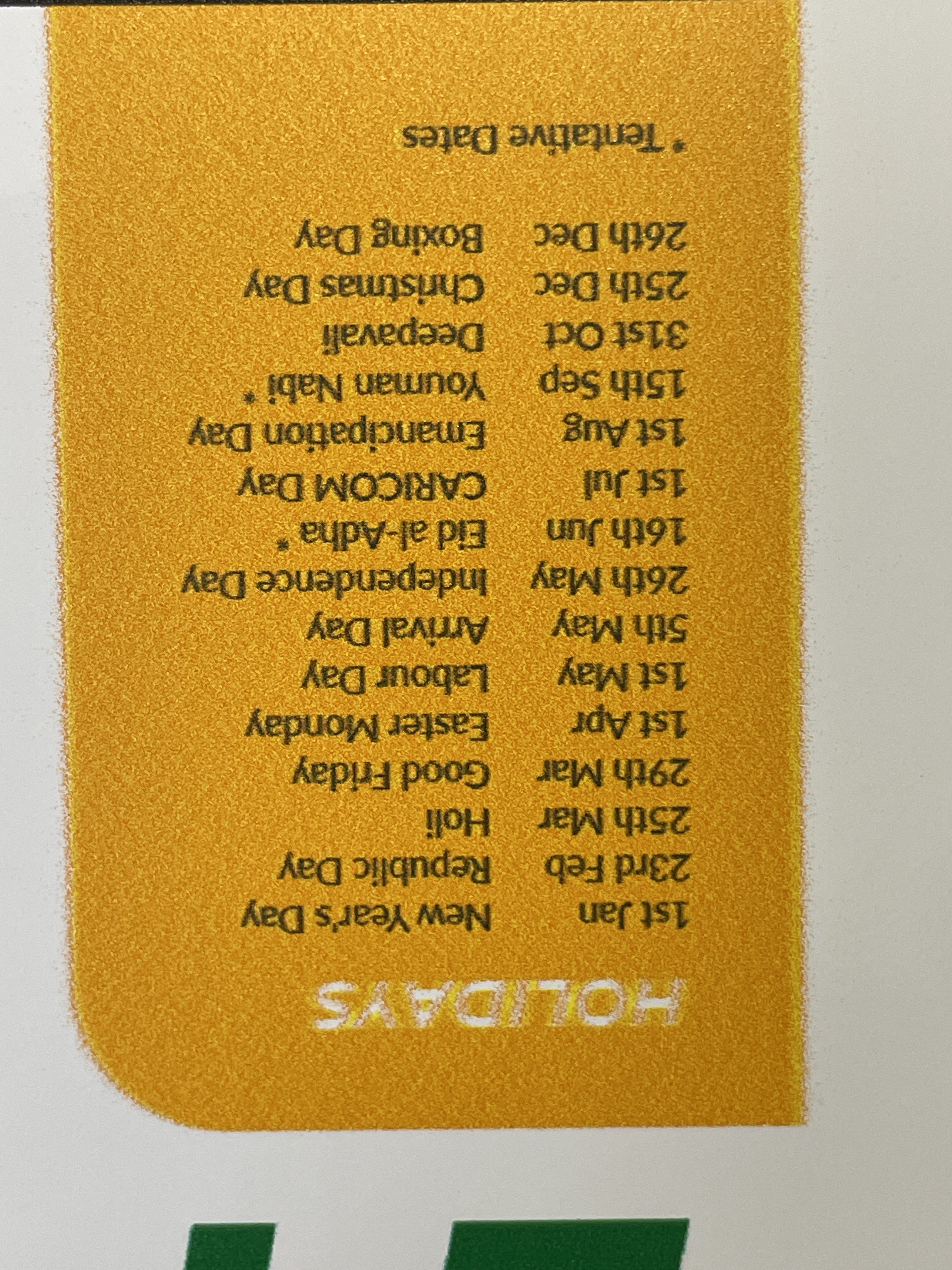

Very nice mat finished end result, very nice colours, just beautiful.
3 layer prints (colour – white - colour).
Nice for small stickers, but not really useable for cut-to-shape signage. Our application tape does not stick to this type of 3-layer print work. We use R-tape high tack 4075. You will have to laminate the film/designs first for the application tape will stick to it (which I would not advise given the very ruff/bumpy surface of a 2 and 3 layer print).
It is, at the moment, not possible to print 3 layers in one go. You print, return printer to origin when finished and you print again on top. Colour – white in the first pass and subsequently colour in the second pass.

While we’re on the topic of the Roland LG - I encountered an issue today where the orange seems to be the only color printing with a smudge. Dot dropout is fine, but the orange is a bit blurry while all the other colors are fine. Any ideas on what might be causing this and a fix?
Images attached for reference View attachment 168731 View attachment 168732 View attachment 168734
Did you ever resolve this issue?
We have the exact same problem but with red. All other colours are perfect, no dropout, no misalignment. Even the red test print is perfect, but when it prints the red is blurry.
We reported this to our dealer who has filed a report through Roland DG online. They admitted they have had similar issues with red and orange with other customers. We were advised to change to a new red cartridge then perform 2 powerful cleans but this made it worse.
Roland have asked for the expiry dates of ALL inks and when we installed them. Funnily enough, our red cartridge is well within. Only Cyan and Yellow are a couple months beyond the expiry date and were installed on the expiry month (2 months ago). Our printer is less than a year old and it seems that they are trying to wriggle out of replacing the head under warranty due to the ink expiry dates.

It seems a lot of users are having blurry red/orange prints. Looks like a big problem. This machine is not close to production ready.

An update of my situation with the blurry red UV prints.
We have been advised that the ink expiry date is critical. We received new ink from our supplier, installed it, performed ink renewal, and now it prints perfectly.
Roland have shortened the expiry dates on ECO UV Red and Magenta to 10 months, and Cyan and Orange to 13 months from the date of manufacture. You can work out the date of manufacture from the serial # on the cartridge. The first four digits correspond to the date
Example: 3429G96245
3 = Last digit of the year so 2023
4 = Month so April (number 1-9 are Jan to Sep. A-C are Oct to Dec)
29 = Day of production
The serial # above gives a production date of April 29th 2023
It sounds obvious, but DO NOT run expired inks in these printers. We normally keep 1 spare of every colour on the shelf, but not anymore. We'll be ordering just in time from now on.
