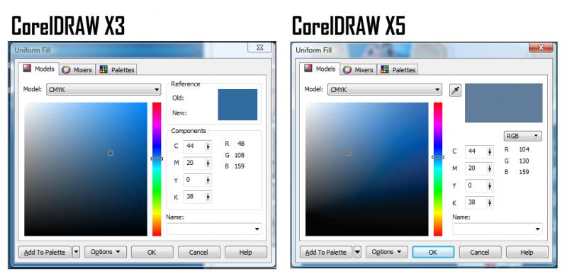

A lot of times I use RGB colors. I have noticed that when I open files that were created in X3 up in X5 the colors are wrong. And I don't think it is color profiles, it is the colors themselves:
As you can see, the cmyk codes are the same, but the rgb is different. This is the exact same file opened in both X3 and X5, no changes have been made to the file. What can I do to resolve this? Because if there isn't a solution, than that means A. I have to manually go in and change the colors in the file, which could take hours in some cases, or B. I simply use X3 every time I need to work on files that weren't created in X5... which at this point in time is nearly all of them.

NO, I know it isn't, but why would that change the actual RGB numerical values? For example: in X3 a color is R:48 G:108 B:159 but that same color opened in X5 is R:104 G:130 B:159 I can understand it changing how the colors appear on my screen or how they print, if I were to print these particular jobs, but why would the actual color values change? And what can I do to prevent it from doing so?

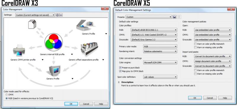

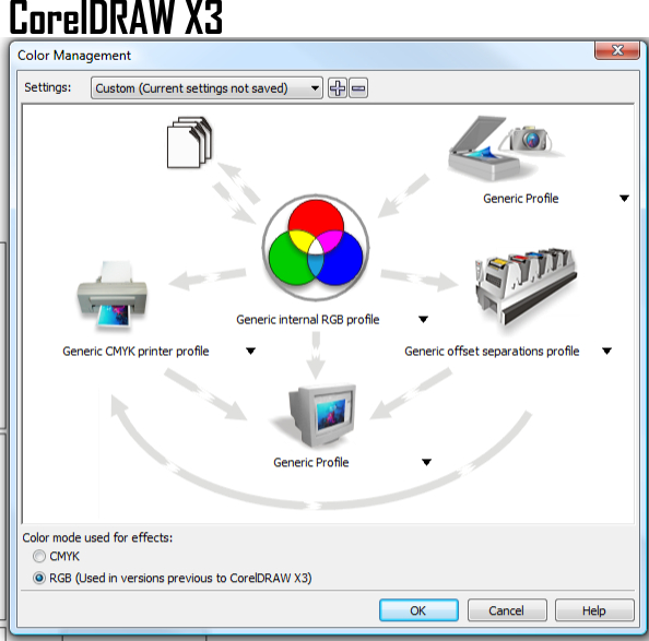

Here is the color management setup I use for web design in X3 compared to the color management I now have setup in X5.
If it is related to Color Management, what can I do to have X5's match my setup from X3? Or more importantly what can I change in X5 so that it doesn't change those RGB values when I open files I designed in X3 in to the newer X5? As you can see they have completely changed the color management settings in X5.

Look at your COREL x5 settings where it defines how RGB files are handled on the right hand side. It says it is for import and paste to Convert to Document Color for RGB. I know you're opening, and the settings look appropriate for that. But I'm just seeing something that may be playing a role.
Try turning on all the warning/notification check boxes then open your old x3 file and see what it says.
joeshaul
Wow, didn't know Corel changed their color management settings that much. On X5, see if you have an option under Color Engine for Kodak, I believe that was X3's default engine.
rfulford
Two other things you could try....
Set your X5 "Color Management Policies" for opening files to discard/ignore or whatever similar option you have here.
Or.... Export your X3 color settings and see if you can import them into X5
