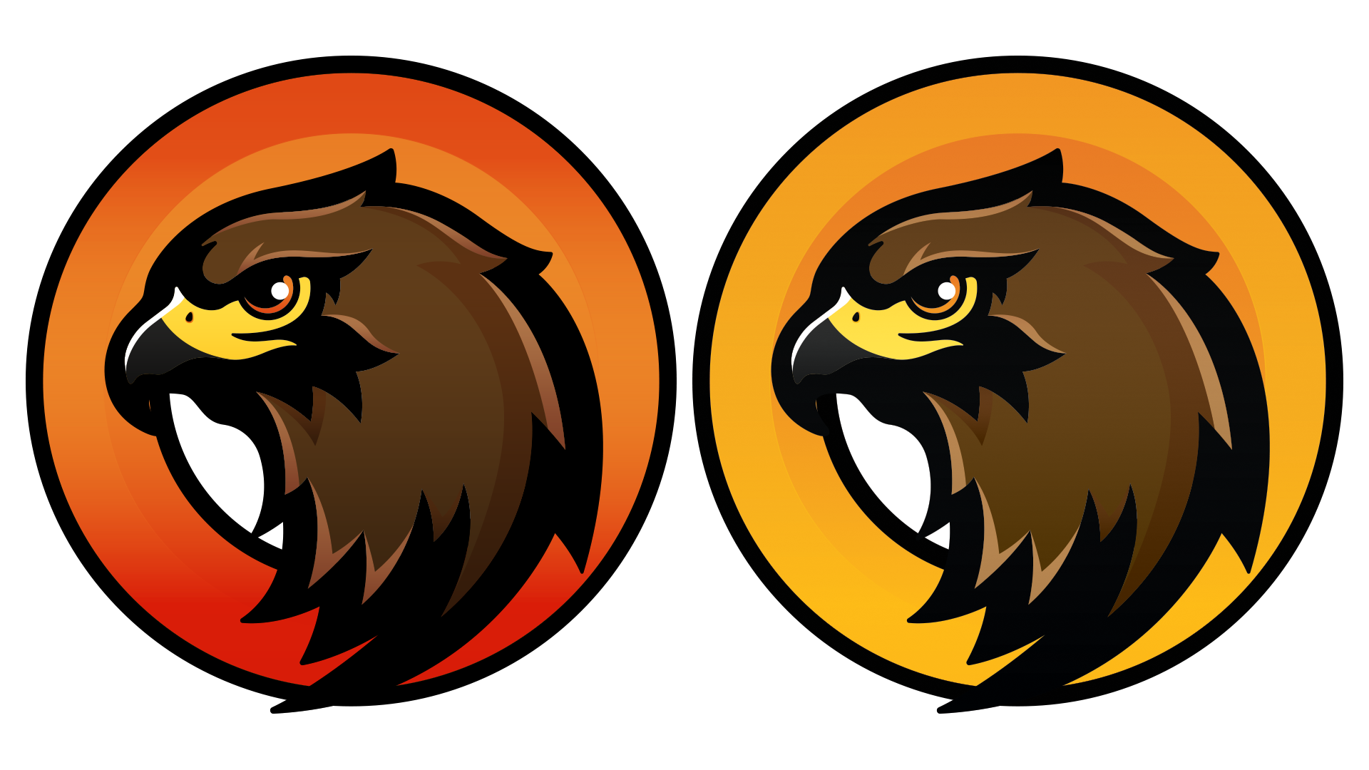

I attached an image to this post showing the difference from a RGB client file (lettering removed) with the art in RGB color space and one of the things that happens when it is collapsed to CMYK. The left falcon image is the intended RGB design. The one on the right shows what happens when it is changed to CMYK. A bunch of things just break.
So that I'm clear, you're saying the supplied RGB image becomes brighter (the image on the right side) when converted to CMYK? What do you mean exactly when you say "collapsed" to CMYK?

I'm using the term "collapsed" because the color appearances in the RGB-based artwork shift very dramatically when converted to CMYK. The conversion method doesn't really matter either. You still get wildly unpredictable results. So the only thing we can do is feed the artwork into the RIP at a RGB file and hope the RIP doesn't make the colors too off the ball wacky when it does its own conversion. The situation is every bit as bad as someone using Pantone spot colors in fills with transparency effects. They just shouldn't do that stupid stuff in the first place.
I think the term "collapsed" would describe something that goes down. Are you sure to say the colors on the right side image become brighter, as in "up," when converted from RGB on the left side to CMYK on the right side? Or is it the other way around?
In any case, it's just a simple color management issue is all. On my end, the image doesn't change at all when I convert using the proper output ICC profiles for a modern large format printer.
For anyone to submit a CMYK print file for accurate expectations, they would need the actual CMYK output ICC profile of the machine which will print the file. CMYK files are device dependent. Available from some printer manufacturers are wide gamut CMYK working spaces which is roughly equivalent to the common RGB working spaces. So, the proper working spaces and proper output profiles are necessary.

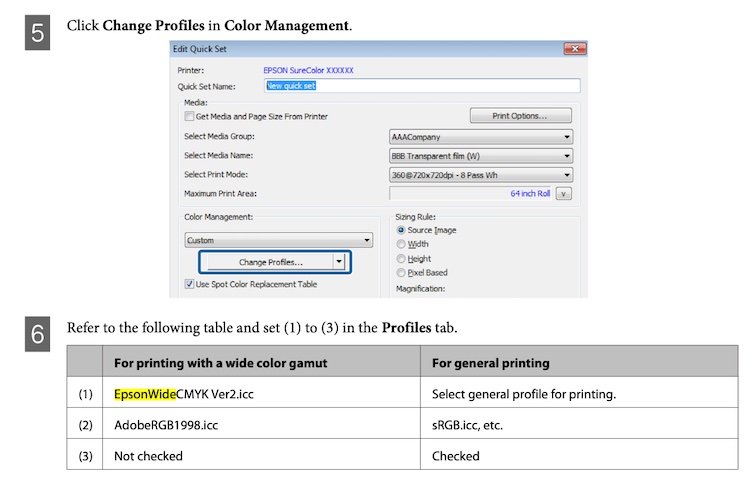

Bobby, if you're using an Epson S80600 (or any printer with more than 4 colors) - you should be printing RGB files. RGB has a wider color gamut, and your printer has more than just CMYK - you've got 9 colors. You will get much better color printing an RGB file.

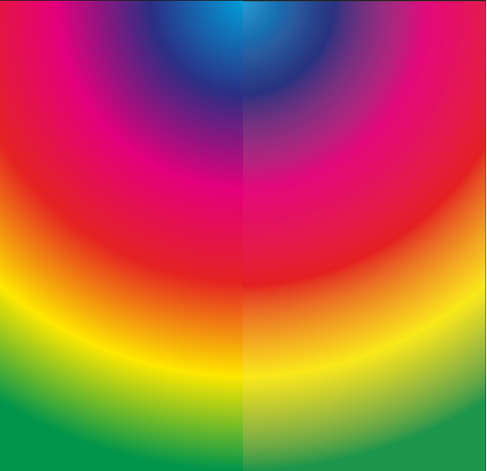

RGB on the left, CMYK on the right; it may not be the most obvious evidence, but you are missing out on a lot of good saturation in all primaries.

The colors in the RGB artwork have a wider gamut range than the CMYK result. A bunch of the more fiery, deeper colors disappear. That's why I used the word "collapsed." I really don't care what term is used.

It's an artwork issue. Again, just within the Adobe Illustrator environment I can copy the RGB artwork from an RGB document and then paste it into another Illustrator document that is CMYK. The colors shift dramatically. Hell, just ungrouping the Falcon element causes a bunch of color shifting within the native RGB document.
Whoever designed the artwork stacked multiple copies of grayscale gradient objects with different transparency effects applied. The artwork is set up so if it goes outside a RGB-based Illustrator file the colors just get screwed up. They could have achieved the same colors just using conventional fills without all the transparency mumbo jumbo. RGB to CMYK conversions would yield much more predictable results.
Topping it off, some of the colors in the RGB artwork are well outside the gamut range limits of CMYK.

We have a couple HP Latex printers that have 6 ink colors. Due to the nature of the artwork we have no choice but to create RGB PDF files of this artwork for Onyx to process.

The artwork was created using Adobe Illustrator. The designer just built up his collection of school logos all in RGB color space and went nuts with the transparency overlay effects. The problem is a bunch of those transparency blending modes work differently between RGB and CMYK color models.
One thing that makes the artwork difficult to edit, convert to CMYK or export to other formats is the lack of organization. It would be one thing if they used effects such as opacity masks -something that shows up being what it is in the Appearance panel. In this case the designer merely applied effects to individual objects or groups as he went. The design process might have gone faster, but the end result is a house of cards.
