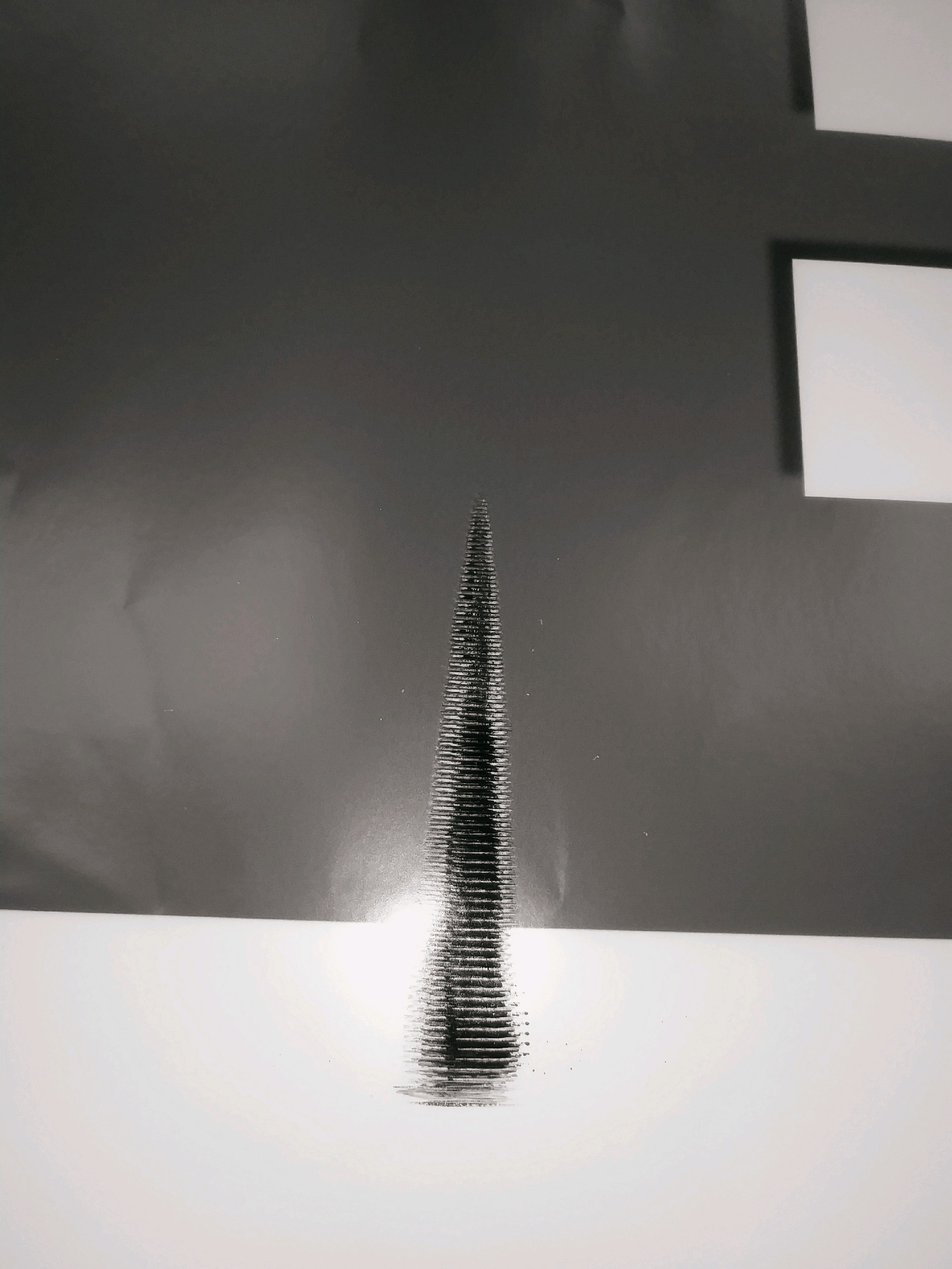

when we switch to general formulations 201OAP-54 after printing a few feet,, i develop a ridge (the material lifts in the center)
not much most of the time but once in a while i don't watch and flatten it out between prints and get something like this
(carriage striking the vinyl, or scraping more precisely ) printing on my roland sc545-ex

I sometimes get stuff like this if temperature and humidity changes for example cold during the night and then warming up during the day or the other way around. Also using GF vinyl but Orafol seems to be more susceptible to this for me.
To fix I unwind a few feet of the vinyl before printing and advance medial a few feet if it sits loaded for more than a few minutes before printing.

If I have that problem on my Roland, before printing I set press basepoint and advance 2 to 3 feet of vinyl out the front of the printer and print. The weight of the vinyl on the front end keeps the vinyl tight.
If it still happens I advance a few feet out of the back of the printer too and that usually fixes the "Waves" while printing....
