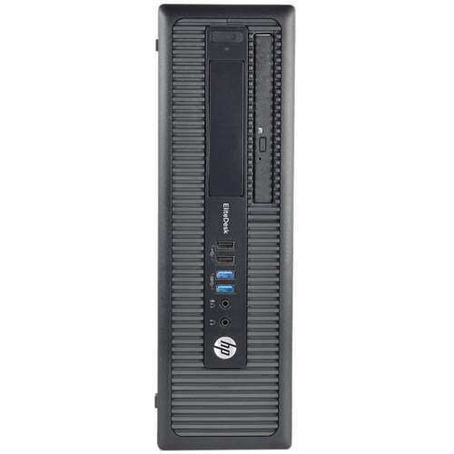

No He II no.. dont blow money on building a flippin PC. That is very wastefull.
I have an HP Elite Desk SFF these are cheap and perfectly fine for a RIP Computer.
It uses the DP video connector. Buy a DP (Display Port) cable The Samsungs dont come with

There all done and you just saved a crapton of money and your monitor just synched up perfectly with Windows thanks to the little HP puter.
The photo is a i7. I absolutely Love it as much as I do my Macs

Yep Has the USB 3 (blue) I was even thinking about getting one of the little ones that mount on the back of the monitor.
I use Flexi Subscript and the SFF will run any of the Rips. I have one file that has a a massive amount of gradient fills,
and it takes forever to rip. It is a huuuuge file from the client. Its the on;ly fill that has issues Mac or PC what I call hateful.

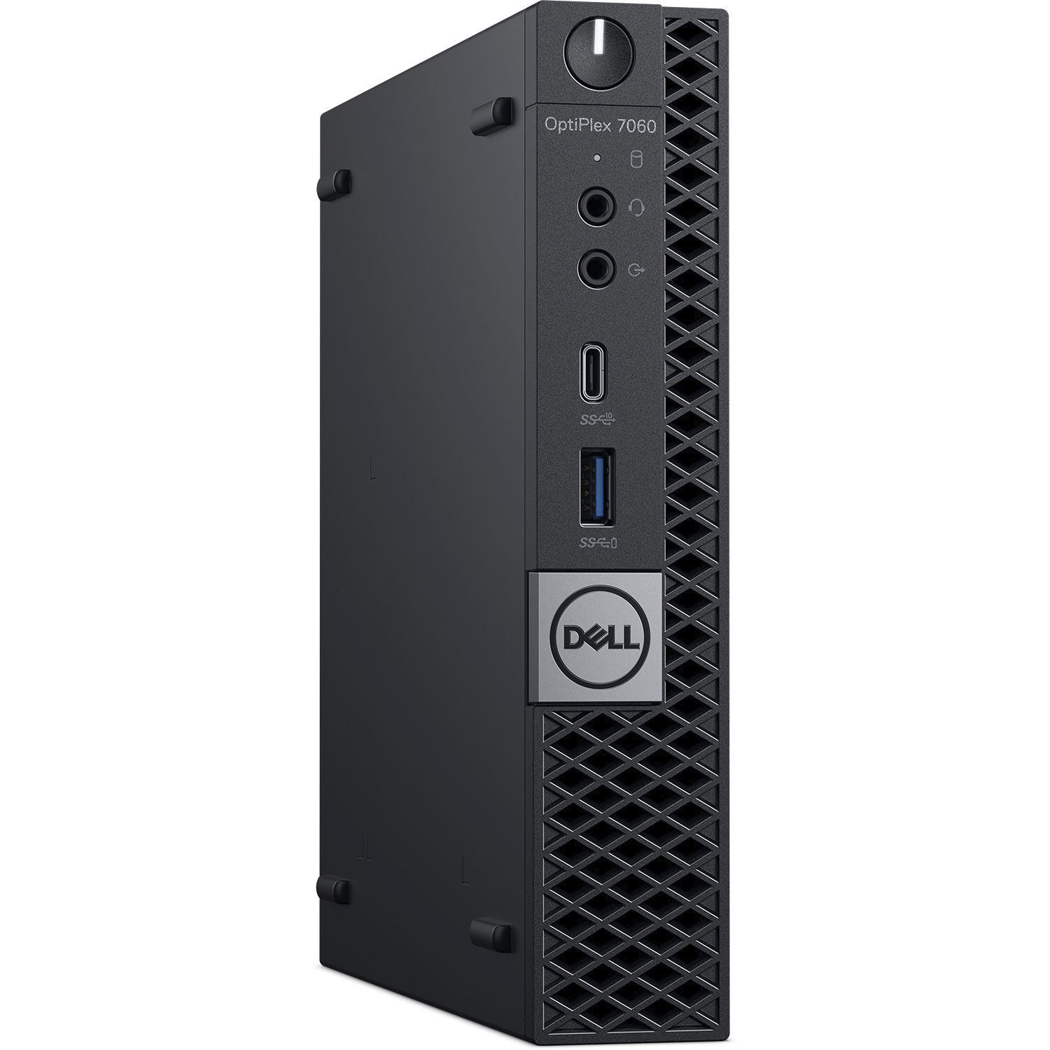

Karst41,
I am a little skeptical anout the micro form factor if that's what you mean
No options to upgrade, no expansion slots.
If the rip is actually workingbhard, no air flow to cool the cpu, ram, ssd & those sub minature capacitors (the compnent that normally goes bad when you haveva mother board failure)
Also, ram is either SOLDERED IN, or there are 2 slots and almost no option to increase, ALL THE DISADVANTAGES of a notebook/laptop and none of the advantages

Karst41,
preciate the intelk on the micro.
The SFF i7 Ive been using 5 or 6 years now and not one issue at all When I bought it I bought the ram upgrade.
But I have yet to install a SSD in it and temped to buy another one to run Graphtec Studio Pro to drive two 8600-75's
