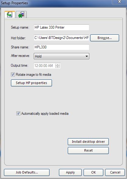

I would setup a hot folder (setup>setup properties>hot folder) and then drag or copy all the files into it. Then RIP maybe 5-10 at a time.
