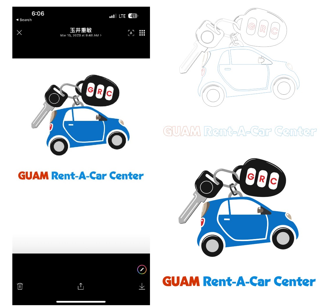

A customer sent me what looks like a phone screen cap of a logo - the cropped logo center part was less than 800 x 800 pixels.
Dropped it here:
vectorizer.ai
It converted so fast that I thought it wasn't working.

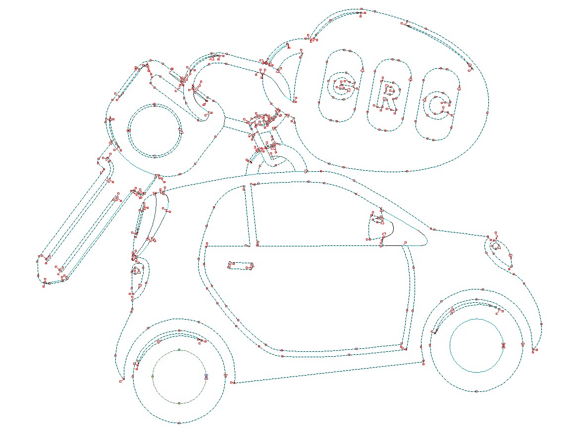

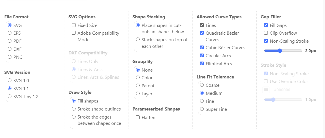

49 objects - 1020 nodes including the text. It outlined everything and I deleted the extra paths with the 'find same' tool. I might have missed the 'don't outline' option in the converter.
Still struggles with text but there is no path editing of the graphic.
