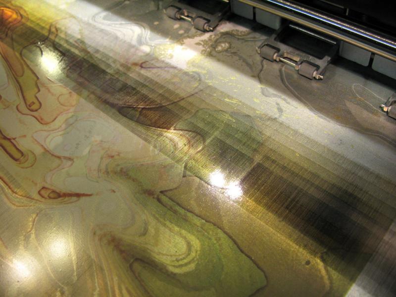

also, anytime you get gibberish (especially long or short bars of a single color), that is a sign of a data issue, long streaks that end intermittently is usually a fried print head. my printer was very periodically printing little 1x2 rectangles for weeks before it nuts. the diagnosis was a loose data ribbon at the black head. so that's a heads up if you see that kind of issue. check for ink leaks into ribbon inlets, loose data cables, and bent over data cable leads). when checking completely power down your machine as if you were changing a head.
i attached a pic of the ribbon issue when it went nuts.
