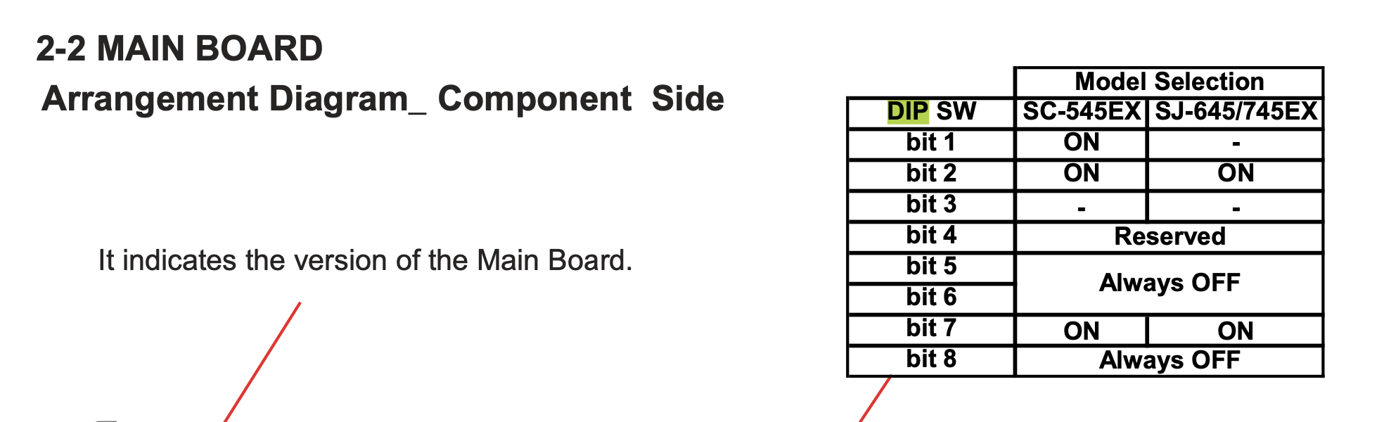

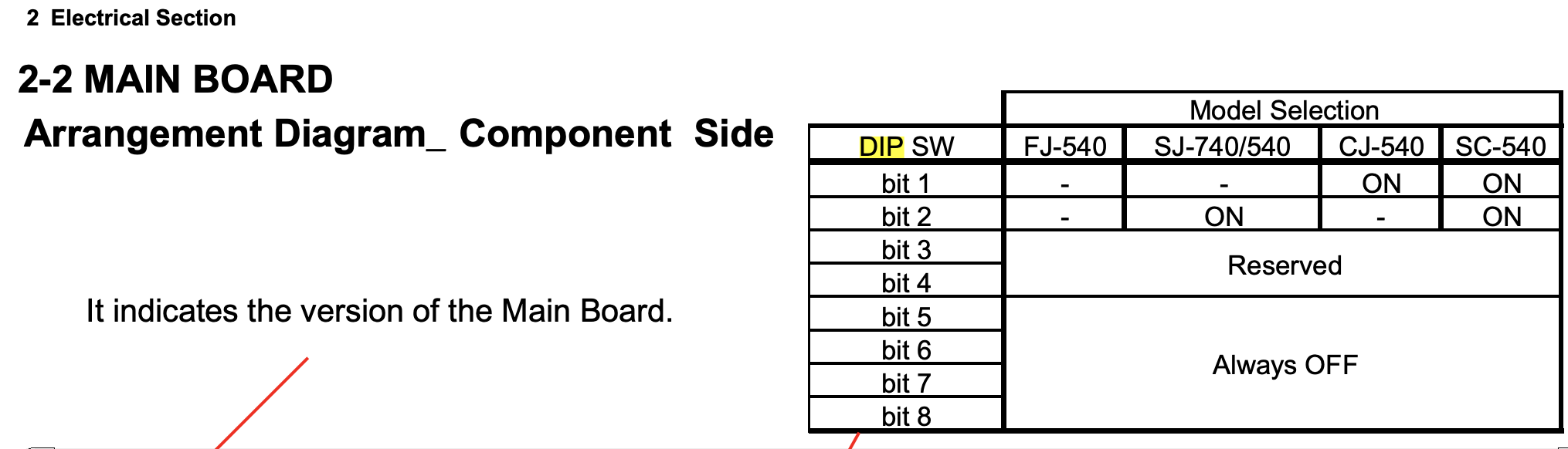

I suspect this might not be possible at end-user level. While the main boards look identical, there are dip-switches on the it that need to be set to the SC-540 profile (easy enough), but I think the firmware loaded on the board only accommodates for a few models, depending on the firmware. So on your machine you can only switch between your model and the SJ-645/745EX machines. See attached pic. Change at your own risk ...
