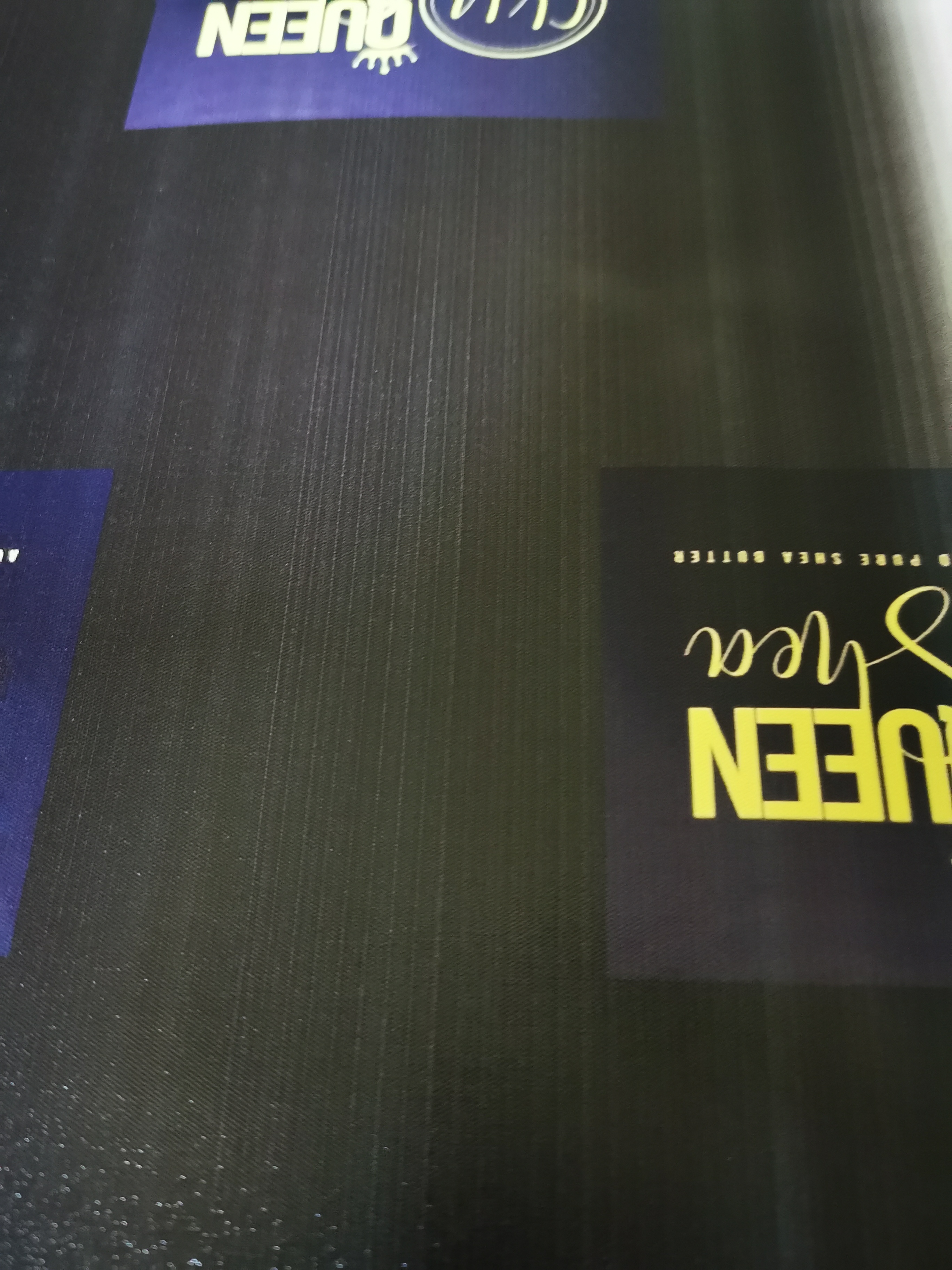

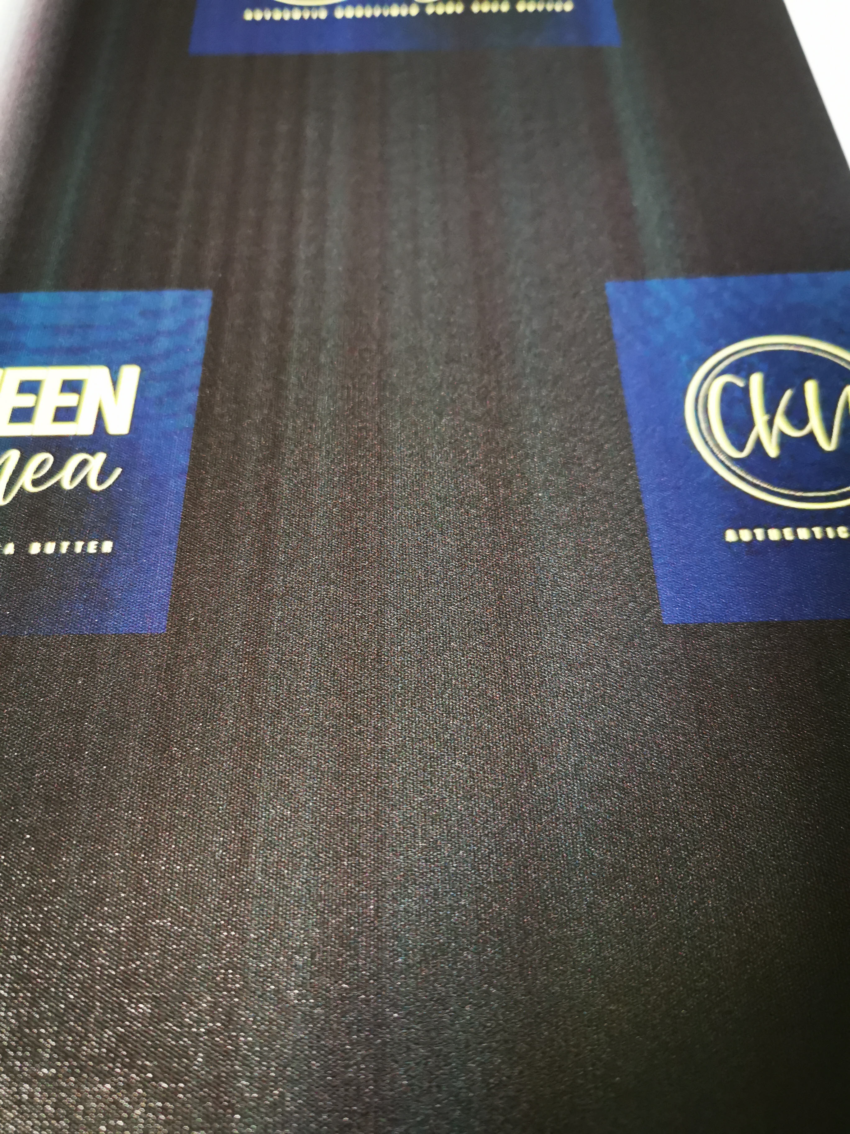

I have a Roland vg2 640 using tr2 inks. I'm trying to print a black background on a canvas/polyester material however i keep getting lines. Nozzle check is fine, I have done a detailed calibration test, gap adjustment test both of which are fine. Slowed the head down, added 0.5 second (scan interval I think it was) and nothing is working, I've been speaking with Roland for over a week who don't seem to have a clue what it is and I'm getting sooo frustrated! Wasting so much media and ink its making me mad. I have attached photos. Id also like to add that when I do a smaller test print around 30cm it's ok?

This may be a mute point but did you try to print using a different profile or resolution?

Try a different type of media.
If it prints good on Gloss or Matte finish vinyl, it could be Static, Temperature or even the head height.

I've tried it on a normal vinyl and it was fine? I've changed temperature will give head height a go. Thanks

I wonder if you are losing a bunch of black nozzles at the very top or bottom of the head and thus a test print looks fine but in fact, is not. That will cause this banding.
