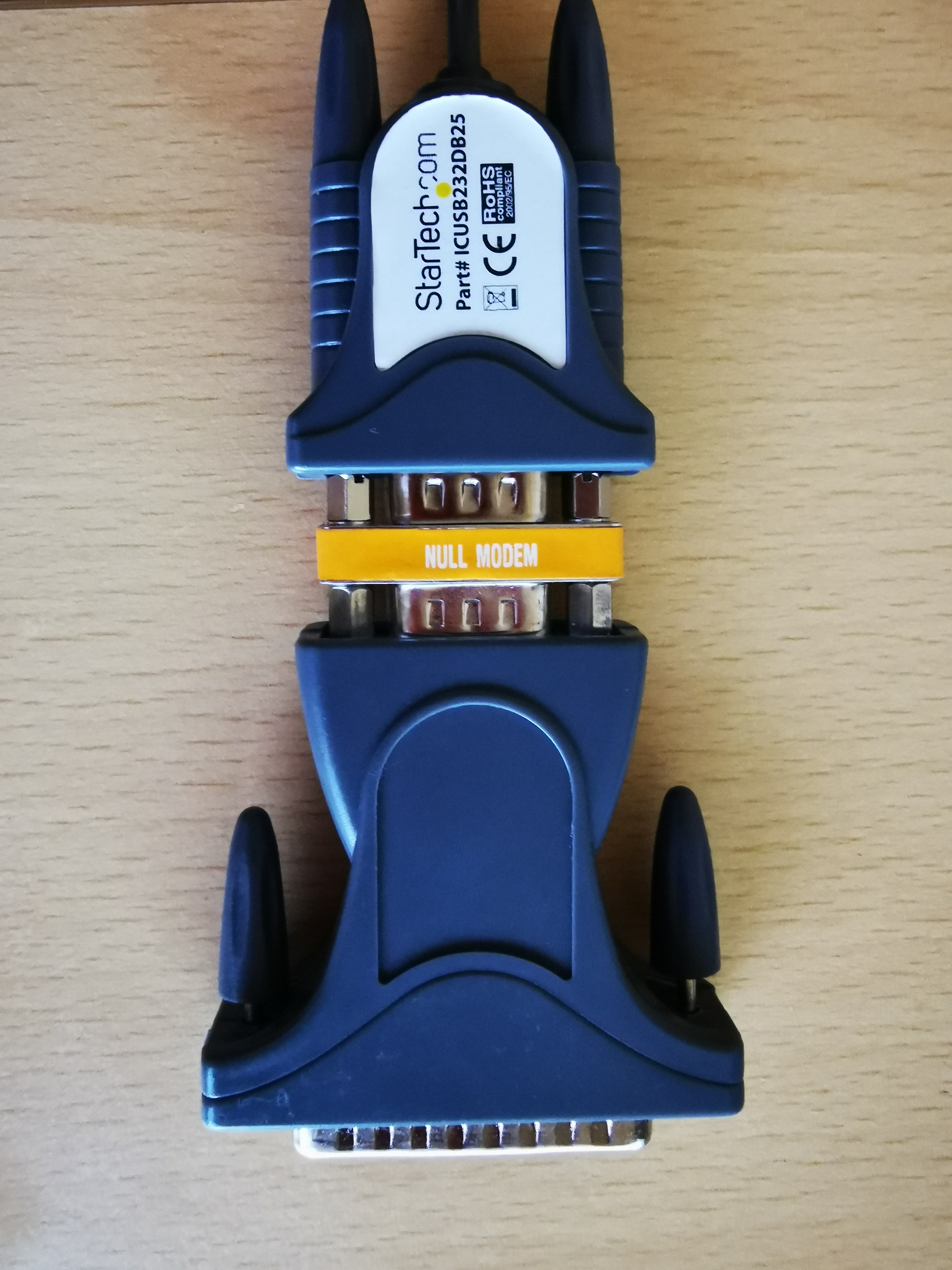

USB-Serial with null modem cable works fine.

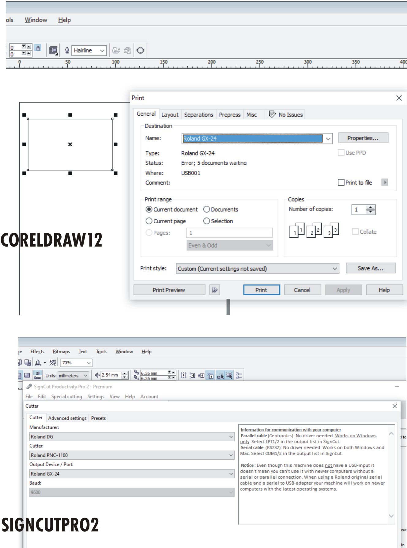

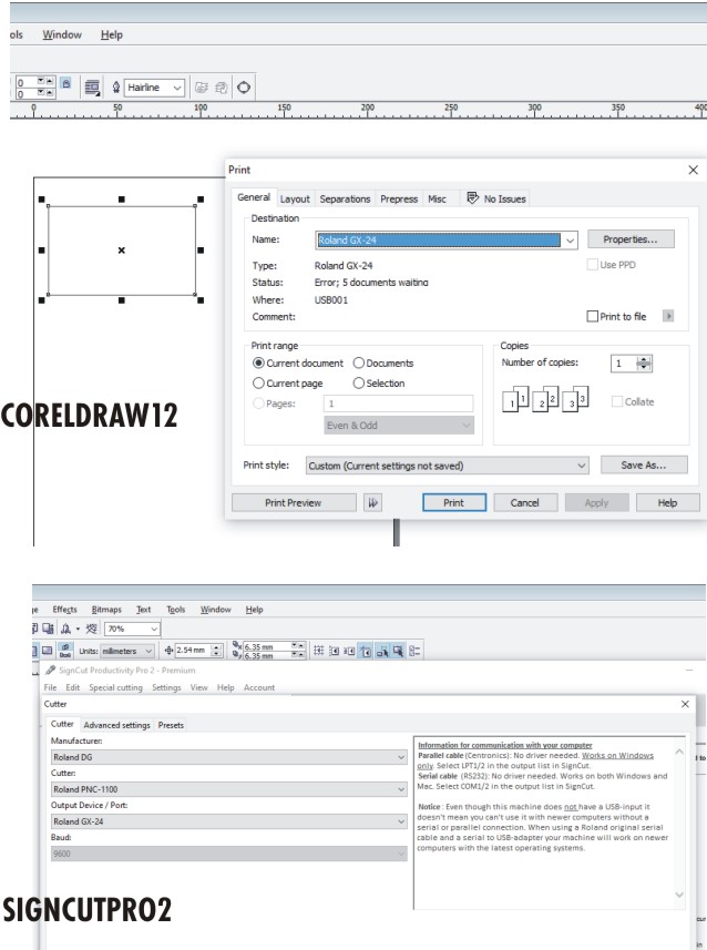

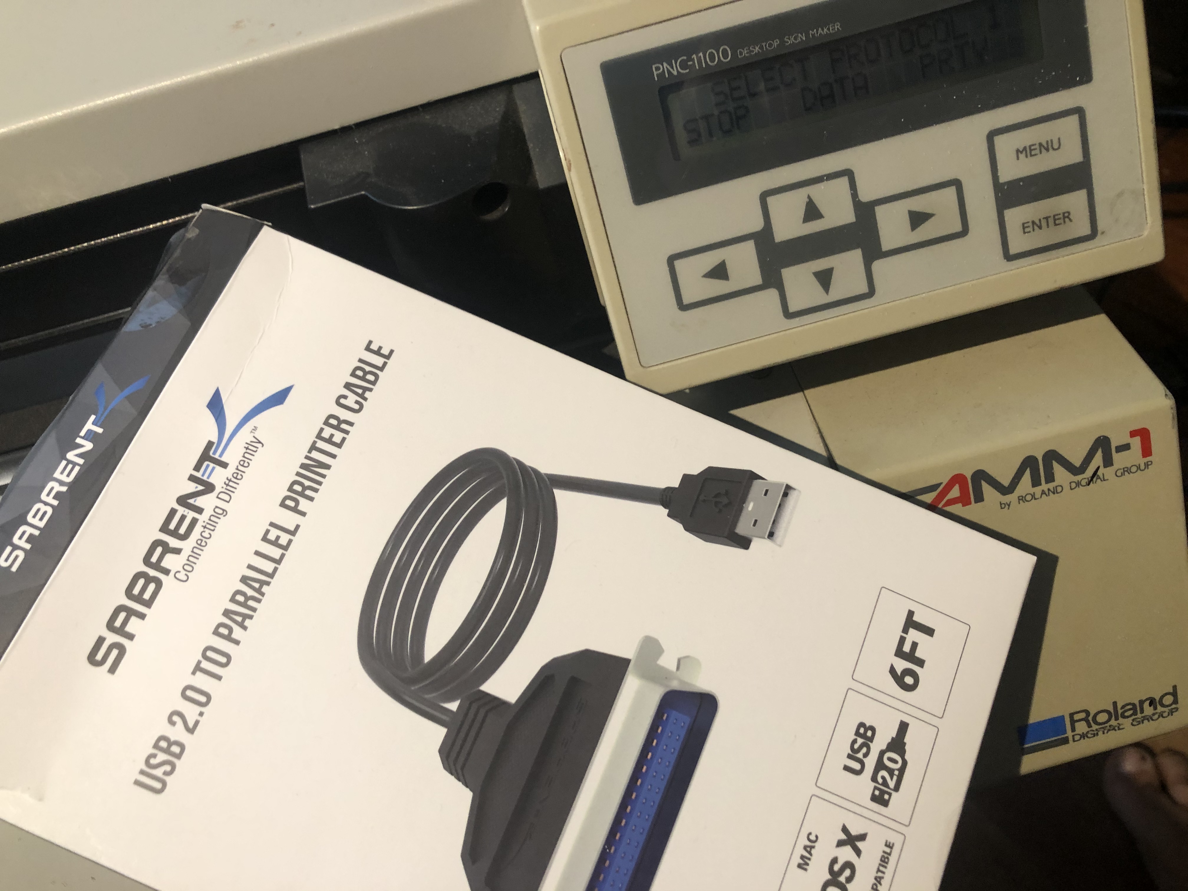

Thank you. I ordered a USB-Serial with null modem cable and downloaded signcutpro2. Installed GX 24 driver, selected pnc1100 from the cutter list but printer does not show up on printer list when trying to print using current cable adapters to usb. Do you know what brand of cable you bought? Thank you again.

attila is correct, not all usb parallel adapters work properly

On SignCut Select RolandUSB as port or USB001, ... 03 depends what port are you using . On the Cutter select I/O to Auto. And select COMMAND to Mode2. You can access the communication settings while the rollers are lifted up.
My solution for Serial cable here:

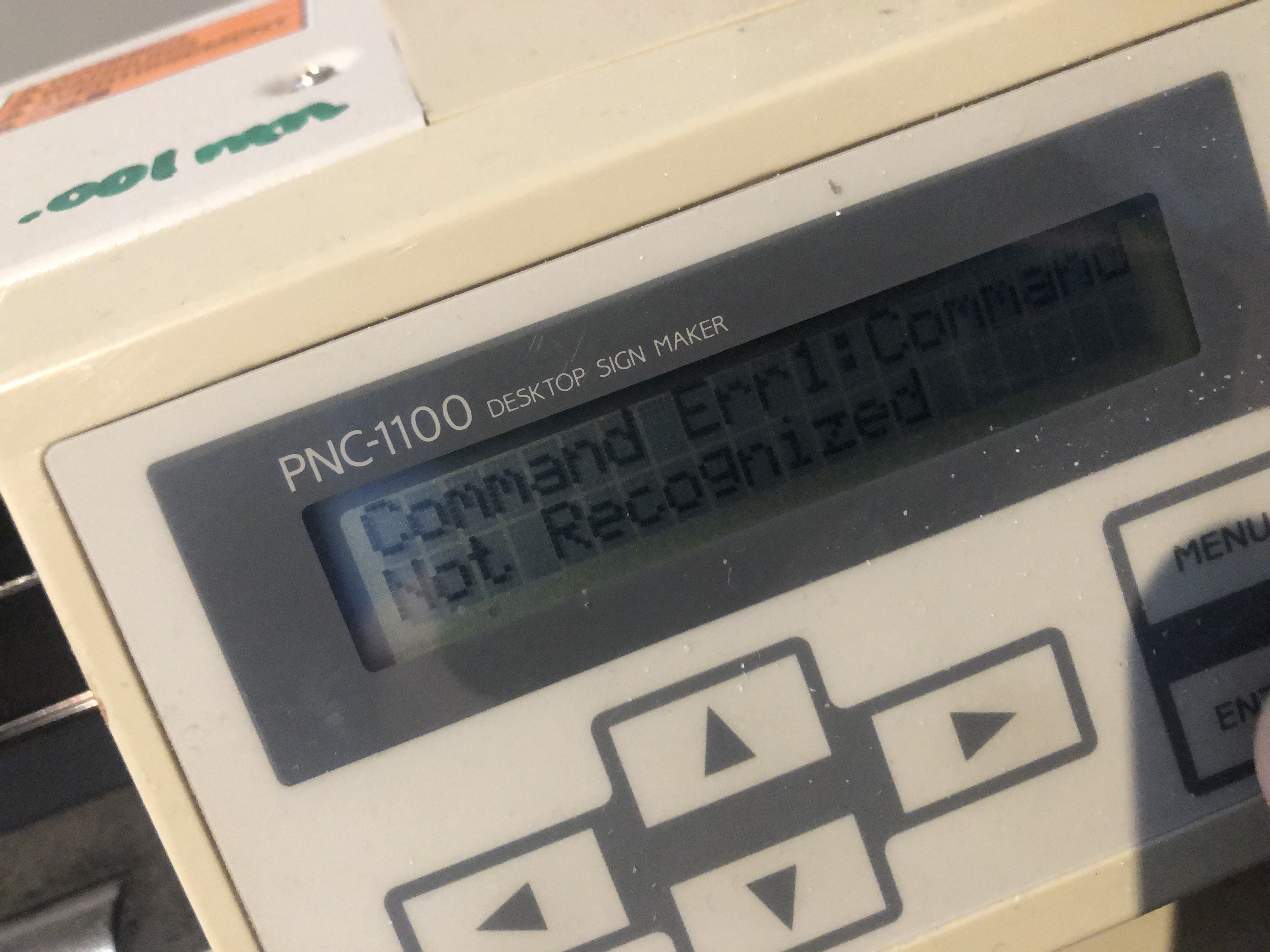

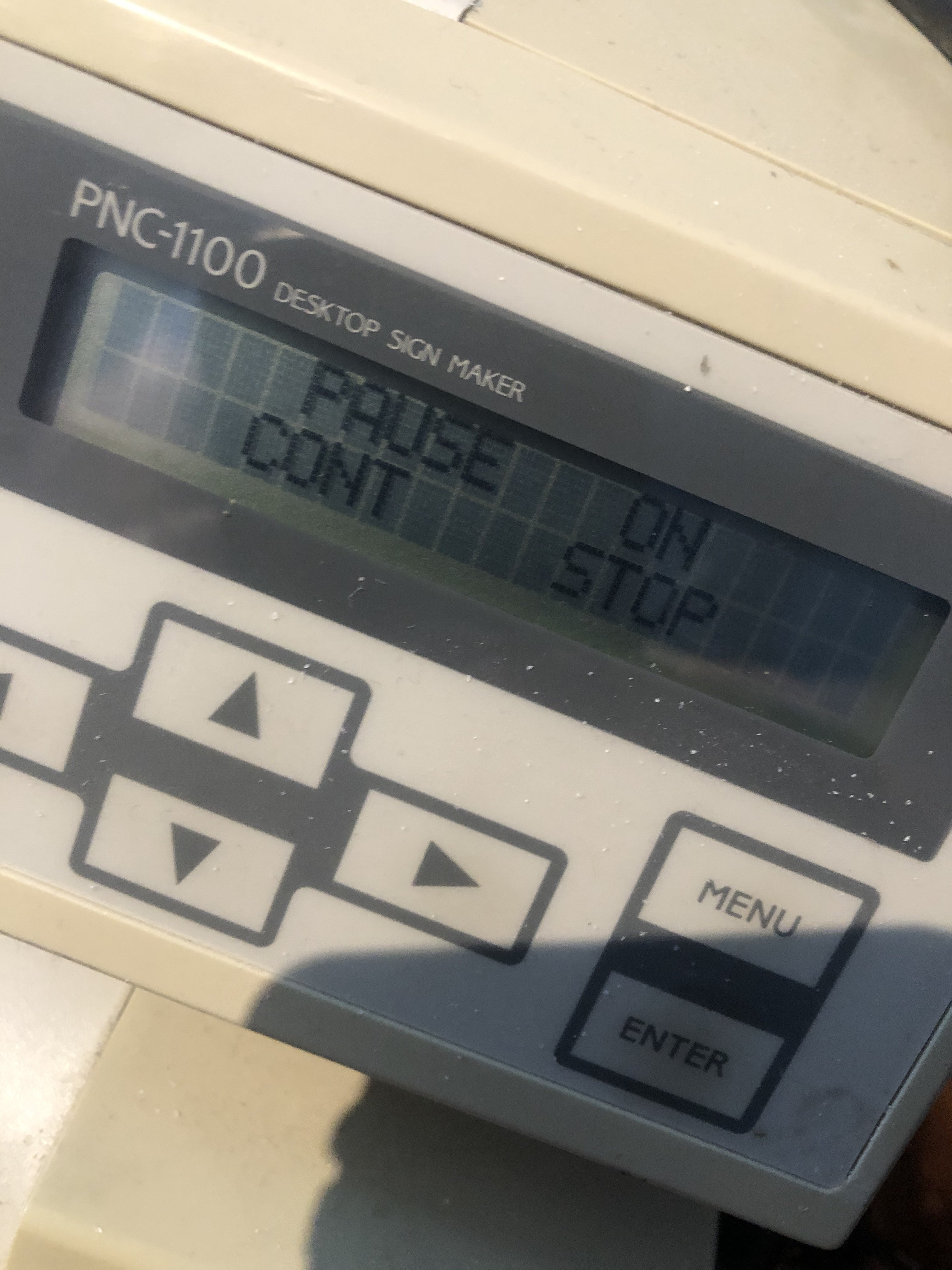

I don't give up that easy :). I tried a simple box in coreldraw and in signcut. After I changed i/o to auto and set command to mode2.

Sorry this image should be better. Thank you again Attila.

For SignCut Do not select the Device Driver. Select the USB00x port. You have the command not recognised message it is a good Sign. It means you have communication.
