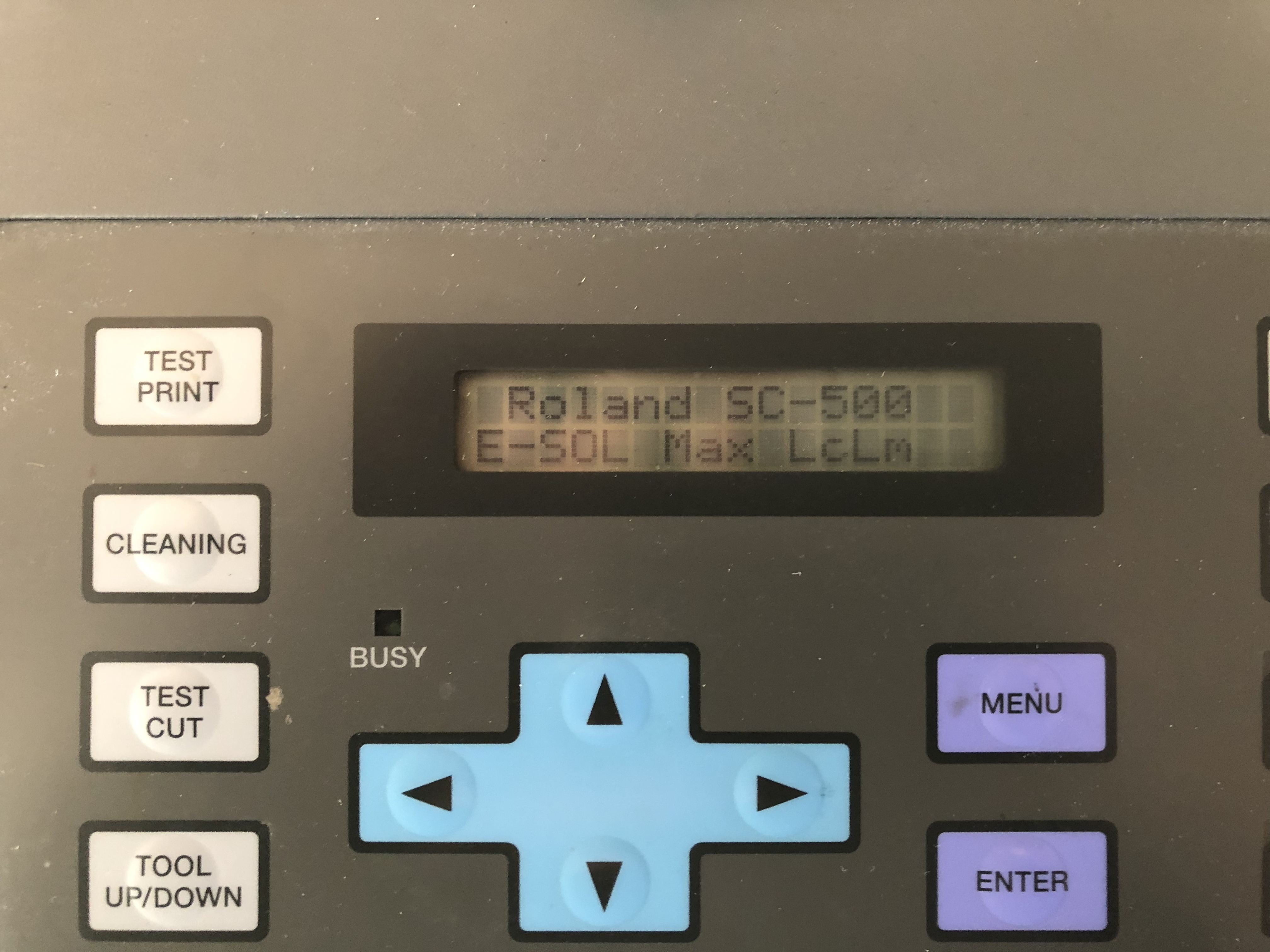

I have just bought a used CJ-500 which in the display says E-sol MAX when booting up. Does this mean it´s been converted to run on Eco Solvent ink rather than Aqueous ink?
I was thinking of doing the conversion myself. But if it already has been done then that would just be great. :)
I´m not entirely sure though, but maybe someone can tell me if I might have gotten lucky. :)

Shure that is a Cammjet CJ-500 and not a Soljet SC-500? Haven't seen a CJ-500 prepared for eco-sol-ink.
Much more important than what the printer says is: is there a media heater integrated in that printer? If not, it will be useless to convert the printer to eco-solvent, because without a media heater the ink will not work with uncoated media.

It says CJ-500 on the label on the back. So I would think it is a CJ-500 And the front of the machine also says CammJet, the Display says SC-500 when it boots though.
IN-WondeR
Just pulled the outfeed front of the machine, I don´t think there´s a heater there... Not sure how it would look.
