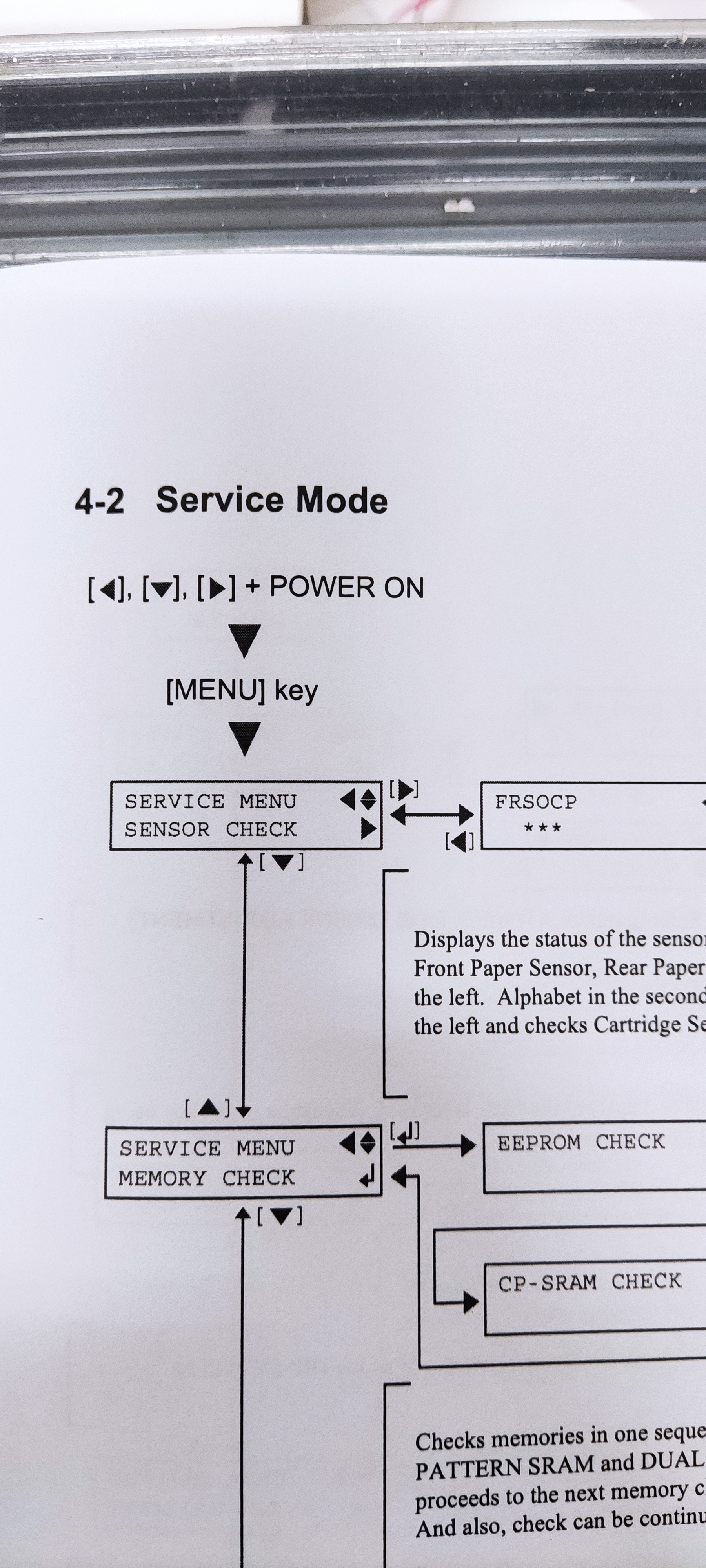

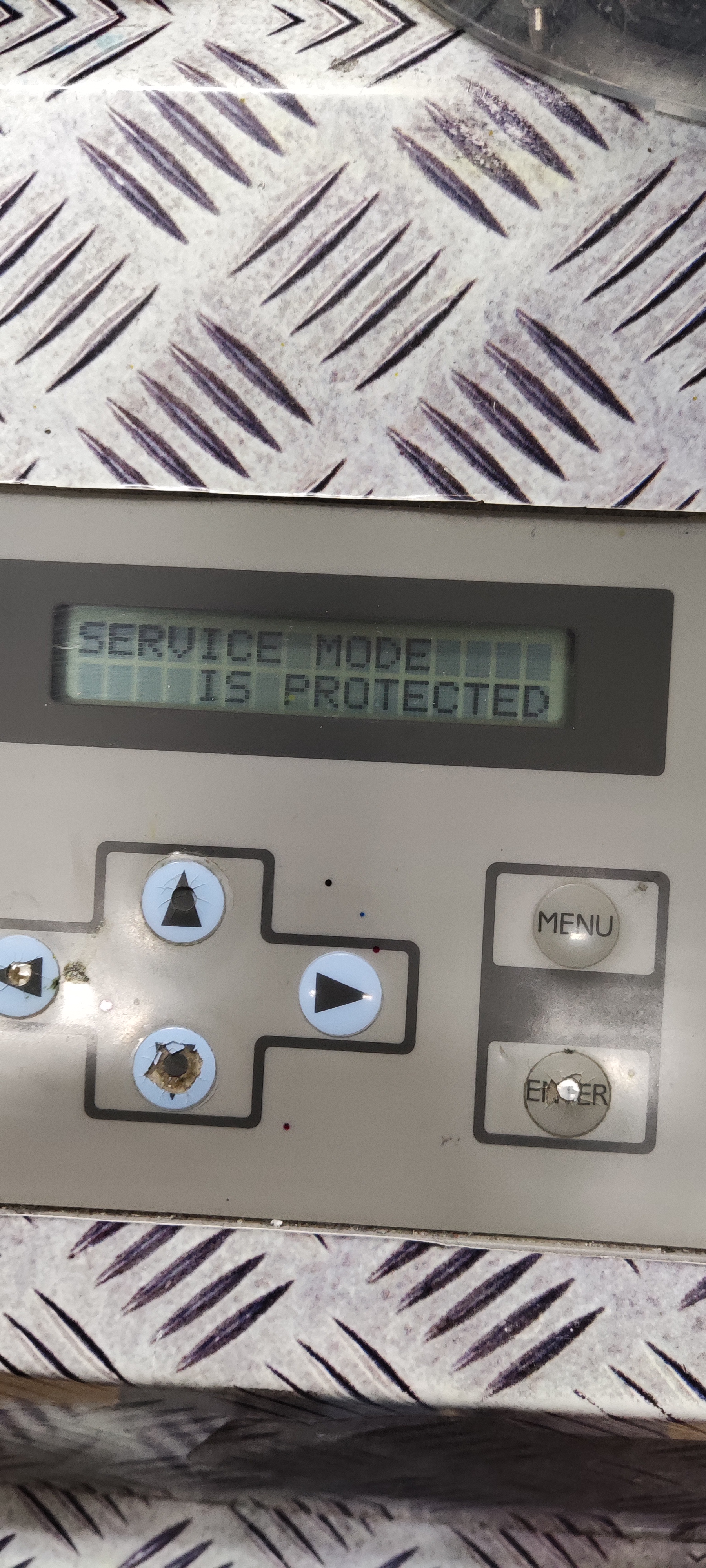

Hello everyone I have a big problem! I can't get into service mode on my Roland FJ50. I perform the key combination as reported in the Service Manual but nothing happens. The plotter gives me the error: service mode is protected. I attach a photo of the manual and error. Thanks for your help. regards Luca.

Are you doing it with the subpower off ? it should be plugged in and turned on at the wall, but not turned on from the front panel. Press the 3 direction keys together then while holding them press the power button on and it should work

Yes, the secondary power supply is turned off. Then with the three keys pressed. I turn on. It gives me an error anyway.

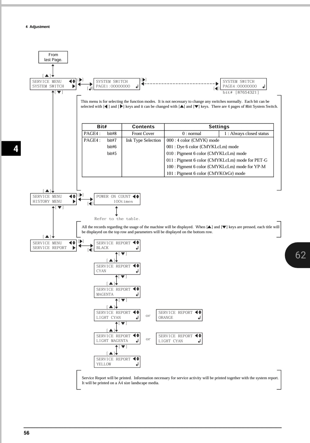

Do I need to follow this procedure to set up the 4-color CMYK printer? I was wrong. I reset the eeprom. Now it doesn't print well anymore. Dull and striped colours. I lost all settings.
