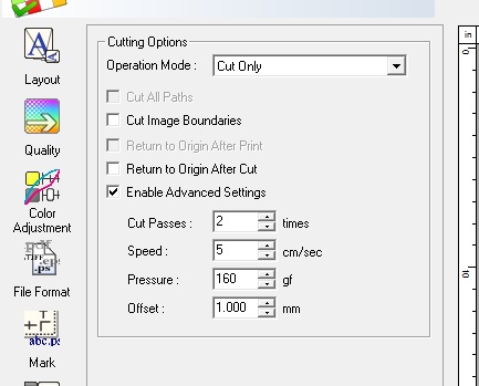

Running a 2 pass test right now on a full kit , It was either try or do a full refund for this customer
Here are my settings as of now , crossing my fingers ! Will post results

Cutting multiple passes lines up perfect ( I run kits this way to not beat the crap out of my machine), especially if you're not trying to run 5 foot files at the printers maximum working thickness... :omg:

GAC05 Never tried to pause between cut passes. I use 3 passes total to lessen the wear & tear on my machine and have zero registration issues.

Yep both are the same size , I'm set to 25.5 currently.
I'm cutting 3 passes now at 165 , will post back

Little better , at least I can sell this section ! 98% of it cut perfect and the other 2% hardly cut at all. I have to finish it with my olfa blade.
As of now my settings still remain 165 @ 3 passes , speed of 5 .
No more testing as I am out of lamination , hopefully soon I will get this setup and running smoothly.
mpn

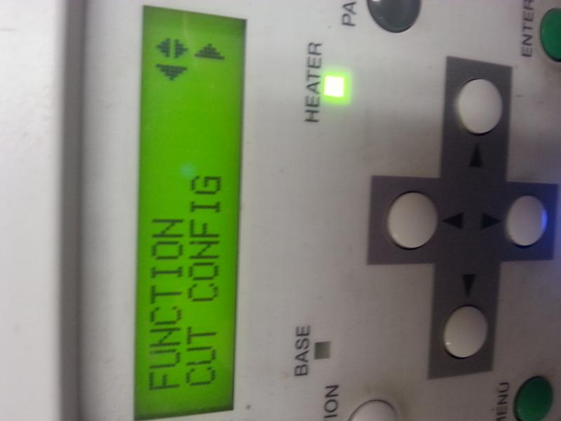

The screen shot of versaworks above is where I set the cut passes but you need to set downforce on the printer. You need to reference your users manual.

Thanks will keep that in mind for the next time , I do know where to set it on the printer as that is where I did all of my test cuts . I never it on the printer even with the xc-540
I'm curious why they even bothered to include that in the software :Big Laugh
