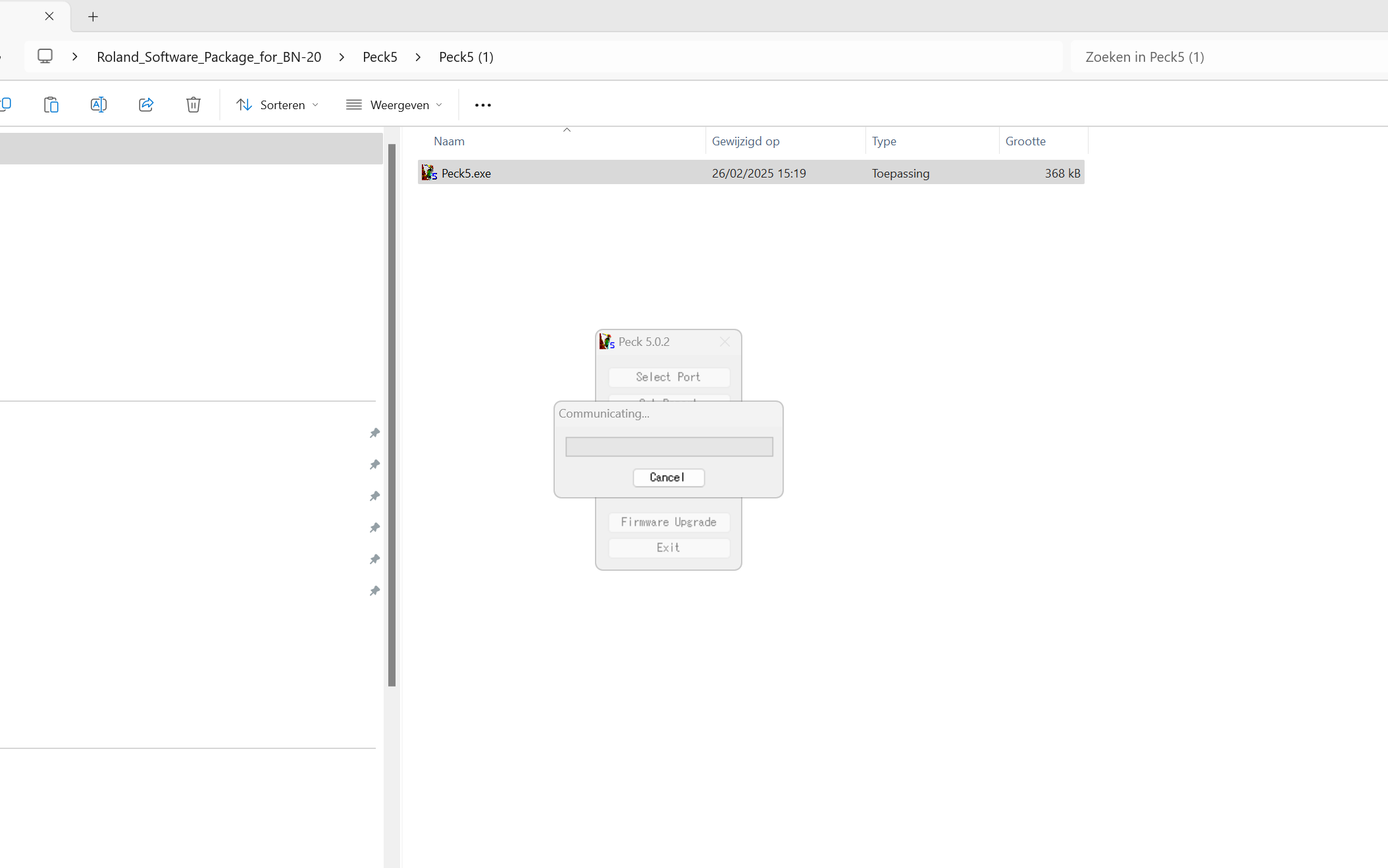

The mainboard from my VS-300i was defective. I wanted to save all data before the mainboard could not be repaired. It has been repaired perfectly in the meantime and everything works fine now. But I would like to know how I can get the pecktool to work

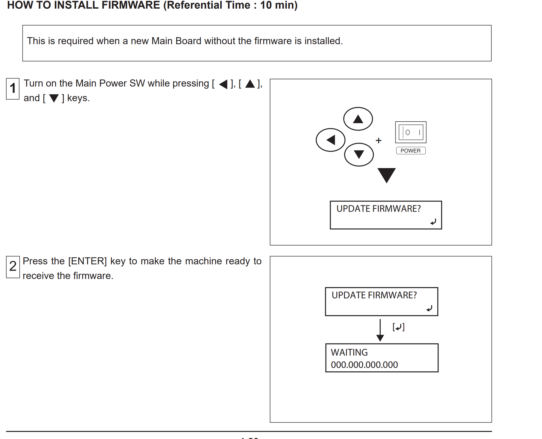

need to start printer in update mode, hold down top, left and bottom keys while pressing power button on front panel. the process is in the manual.

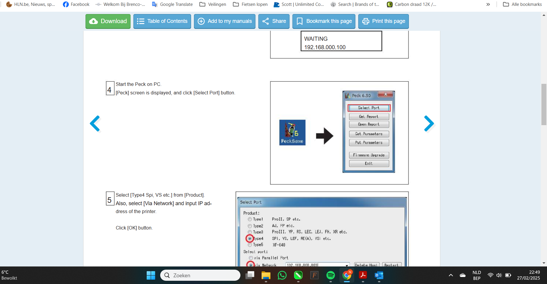

Bud I need stil the Peck tool 6.5. if you looks further in manual. Do you know where i can find it?
