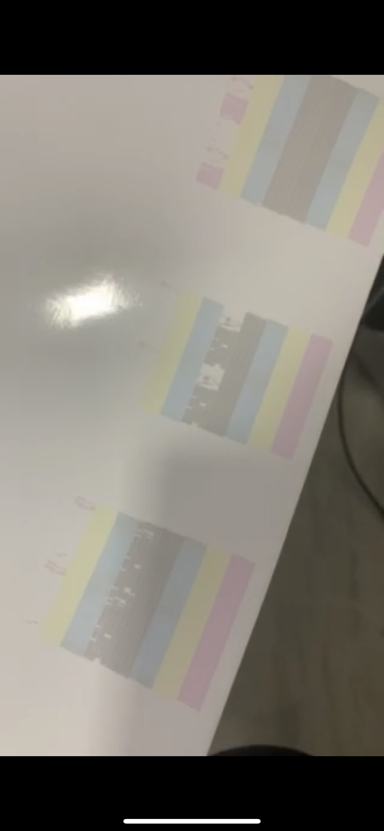

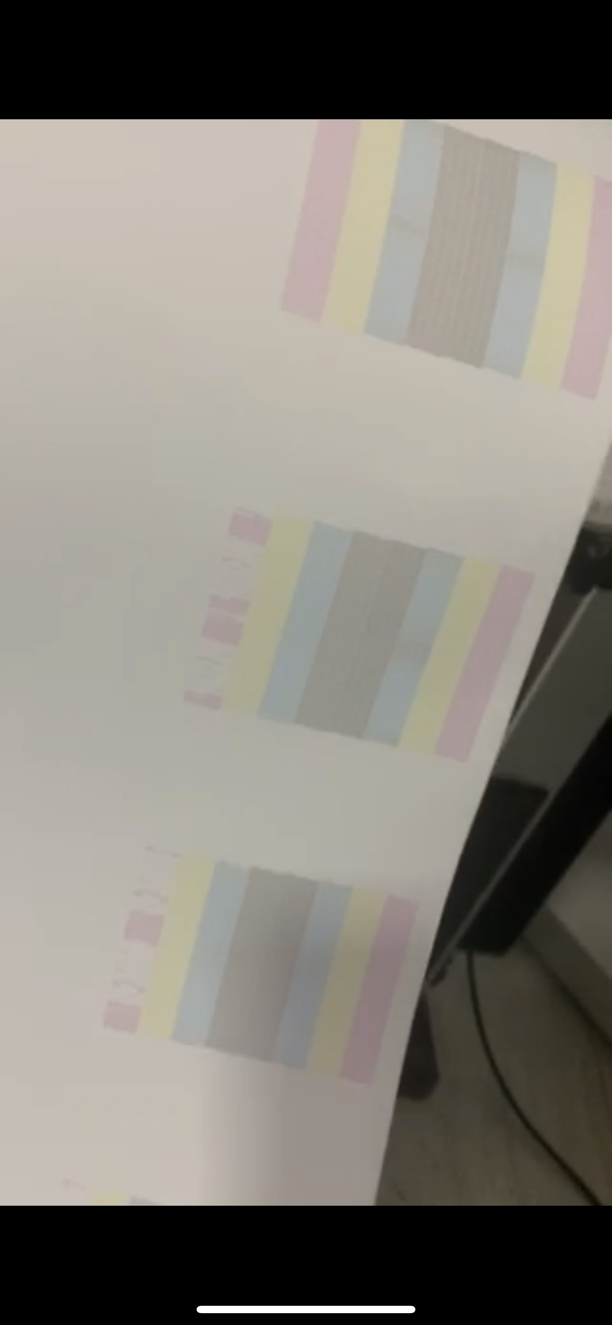

I have a problem with the printer Roland RE-640.
Pleas help me!!
Jim Hancock
Old School Technician
Make sure your cap is clean and there is no ink buildup on the bottom of the head and also around the edges of the head. If that doesn't fix the issue, then replace the cap, preferably with an OEM cap.
