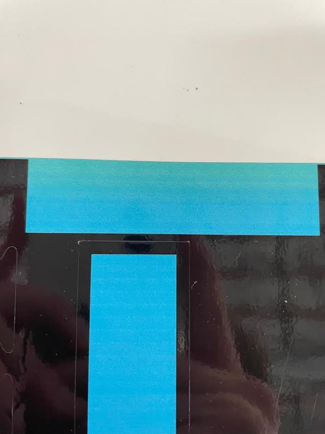

I have a roland RF-640 and it is having issues with blues. When it prints a solid blue at the start of the print it prints a few yellow green like strips then prints the desired blue that we want.
Anyone have any idea why? I have cleaned it multiple times. Could it be the dampers?

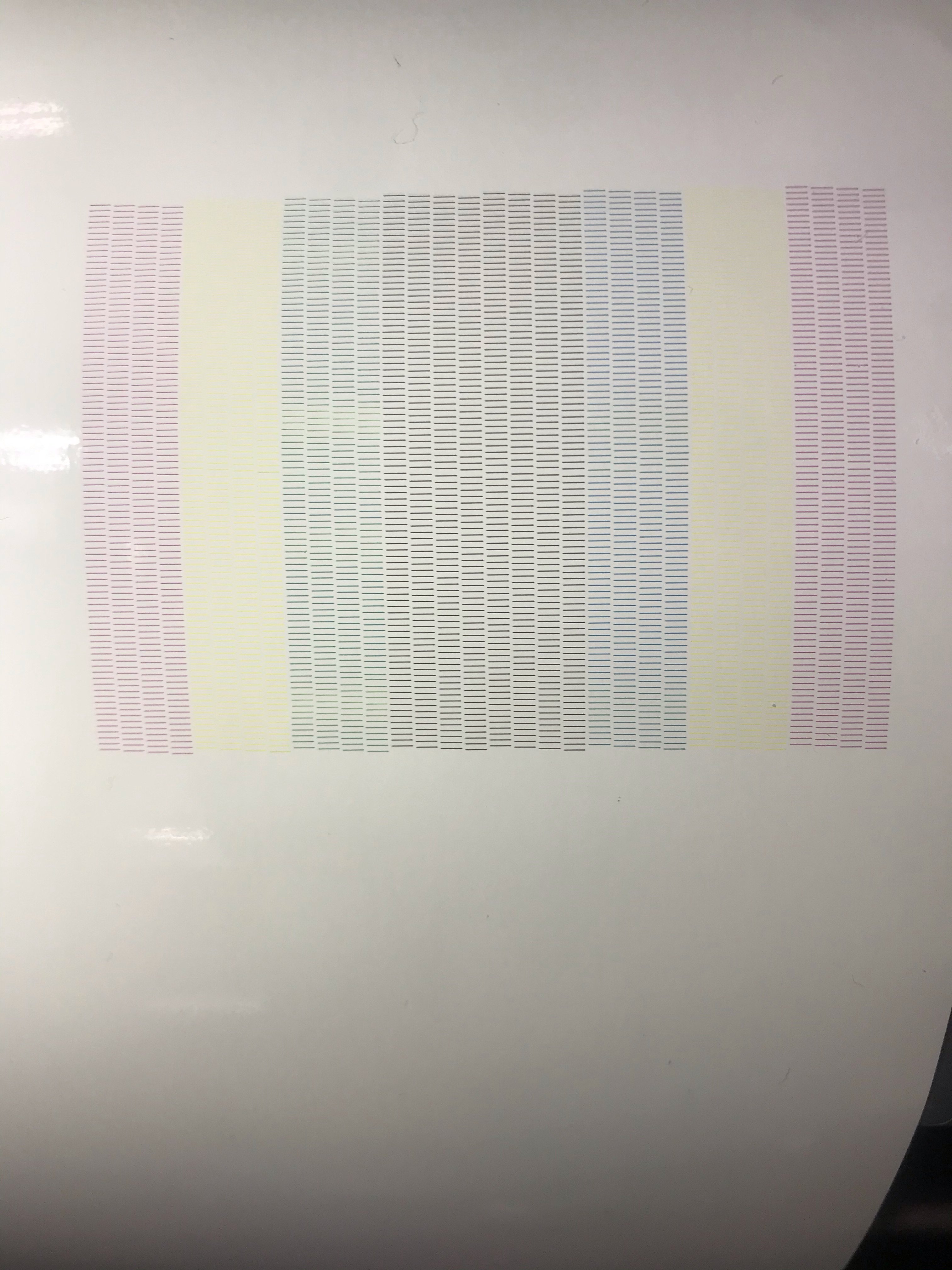

Pictures attached of blue print and test print. The test print has some yellow in the cyan.

Have you had any head crashes? This looks like internal leakage between the yellow and the cyan channels in the head.

Is the yellow in the cyan always in the same place when it shows up?
It would be good to find out if any other operators had a head crash and if this coincided with this ink issue. The damage that is caused by a head crash doesn't always show as physical damage.
