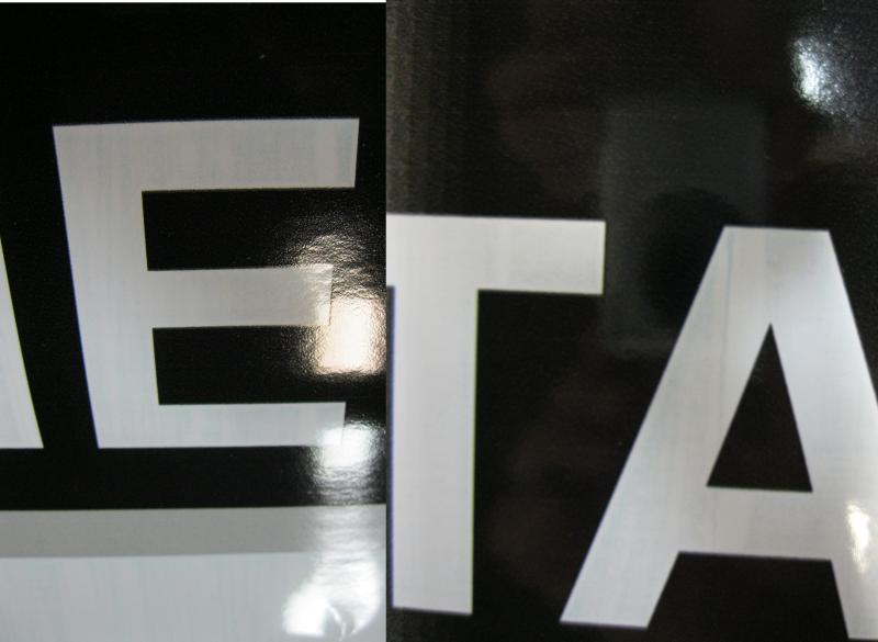

I'm having a problem with Ghosting. Has anyone seen the issue before?
I've seen that occur in very low humidity print rooms (below 25 percent rh). The dry air can cause electrostatically induced firing of ink, and static discharge causes the ink to be drawn to the media.
cre8tivedave
Thank you for your suggestions, I do live in a very dry climate. I'm going to clean the strip and the eye and look into adding a little humidity.
