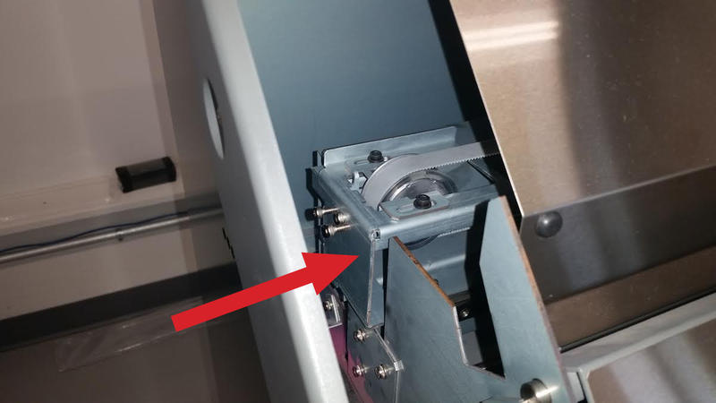

Another update. Printer got much worse since last update. Was making horrible sounds, head carriage wouldn't park correctly (we had to park manually and power the machine down so it wouldn't try to clean itself) and print quality went down the tube. We finally identified the problem. It wasn't a servo board or anything electronic. We found that the bracket(pic with arrow attached) holding the pulley on the left side of the machine was rocking left to right as the carriage moved. Tech Tried tightening everything, but that didn't work. Had to wait weeks to get a new bracket in. Once the new bracket was put in there was no more rocking back and forth, all noises disappeared, print quality back to normal, no more trouble with the head carriage parking. We thought it was fixed. That was last week. Discovered today that the bracket is rocking again. I know that within a week the printer will be down again because of this.

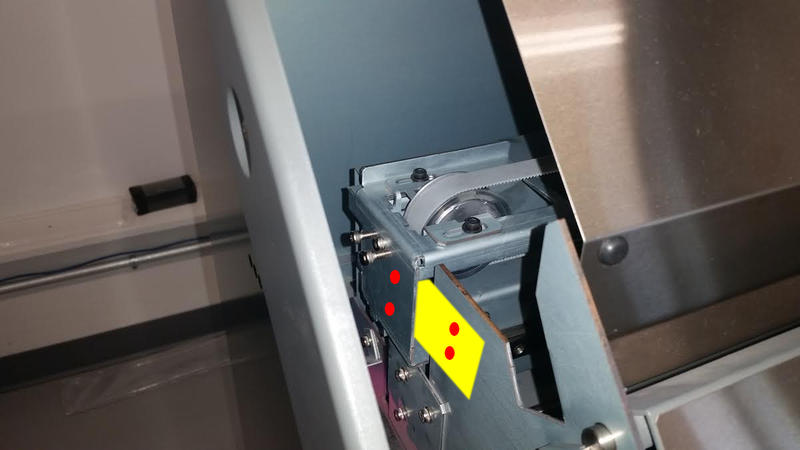

I want to fabricate a stainless steel plate and bolt the bracket in more securely. Crude pic attached, yellow plate, red bolts. I'm pretty sure this will stiffen it up, but where is the movement coming from in the first place? My tech thought the original bracket must have been bent, seemed true at the time, but now the new one is rocking too?
Does anybody have any clue what the underlying problem could be? Anybody see any reason why I shouldn't start drilling holes in the machine and stiffen this up? Waiting for a call back from our tech and from roland too, but I think all I'm going to get is a shoulder shrug as they've told me they've never seen this problem before.

Is there a chance you could get a different tech in? Yours sounds like he is just replacing parts...
We've had both of our dealer's techs in working on this issue with the machine. I know they are trying, but they don't know the problem, or it would be fixed by now. They have also spoken with roland about it, and have been following their instructions. They say it is a very uncommon issue. I must say at first I thought they were jerkin me around a bit, but they have done much of the work as a "courtesy call" and I can tell that the tech cares... Butttt the machine is still not running as it should.
Does anybody else out there have an xj-540? The xc-540 might be the same and have the same pully? Could you look at this pulley and bracket while your machine is printing and tell me if there is any movement?

I don't think it could hurt anything to drill those holes and stiffen that up. If it don't work nothing is broke and you're only out a couple bucks.
I would bet even some VHB and polymetal would do the trick. ;)

Good idea. Probably stick with some stainless, or maybe aluminum and VHB to see if it works. 3mm acm is to thin, 6 mm is too thick. I could mill down a piece of aluminum for a nice snug fit.
Anybody able to see if this bracket and pulley have any movement on their printers?

XC540 here. That piece always moves around, always has.

I wouldn't touch it until Roland is through. You would not want to have that as their reason not to do something for you.

How much movement are you seeing? Ours get rocking quite a bit. Does the belt on your printer ever slap parts of the head carriage causing a slap/knock sound?
When we had the tech put a new bracket in a couple weeks ago, it didn't move at all. We've been running it with the little cover off to monitor it. About a week after the new bracket was installed it started to wobble again. Our tech checked out their xc540 and said that bracket doesn't move on their machine.
Further investigating last week we moved the head carriage by hand and we could feel a spot in its travel where it moves more freely than the rest of its travel. The spot is right about in the center of travel, and you can also feel this spot with your hand on the pulley bracket. You can also see the bracket move when the carriage is in this spot, when it travels in both directions. When the printer is running the bracket moves a lot more than just in this one spot. We checked the rails that the head carriage travels on for wear spots or any inconsistency, but couldn't find anything wrong.

Anybody else out there willing to look at this part for me while your printer is printing? Post#12 shows a picture of the pulley bracket in question. Trying to determine if this movement is common.
