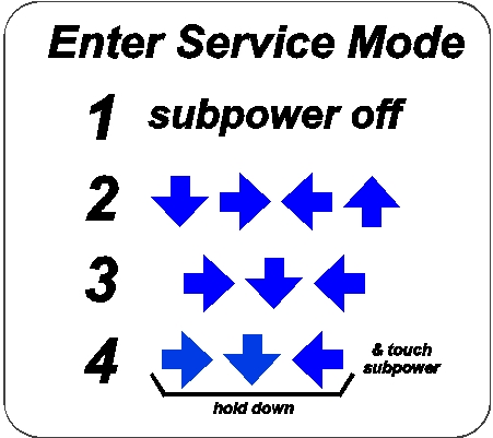

RMXGRAPHIX
try this

Sideline
Thanks...I tried hitting all of the arrows based on each line (2&3) then held the three arrows down at the same time as powering up, but no luck...still same message...Service mode Protected
