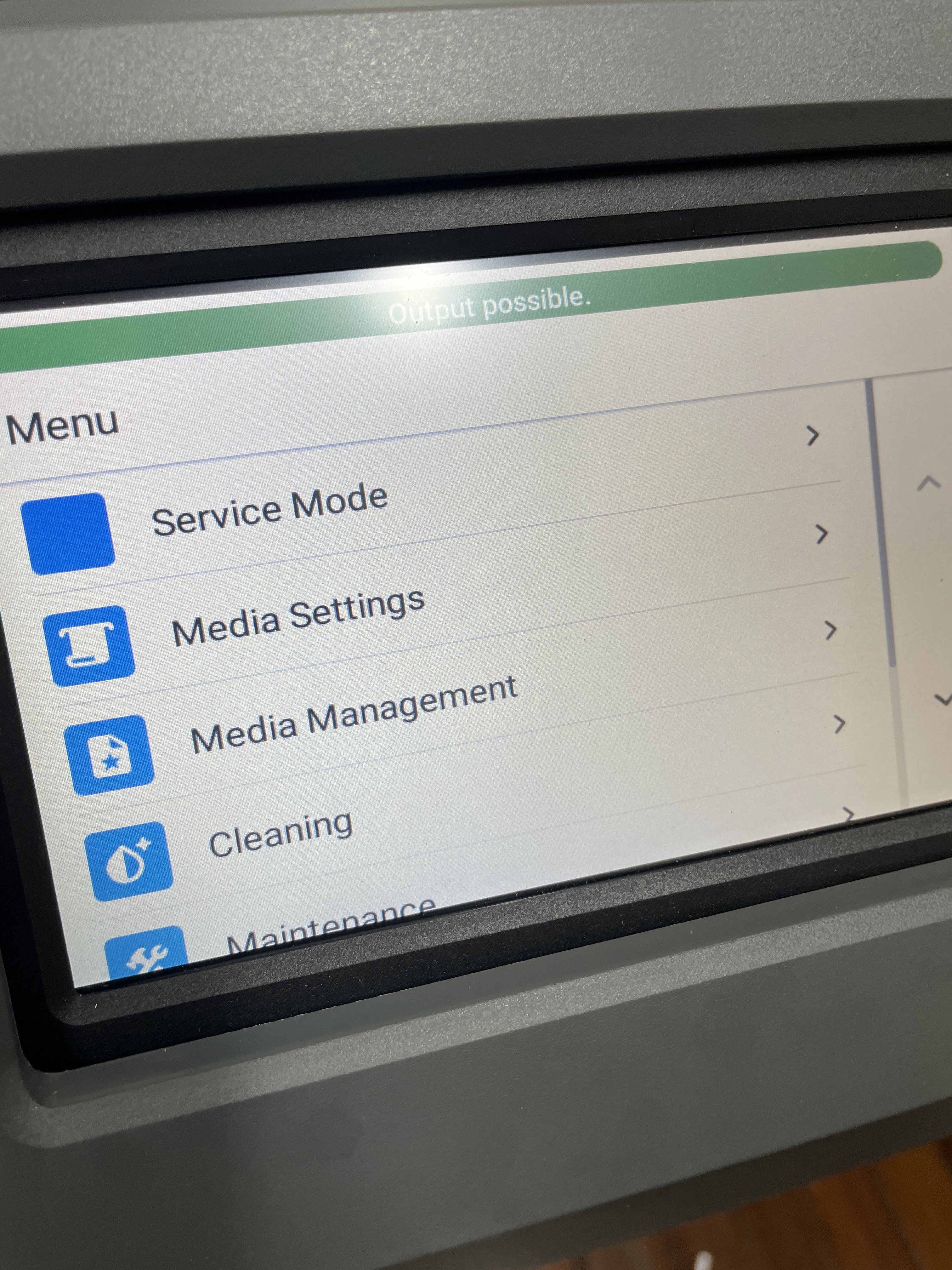

I have a ROLAND TRUVIS LG640 stuck in service mode. Any idea how I can exit service mode?
