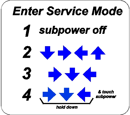

Check your front and rear media sensors. First, look inside both the sensor holes and make sure you can see both sensor eyes on each one. Next, blast them with some compressed air. If that doesn't work, clean them with a foam swab, just damp with alcohol. If it's still not working, go into service mode and check the F & R sensor responses by covering and uncovering the hole.
  • SP-540 Sensor check.pdf
