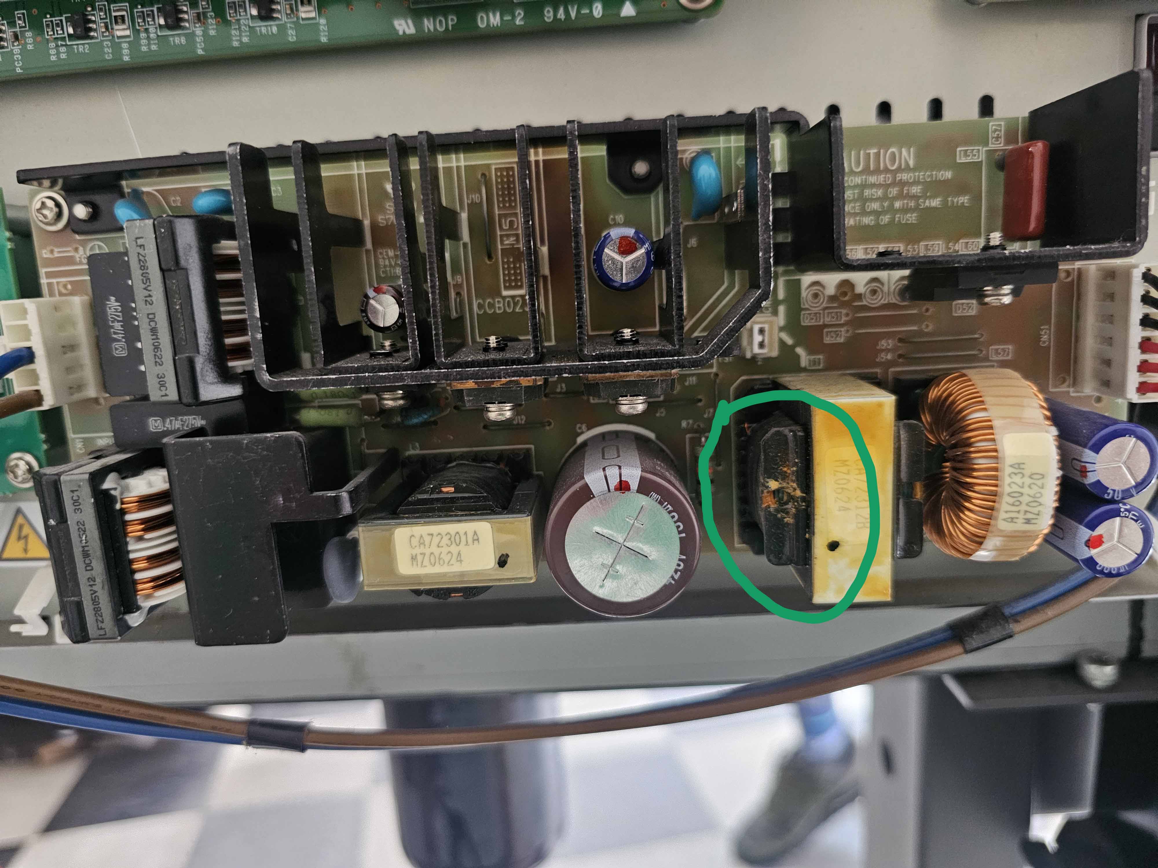

Roland Sp-300 Not Turning On
netsol
so, nothing lights on the large board above the one that is circled in the picture?
i will look in the morning, if i have a similar service manual at the office.
then i may have something more useful to say
SheddShirts33
I put the old power board in and I can still hear the faint buzz noise but its alot quiter and sounds less powerful(if that makes any sense)
When I unplug the power board and turn it on, I hear nothing...
Any suggestions on if it might need a new something? Really hoping I can get this fixed
Thanks again!
damonCA21
If you are sure you are not getting power to the board when you check the mains voltage then replace the mains input socket. It is possible this is making a bad connection. Swapping random things doesn't work, you need to be methodical and test from the mains input to the the output of the power supply at each stage.
Test the input to the power supply and if there is no mains AC there then work backwards,
To be honest, if you can't do basic voltage diagnosis then find someone who can and ask them to do it, it will save you a lot of time

SheddShirts33
I assume I can just buy a power socket from roland?
I am going to try and get an electrician to the shop and see where there is power
SheddShirts33
I am having an electrician come tomorrow and see what he has to say and will report back
Really appreciate all the help!
SheddShirts33
I had an electrician come and his best guess is the power board is bad because all the power works before it but then the 2nd half of the board basically has no power(very low amount) I also noticed the attached photo it looks off but maybe thats how it normally looks and isnt the issue. I assume I need a new power board
damonCA21
It could be the power board has failed, or never worked properly in the first place :( I have used tested guaranteed boards in stock if you need one
