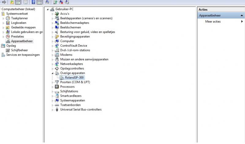

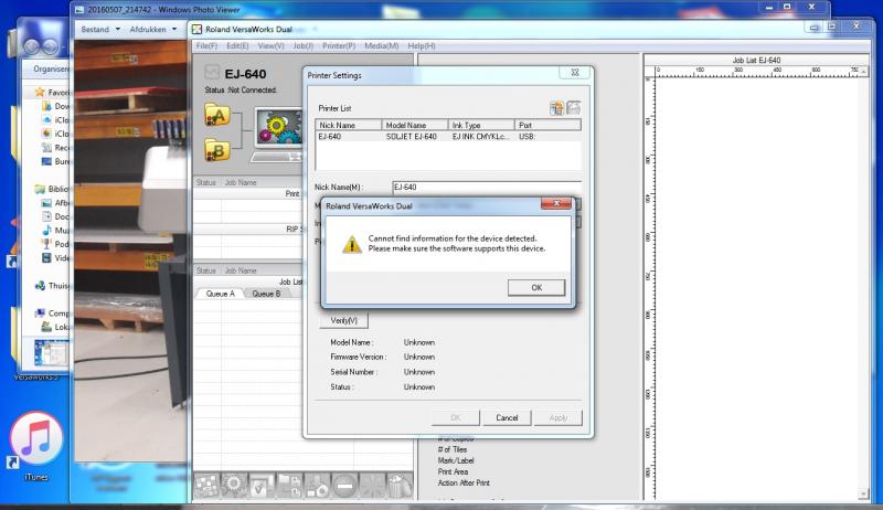

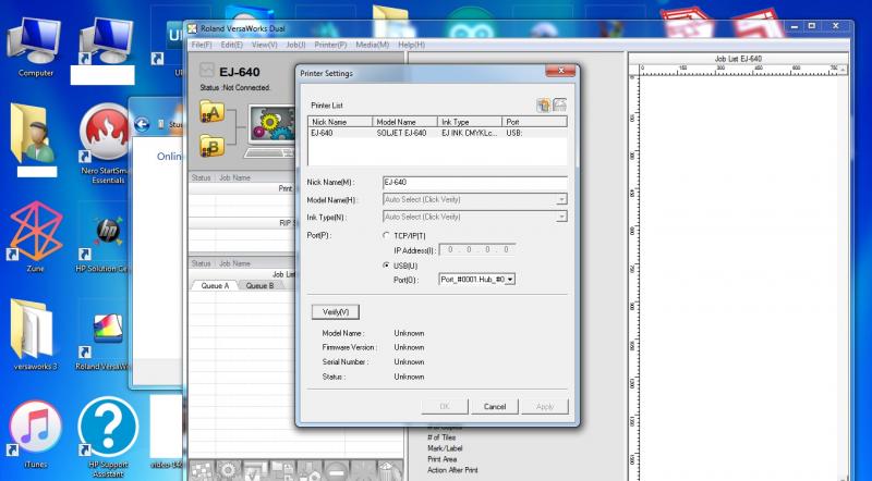

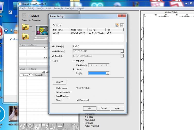

My first experience with Roland. I have experiences in their maintenance. the computer recognizes them. But did not recognize the printing software ,
(cannot find information for device detected please make sure the software supports this device)
look at the pictures

Hey muhanad,
The "SP-300" is not supported by VersaWorks, but the "SP-300v" and "SP-300i" are both supported. If you have the original 300, don't waste your time, it will not work.
However, if you have either the 300v or 300i, there's no need for you to continue struggling with this issue. It's recommended that you contact Roland support and get help with this ASAP. We'll need you to complete our support submission form so we can create a support ticket for you. Go here to submit your info: Product Support Form | Roland
