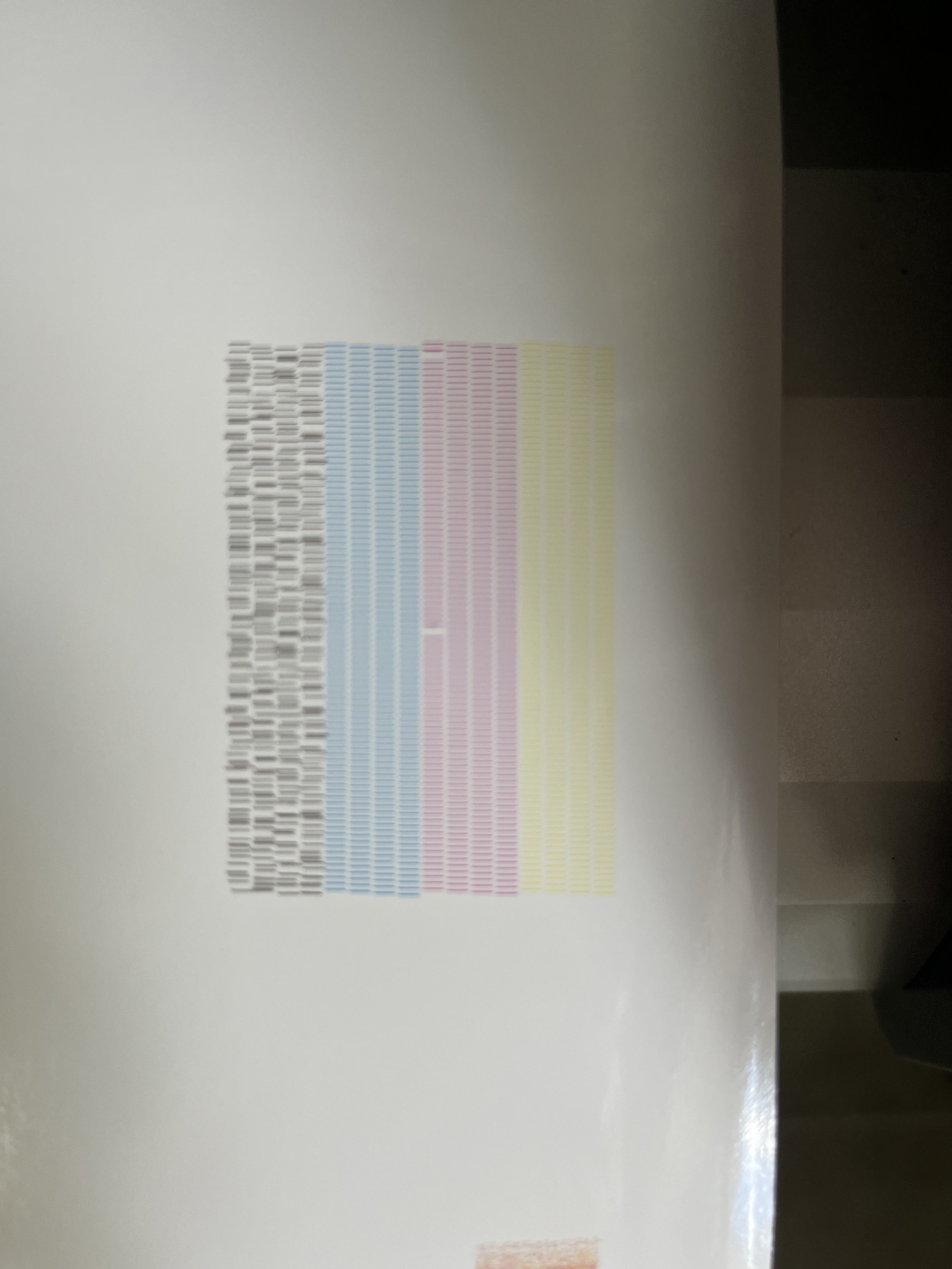

Doing a powerful clean on it now which I don’t normally do. I usually manual clean once a month and that’s it. Reason for this I know! It has very low hours on it as I still used vinyl more than I should have and I was afraid of it at the beginning! I think I may just fix it but here are some samples.

I'd try a 48 hour head soak, turn off the power and unplug. Make sure you clamp off the lines after the cap tops and then use the tool to lower the capping station, mover the print carriage over a bit and fill the cap tops with cleaning liquid, move the print carriage back into place and raise the capping stations. Refill as needed after 24 hours. Once the soak is done, run a powerful cleaning and see if it helps at all. You can also try the syringe technique if there is some improvement, but not complete.

Sounds like you might need new cap tops as well, especially if their older then 6 months. After the head soak would be a good time to replace if you have spares in stock.

Just replace the head. Lose too much time trying to recover a DX4 head, when you could be printing flawlessly.
cornholio
The black deflection happening on DX4 with EcoMax ink is normal.
Soaking never helped for me, because I think it's corrosion on the nozzle plate.
Replace the head and switch to EcoMax2 ink and your head will work for years. (As long as the caps make a tight fit, the pump works and the wipers are renewed periodically)
