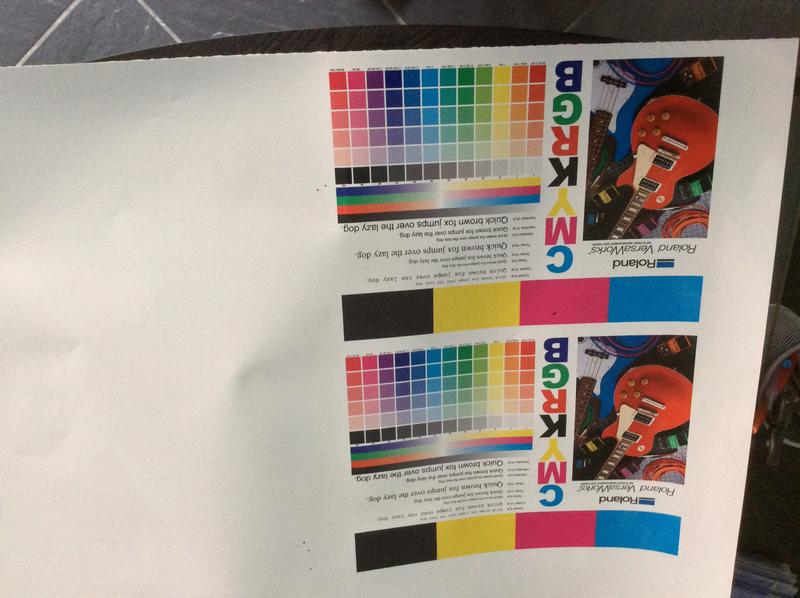

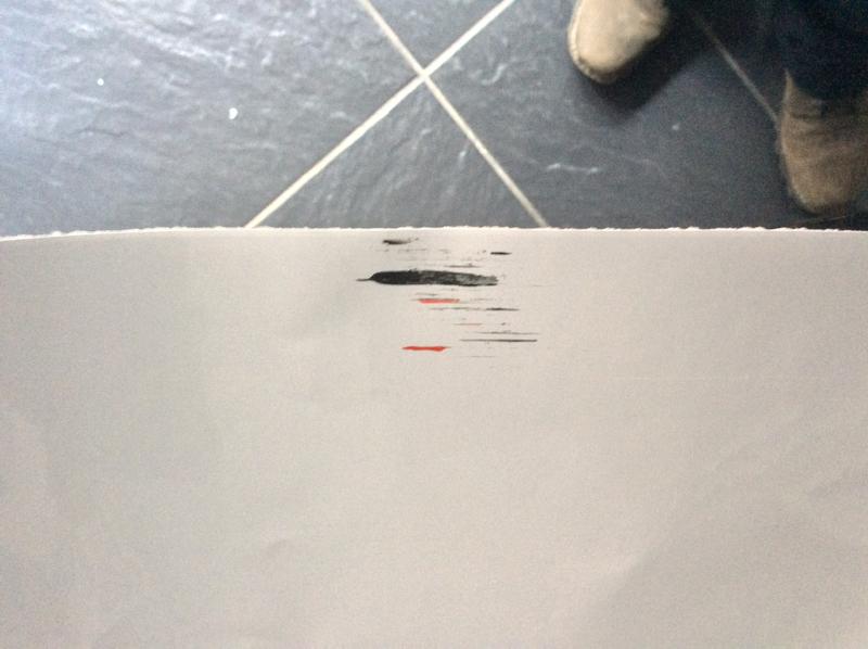

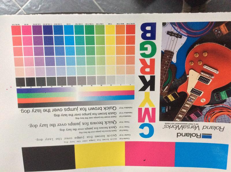

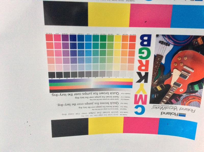

player
The test print is when you press the test print button and it prints the 4 blocks made up of little bars. This lets us know how the heads are really doing.

I would like to see the test print from when you hit the test print button on the panel. I don't think you will have a very good print.
Again, what brand and type of vinyl are you using?
I print miles and never have a head strike or smudge. There is still something not correct. Keep it up and you will need new heads. I wish you the best, I am telling you this from experience.
