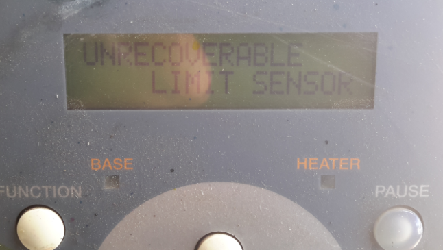

Hi Jim,
I tried your advice and came at a standstill after I moved the head to the locked cap position. I pressed enter and then the machine came up with a message "unrecoverable limit sensor"...please see attached image. Non of the buttons on the machine would work except for the on/off button so I could not proceed any further and had no choice but to turn the machine off. Please your further advice would greatly be appreciated.
Thanks in advance!

Hi Jim,
I managed to complete the "initialize the limit" procedure and did a print test and had the same results. BLANK WHITE. I moved the head to the left and saw that the caps have no inks at all, BLANK WHITE just as previous pics. Please do you any suggestion? I'm thinking the head could be clogged...
