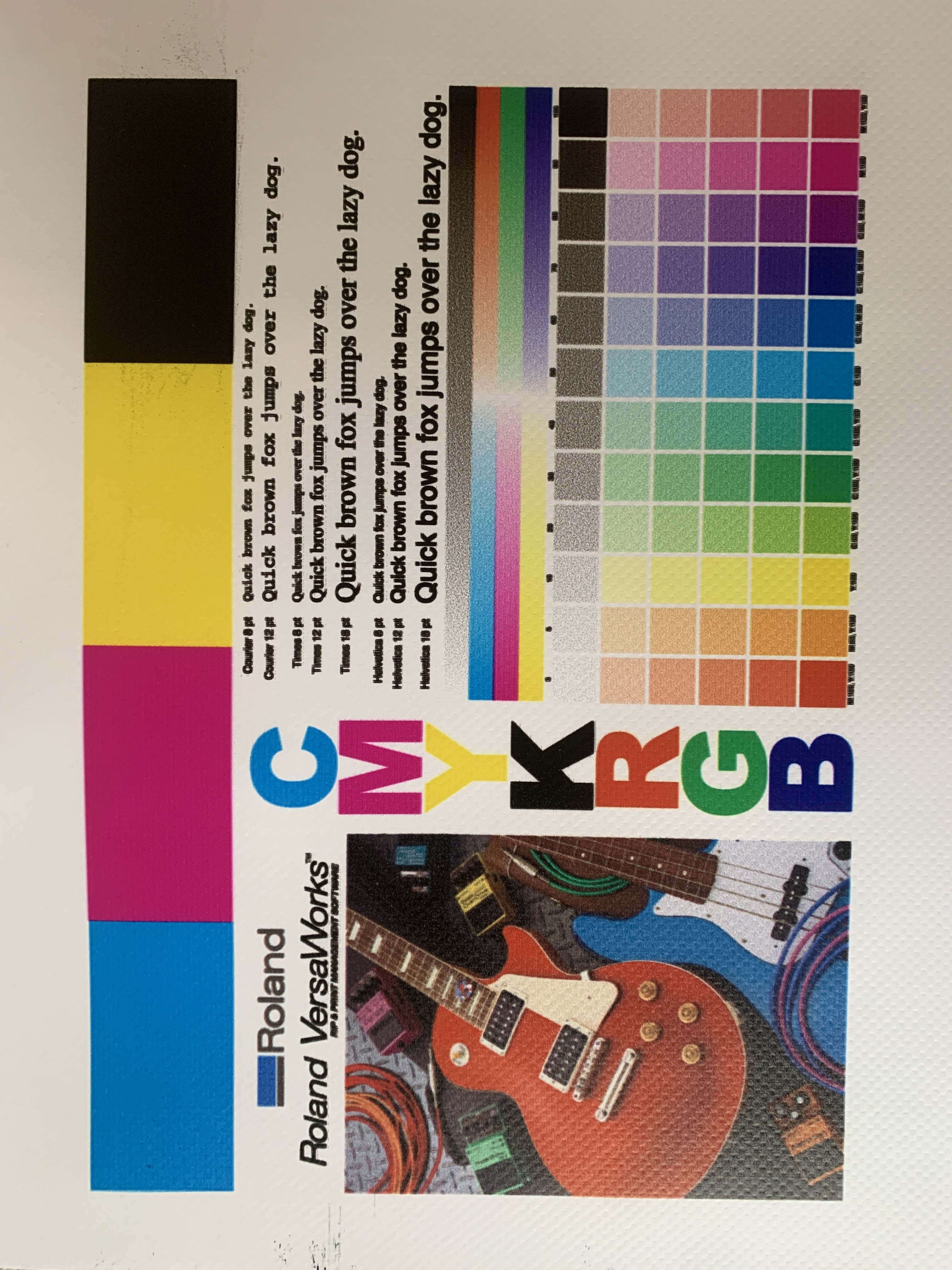

Damper failing?? Go into service menu, arrow down to test print, go down to full, and do a print from there and post image.
Also a test print using the test print button.
Riada
Looks good here

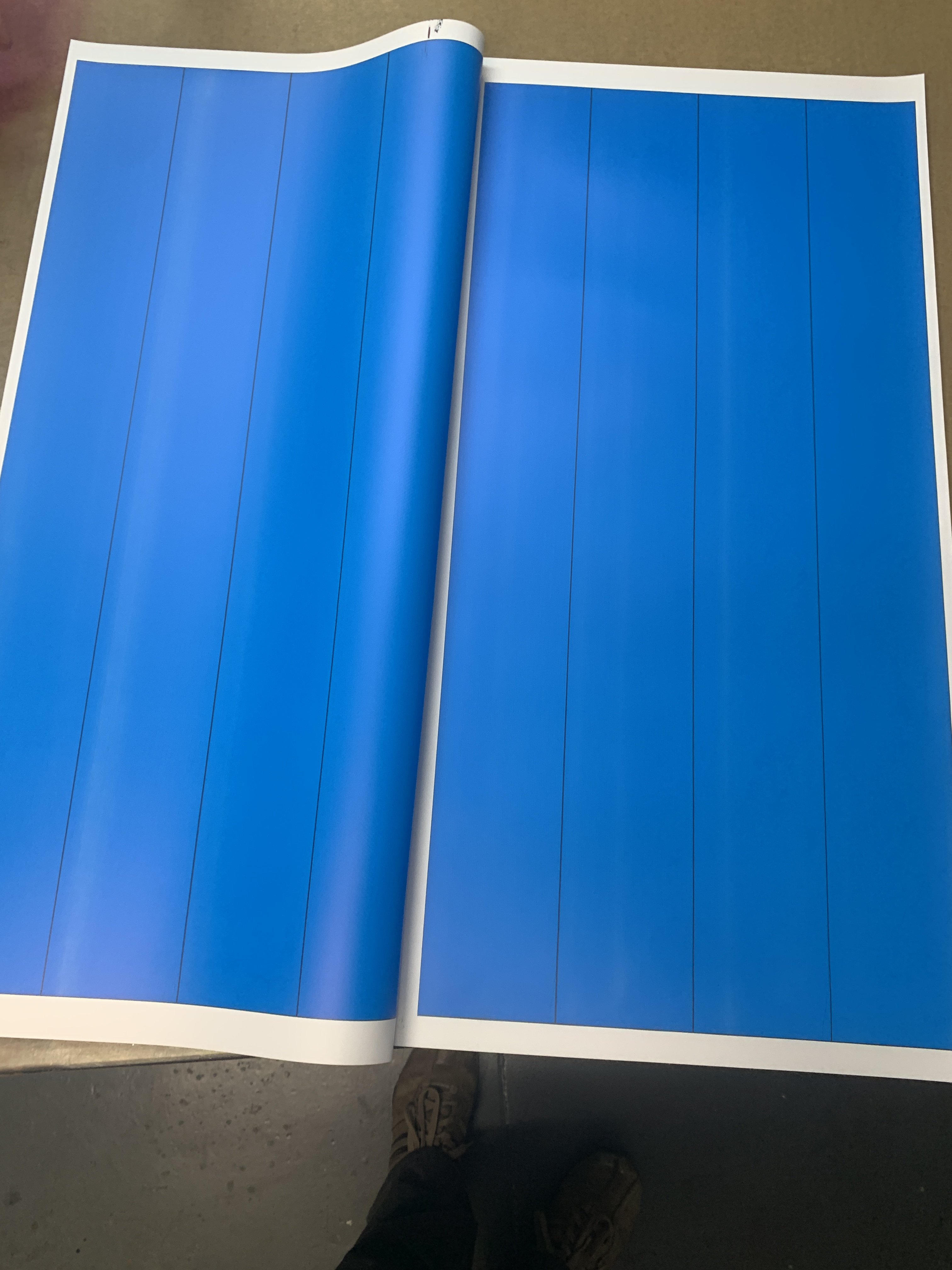

Riada
Same print again. I’ve checked the damper and it’s ok.

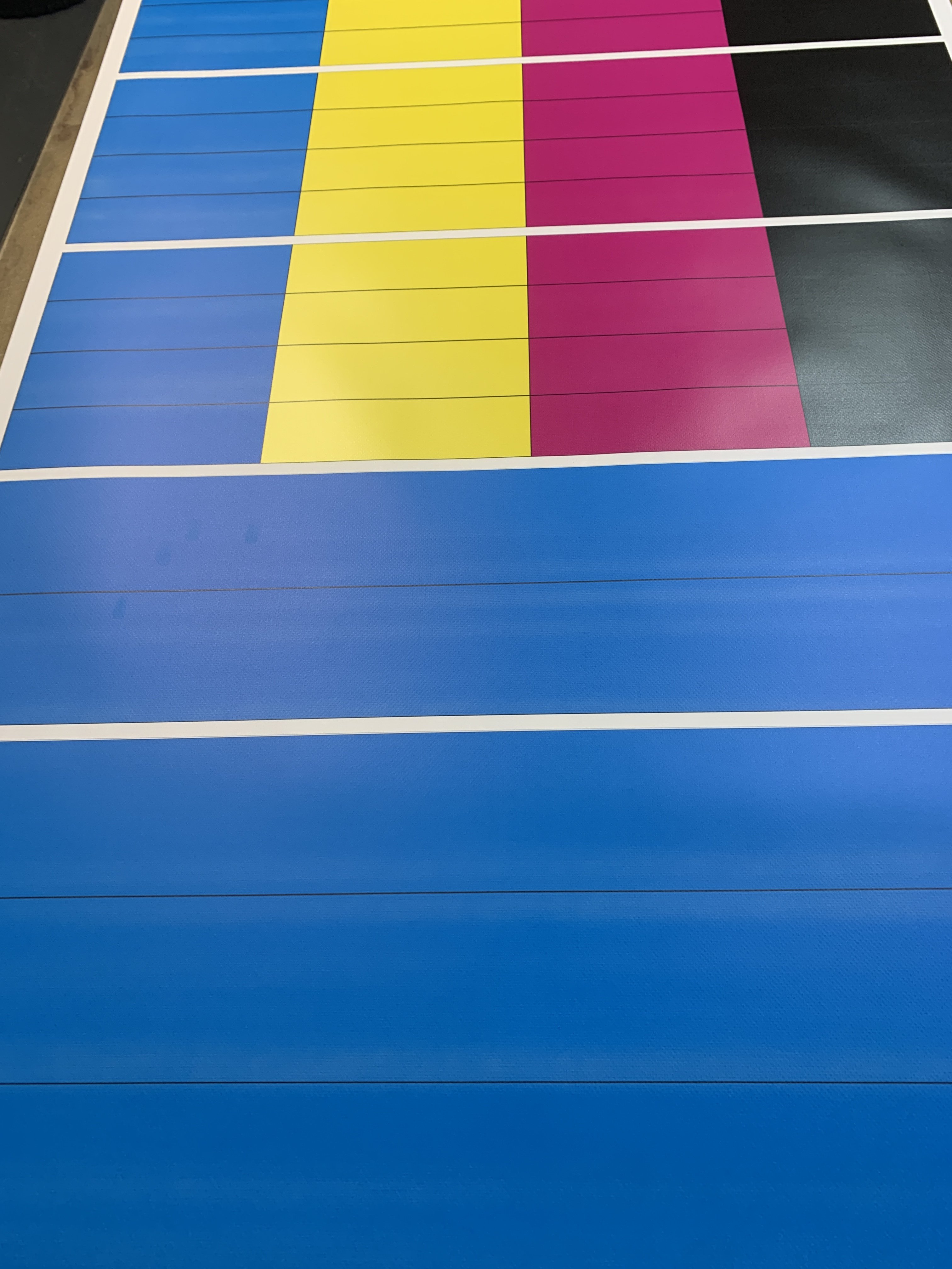

Thanks for all your advice. Regarding the media we have tried this on all different vinyls and this actual print is on banner material. I’ll try to clean everything associated with the cyan line to see if this helps. I’ll keep you updated. Thanks.
rjssigns
Looks like an overlap issue. Had something similar when I had my SP540V. There's a service menu to access the print patterns to check overlap. Don't ask me how or where to get to it though. I sold the printer three years ago.
You also said you replaced the head or heads. There is an alignment procedure for those which is where I would start. Again, that would be found in the service menu.
MikePatterson
Head bathroom cleaner.
Is that banner media?
If so unroll enough off the roll to do the job. I get light lines with new roll of banner and the printer having to pull it off the roll.
