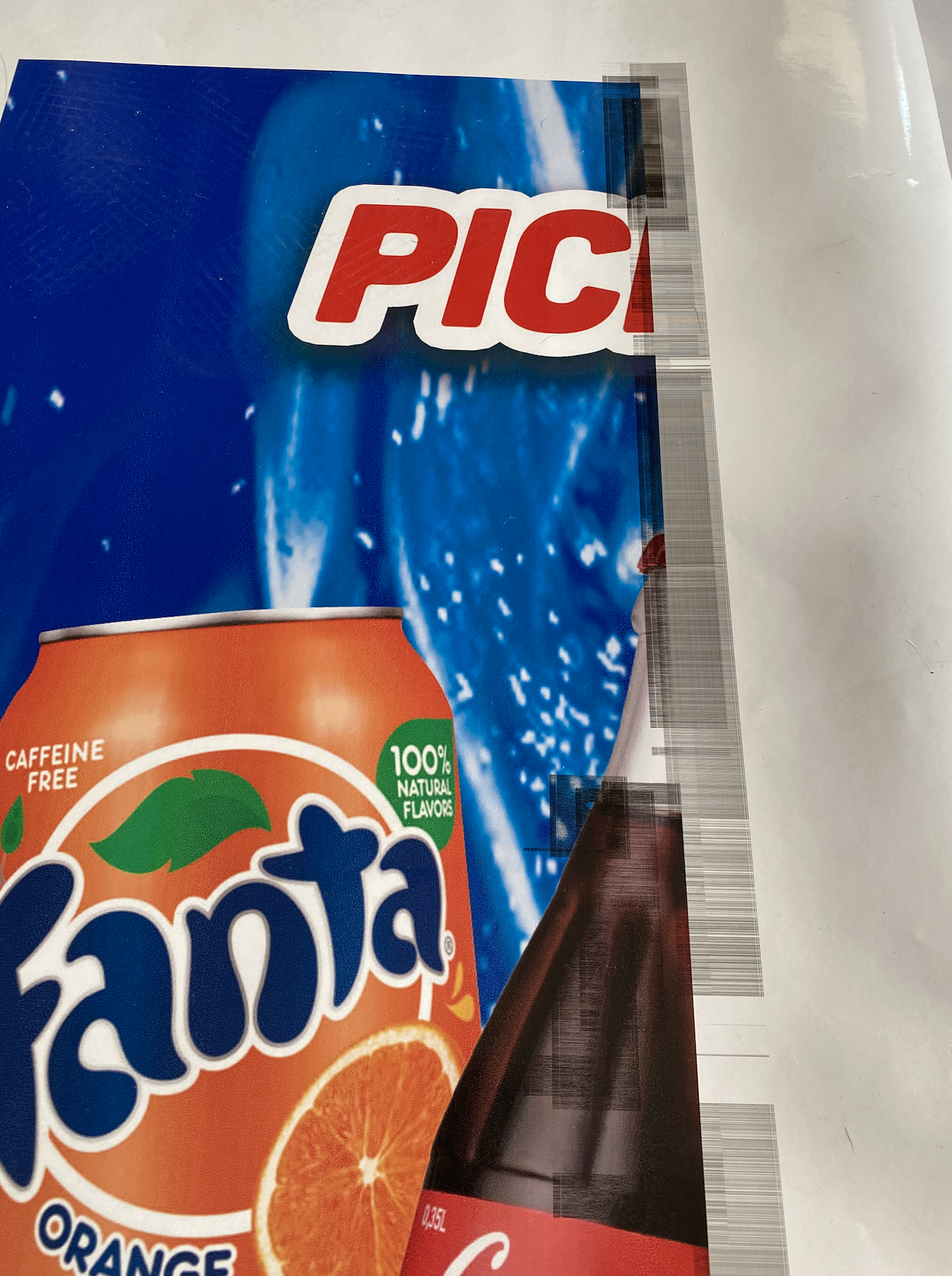

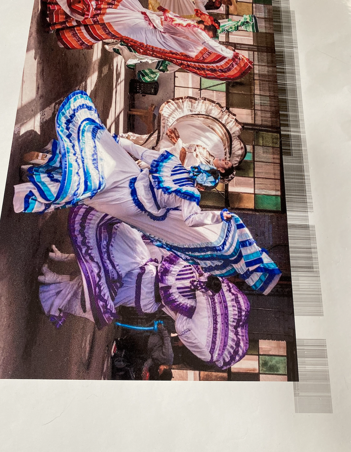

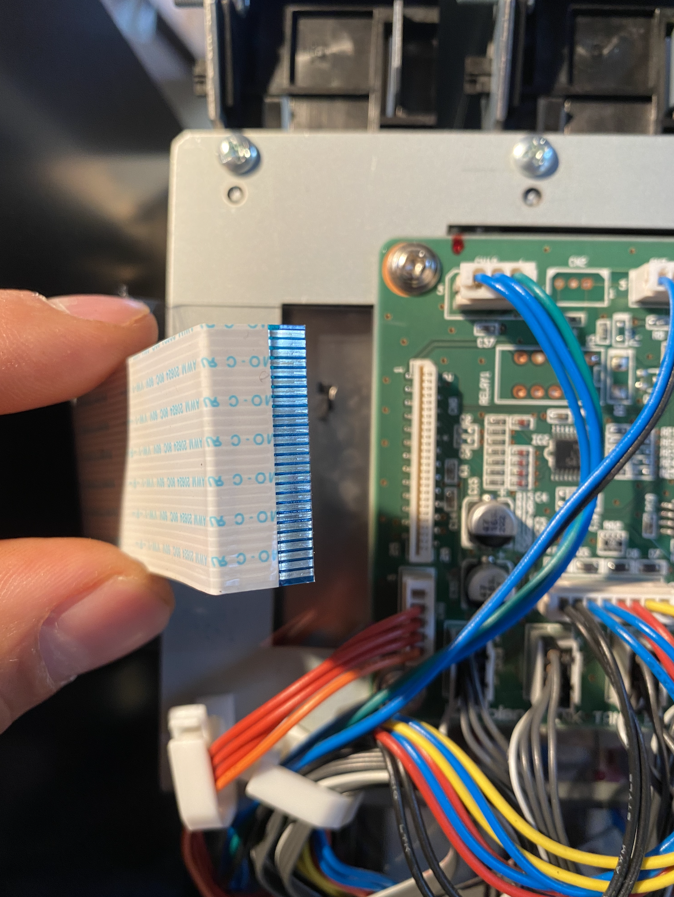

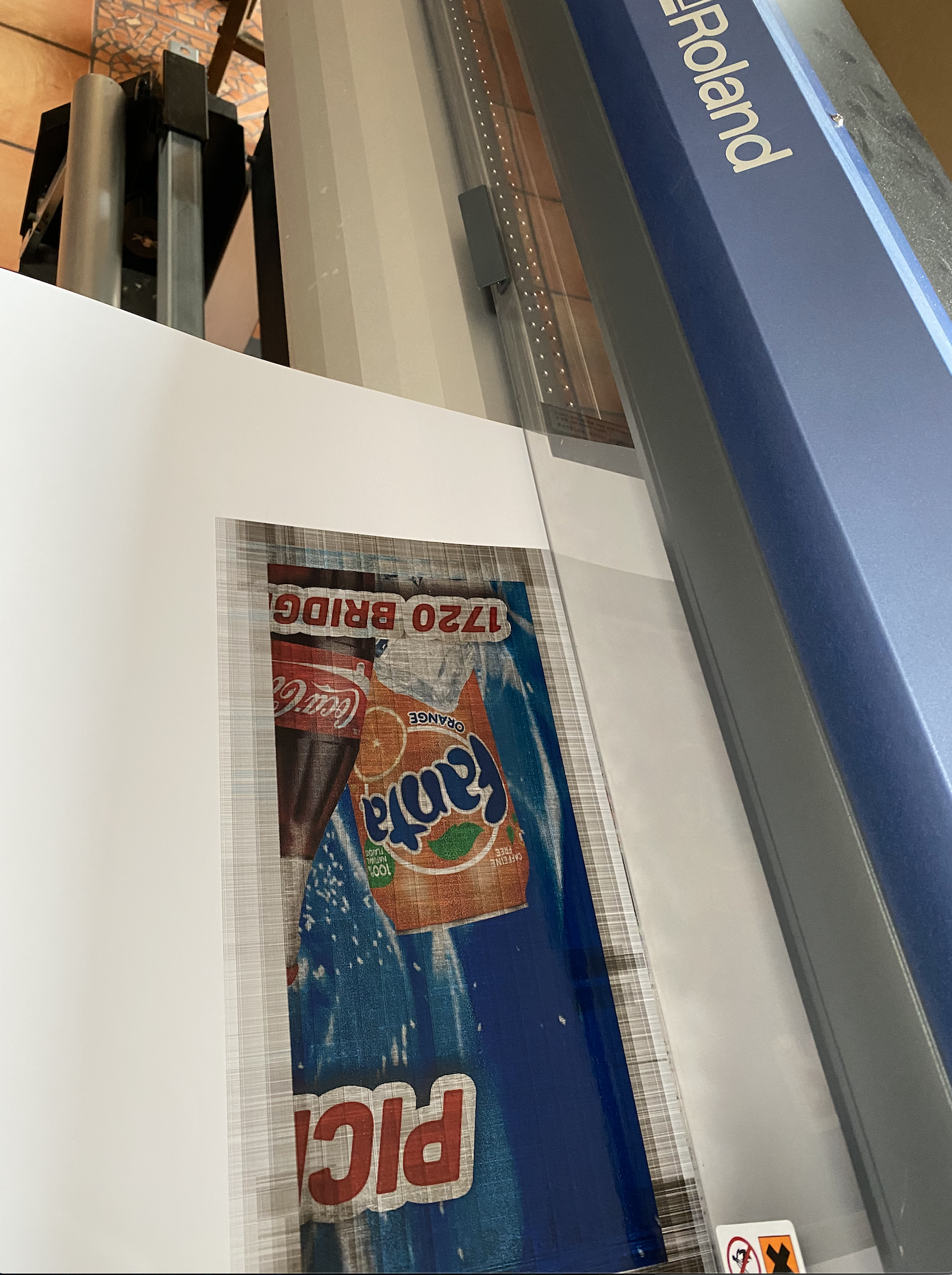

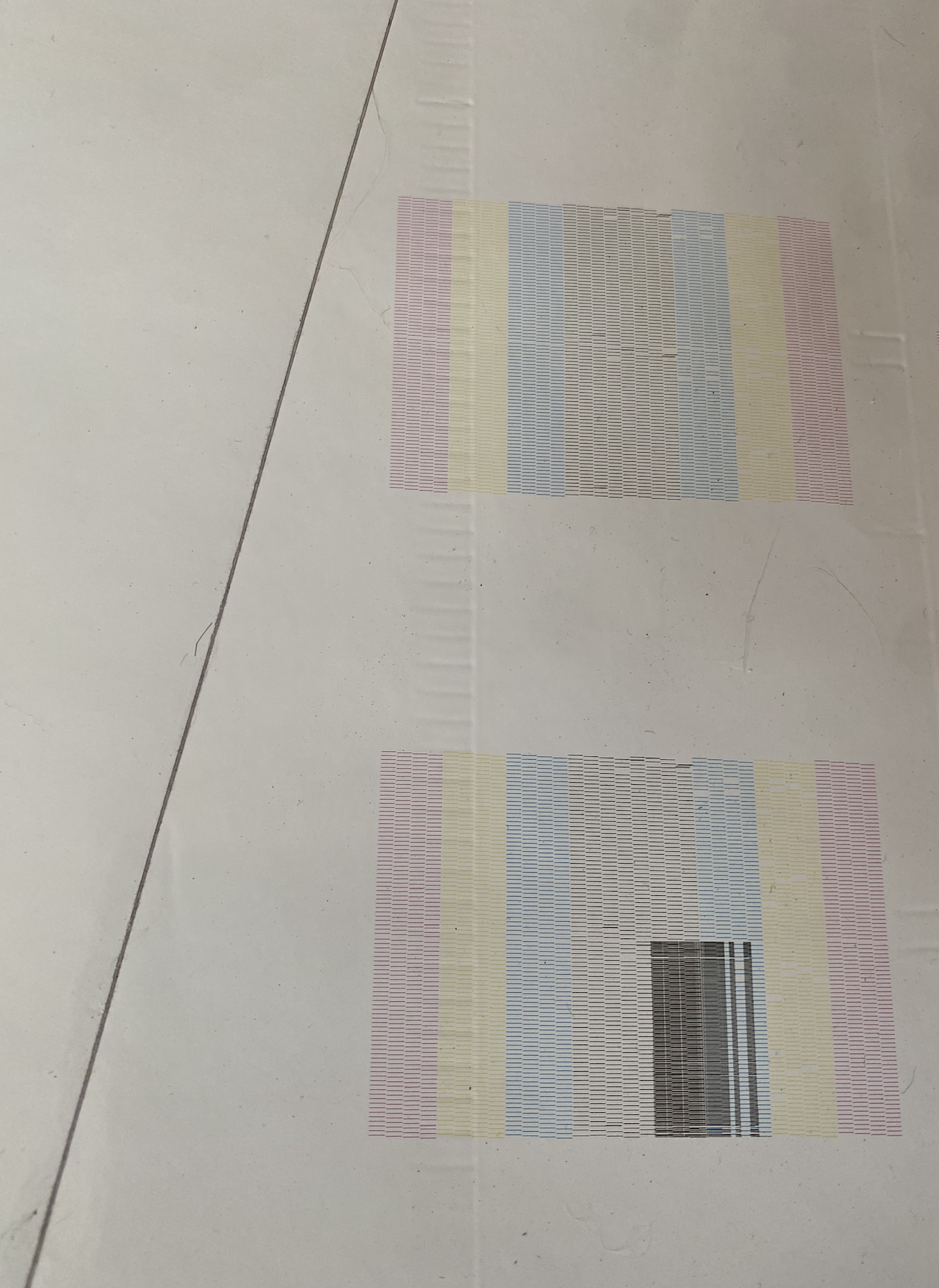

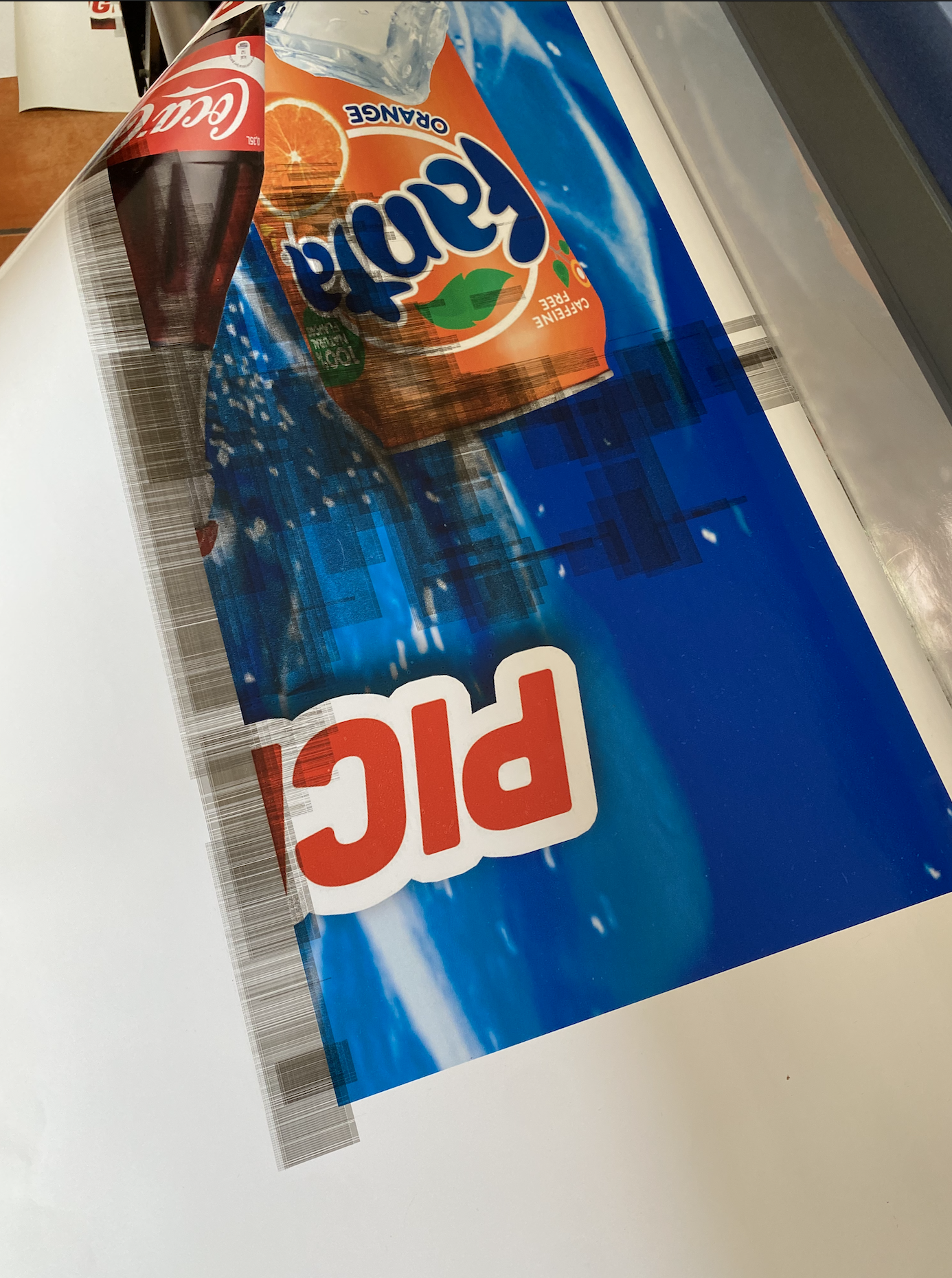

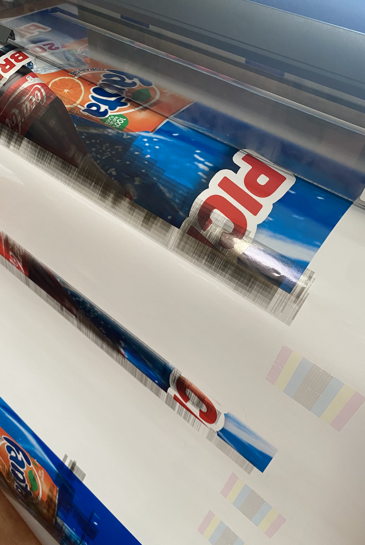

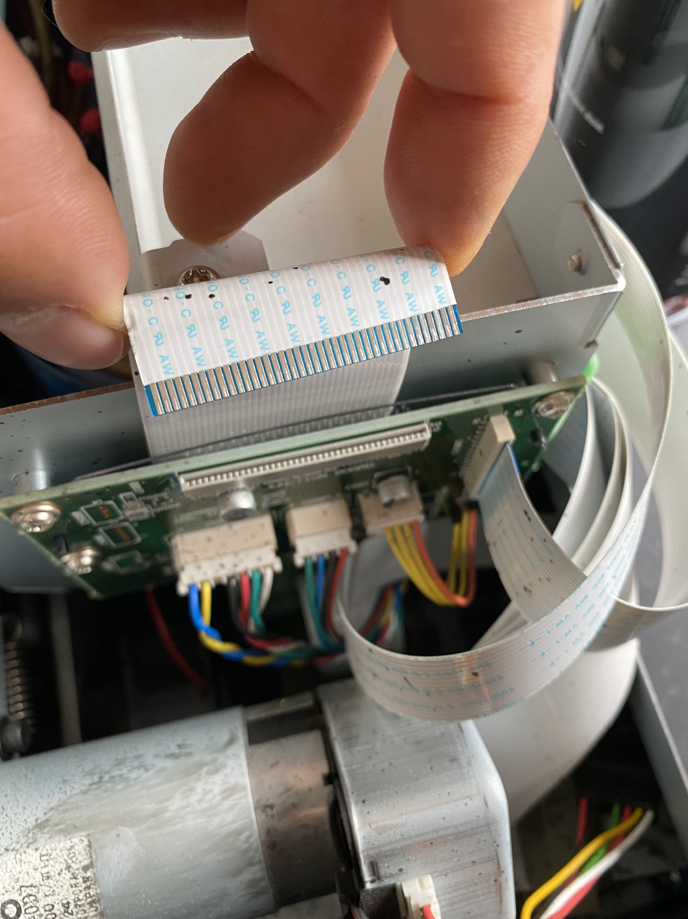

Luckily with the help of a local tech, we've been able to bring it back to life. Had been sitting around about a year. Print head in good shape. Initially had a busted cyan line that made a mess. Got that cleaned up, installed 3 new dampers. Currently had it running, looked good, and this morning it began printing black streak that looks like barcodes on the print. We've done nozzle checks, new dampers, multiple cleaning cycles, manual clean, head soak. I even cleaned the encoder sensor. TBH I don't know much, this is my first printer. I've reached out to 3 other friends in shops and they don't recognize the problem. Before next week rolls around and I have to reach out to techs I'm wondering if someone can spot the problem with the pictures attached and suggest something. I have to crank out work over the weekend. I've tried searching older posts, and can't find anything matching exactly. Much appreciated.
