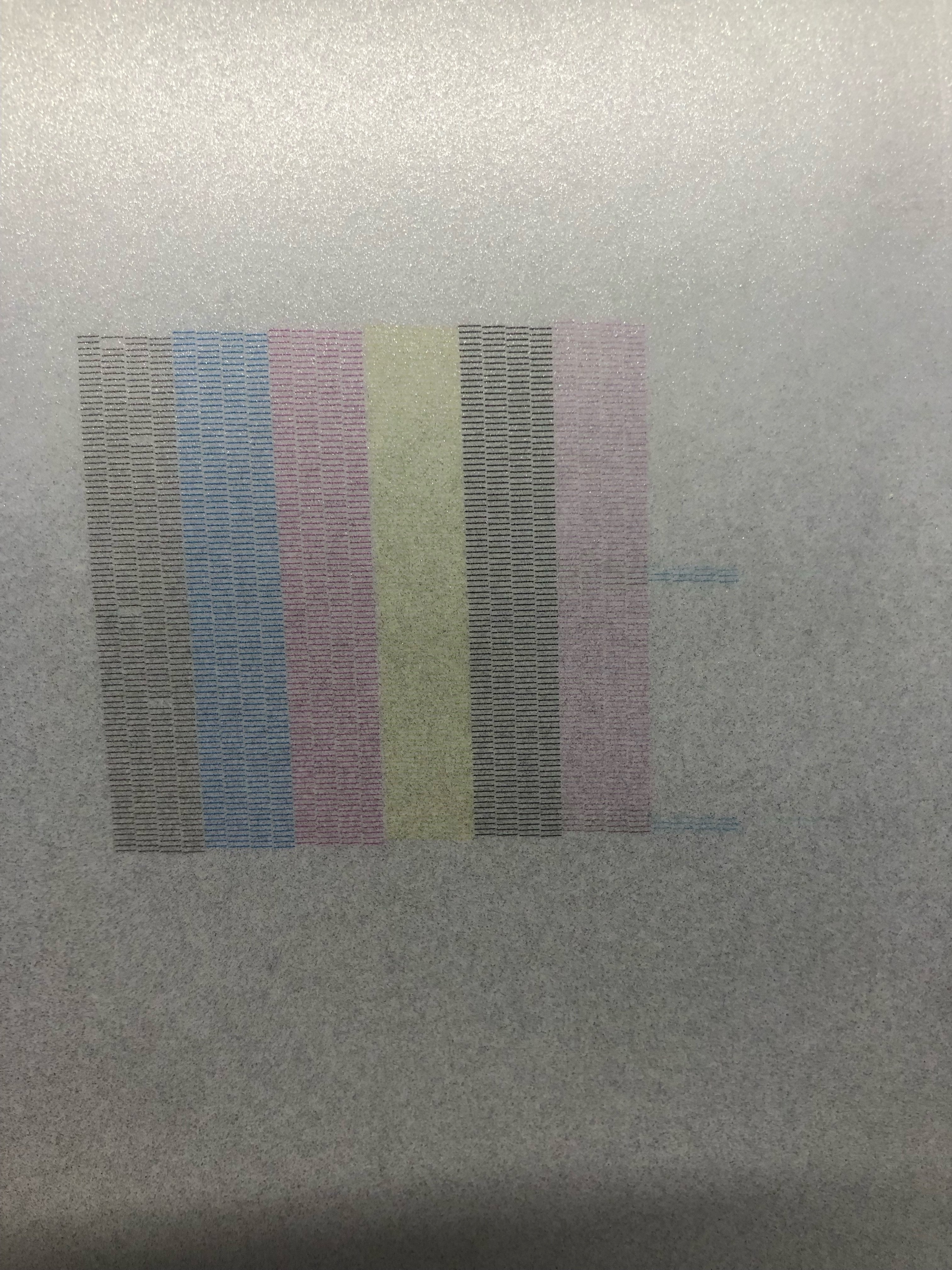

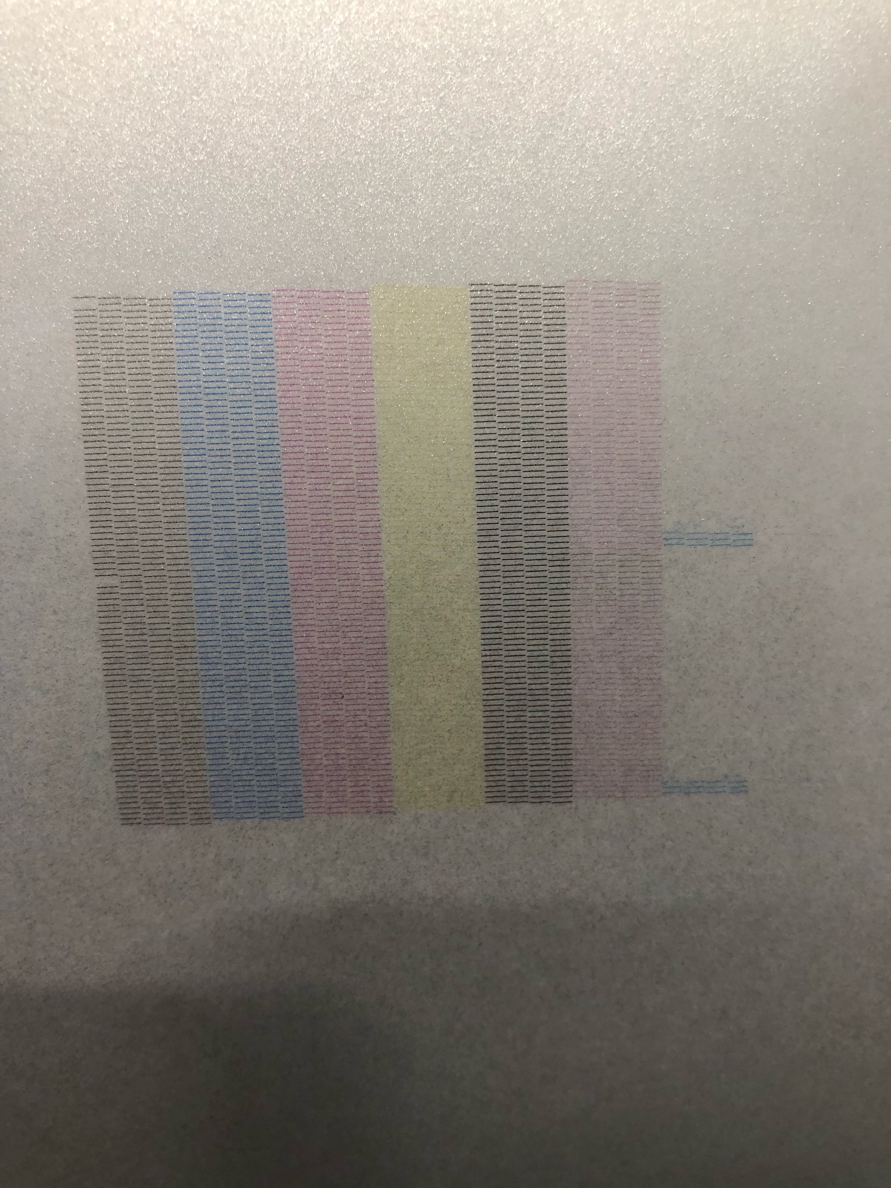

Hiya all,
I'm having a few problems with my VS-640i, it just doesn't seem to print the white at all. As you can see from the test prints the white and light Cyan are pretty non existant so I am assuming its something to do with the nozzle? Id assume they're blocked?
It was left in a workshop for a fair few months so it hasn't been maintained for a bit and now I'm just trying to get it back to tip top shape so I can use it. It prints absolutely fine, just not white backgrounds etc and id assume light cyan too.
When I take the ink tubes out from the dampers the ink runs out so I'd assume the tubing isnt blocked? It could be the dampers maybe? Or would it most likely be the nozzle being blocked? I have done a couple of overnight soaks too in the hopes that would help, but it doesn't seem to have done much.
Any help or advice would be appreciated

If it was left for a few months it has almost certainly blocked the damper, and probably the head and cap top tubing as well. White ink congeals really quickly and if you have a printer using it it really has to be left on all the time to run the cleaning cycles. You are probably looking at needing a new head, so I hope you didn't pay too much for the printer!
Head soaking rarely helps with white. You will probably find the ink has taken on the consistency of thick oil paint, or has dried out and clogged completely.
First thing to do is change the damper and captop ( only use OEM Roland ones as the cheap chinese copies are junk ) and also check all the tubing from the captop to the pump to make sure it is completely clear and any connections are not clogged as well.
Then run a powerful clean and see if you have any white coming out into the waste bottle. If none is coming through, but the other colours are, then your head is blocked and will need replacing.

Yes, the white ink is much worse than the other colours. It has a lot more pigment in it, so if it starts to dry then it blocks things very quickly.
If it wasn't left plugged in and switched on for more than a few days then you have very little chance of recovering the head sadly. Try the other things though just in case, but if none of them work then a new head is the only real option. The captop and dampers are easy to replace. If you get a copy of the service manual it takes you through how to do this
