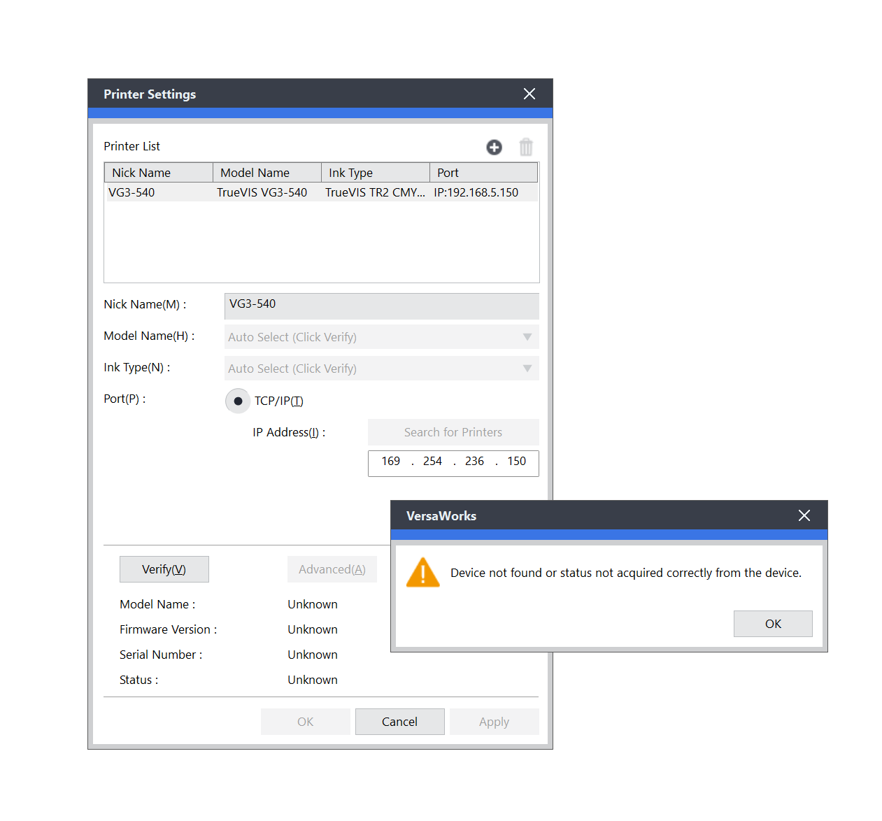

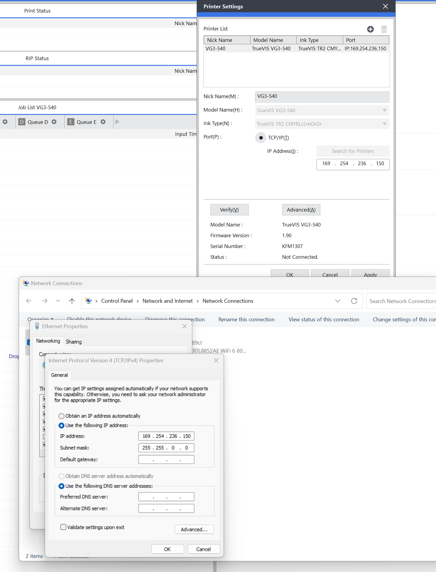

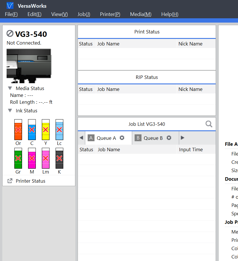

I am having an issue with my Roland Printer and VersaWorks. Apparently, I had to fix my Network Settings on my computer and reset all network settings because my internet was not working right. And it ended up disabling the ethernet connection to VersaWorks. The ethernet cable is plugged in from my computer to the printer. However, it says "not connected." Also, when I go to verify the printer, it says "device not found or status not acquired correctly from the device." I have tried configuring my IP addresses from the printer to the computer. But it still won't find the device.
Here is what VersaWorks is doing:

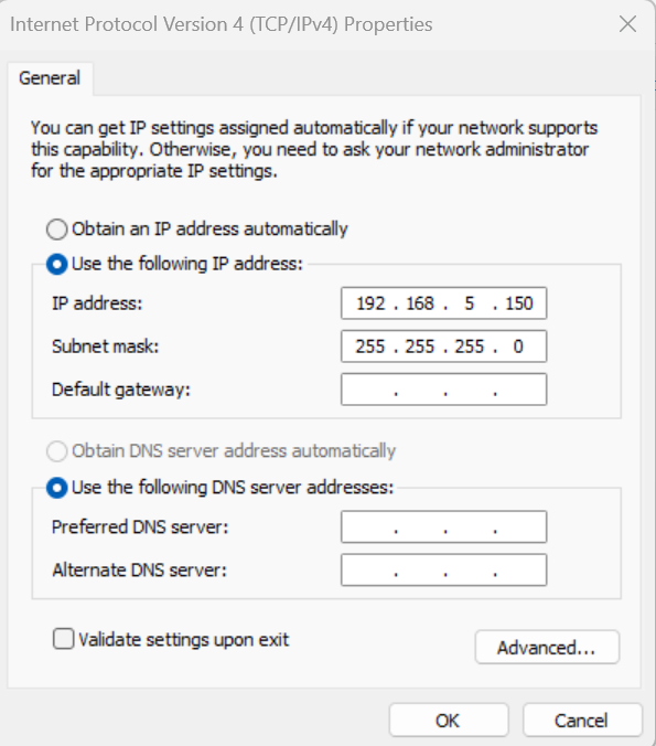

When I do the Roland Addresses, here's what I have created through control panel and Roland Screen:
When I pull up the CMD and do ipconfig, here is my ethernet addresses:
Ethernet adapter Ethernet:
Connection-specific DNS Suffix . :
Link-local IPv6 Address . . . . . : fe80::482e:fb92:7e2e:2113%12
Autoconfiguration IPv4 Address . . : 169.254.236.102
Subnet Mask . . . . . . . . . . . : 225.225.0.0
Default Gateway . . . . . . . . . . :
Is there a way to fix this issue and reconnect the printer to the computer?

192.168.5.150 is the address for the device you set it for.
Now both your PC and Roland is set for same address and there is a conflict.
Set Roland to 192.168.5.151 ex. and try again.
Its like a street, you need a different address for every house.

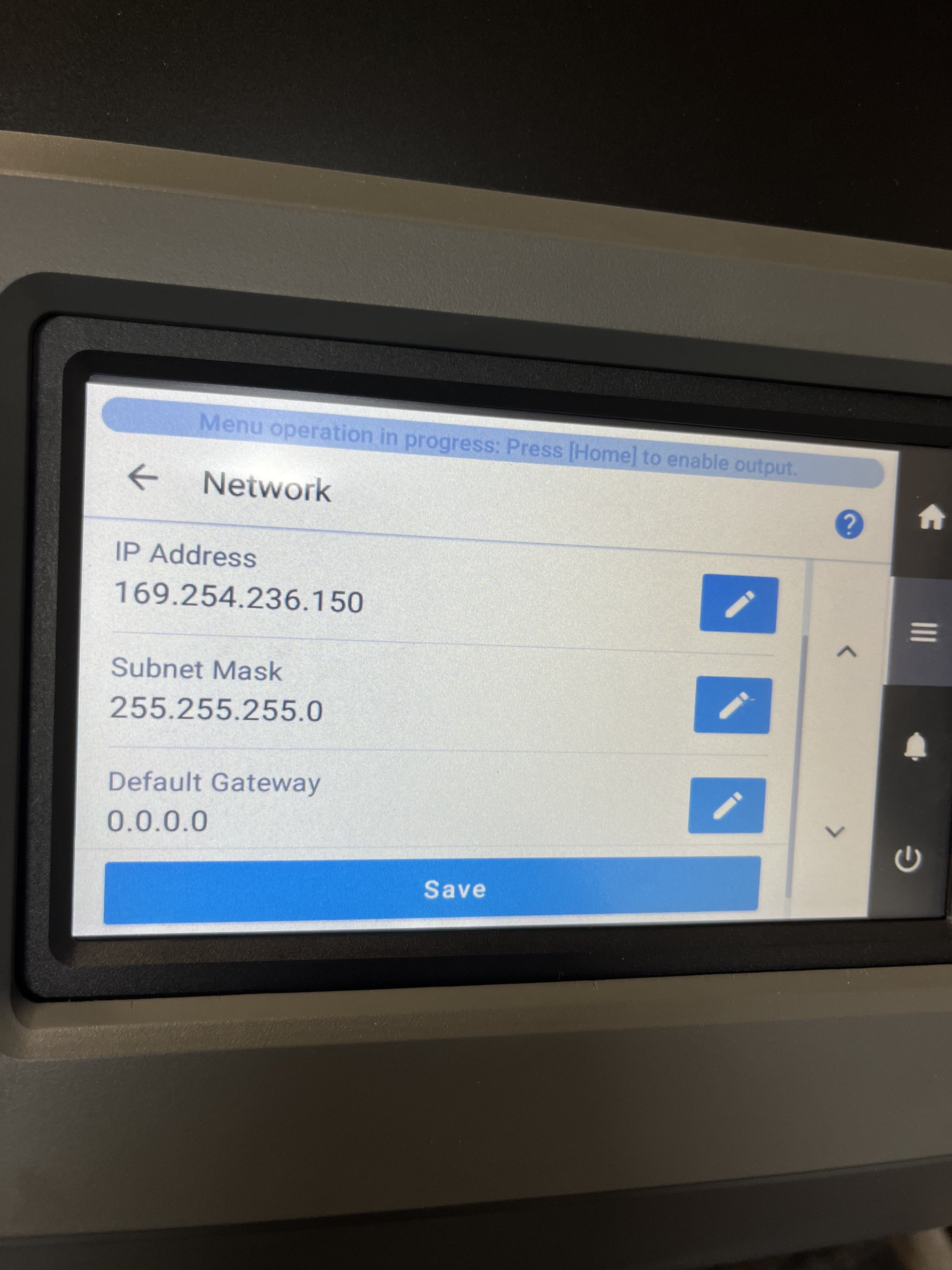

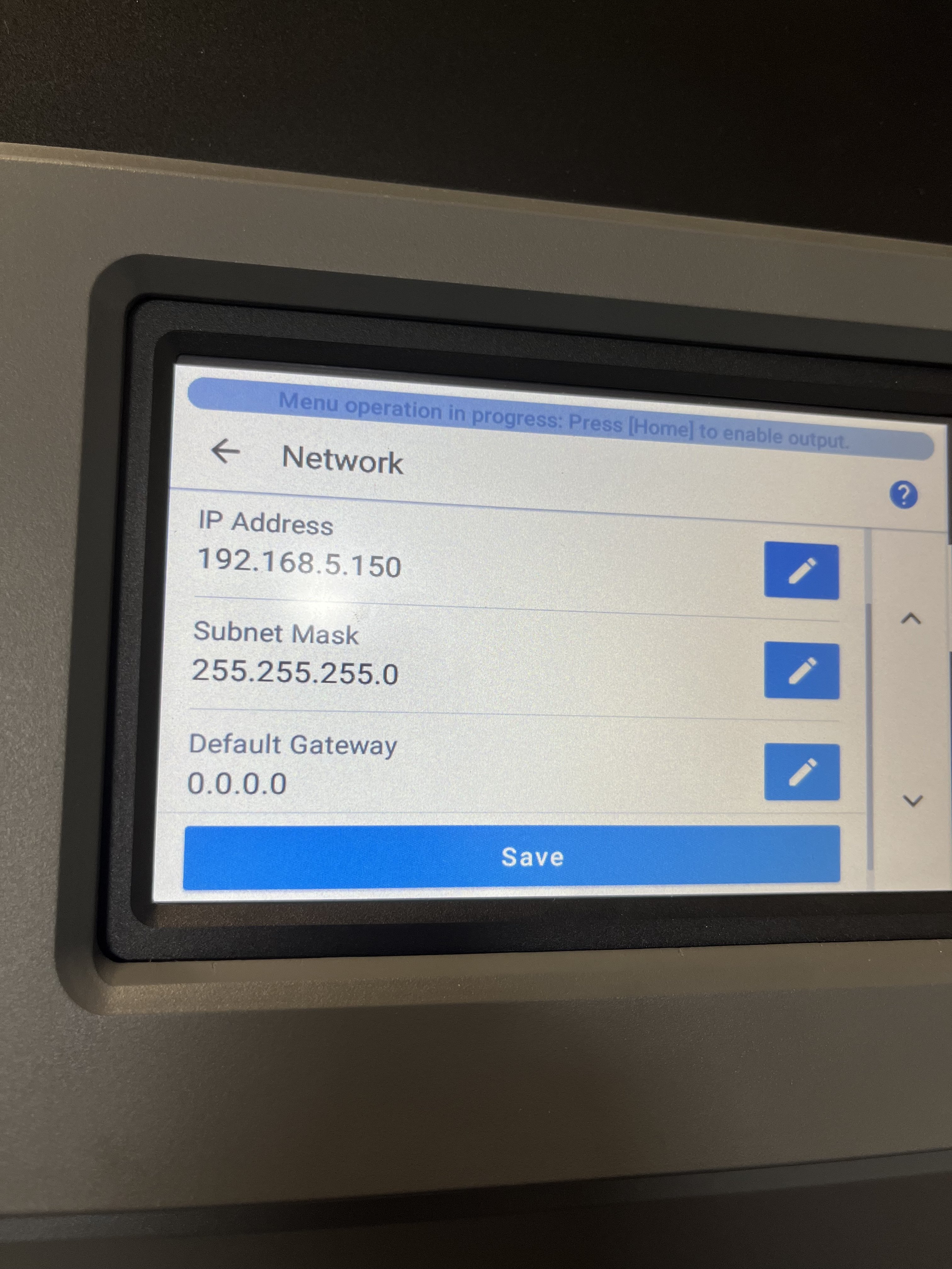

Somehow it connected back to it unexpectedly, I don't know how, but the control panel Subnet Mask is different compared to the Subnet Mask on the printer. The IP addresses remain the same.
Both IP addresses are the same. But the Subnet Masks are different. I'm assuming this fixed the issue or if it was the other way around like the IP addresses need to be different and the Subnet Masks need to be the same.

That didn't really fix the issue. You still can't have same address for two device.
My guess, your PC saw the conflict and picked another address in the 169.254.236. "error" range.
If you now again check ipconfig it might shine some light on it.

Go back to these settings and change your subnet mask back to 255.255.255.0. Basically the subnet mask will restrict where you device looks when trying to connect. Changing it to 255.255.0.0 just means that you're looking through a lot more addresses to find the printer. (Theoretically slowing down your connection, but probably not so you could notice.) You could shorten the range even more by increasing the number in the last group of digits. Google subnet calculator if you want get into this deeper.
Good luck

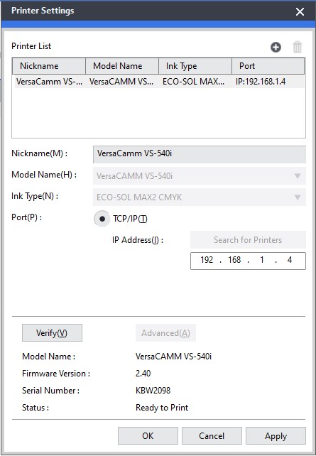

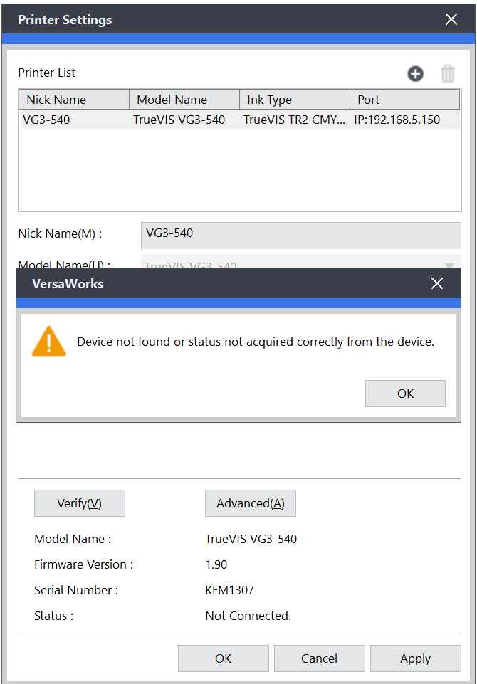

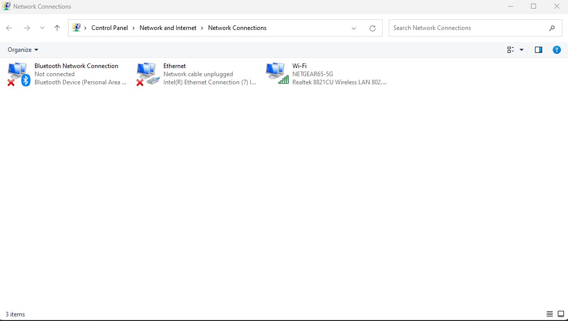

The problem I am having is that the computer IP address that was in versaworks prior to my router reset is not a 192.xxx.xxx.xxx number. It's this. And the ethernet is enabled but states that it is not connected, and while I did replace the ethernet cable hoping that might resolve the issue, all connections are the same as they were prior to the reset of the router. (see images below) 1.1.jpg 1.2.jpg
KGraphics

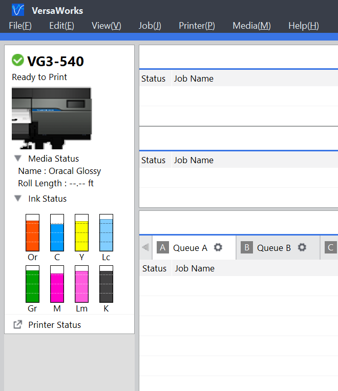

I did change the IP to a new number on the printer and in versaworks and it shows "Ready to Print" when in the verify portion but still shows "not connected" on the side in versaworks
