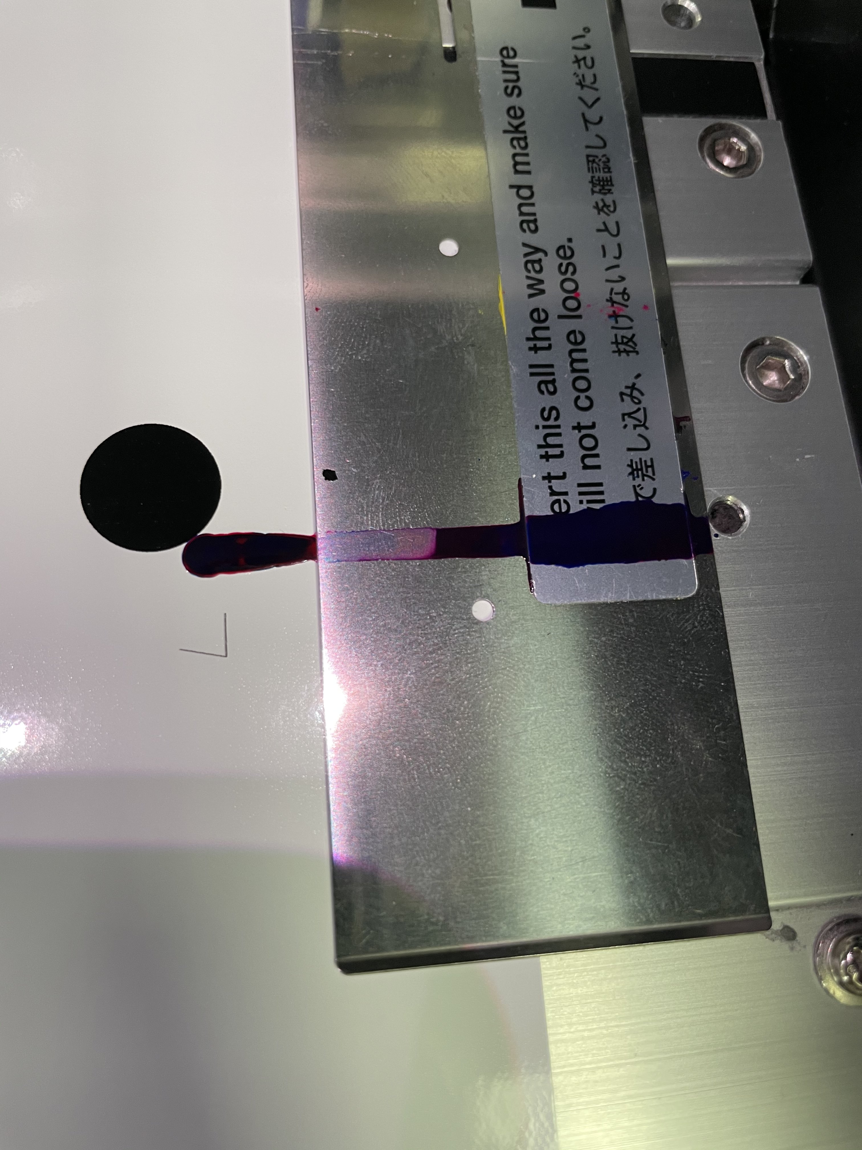

Hey, we recently had a tech come out and replace the captop and head for our Roland printer. Now we have ink leaking out of the head. Any tips on how to fix this issue?

Did the tech replace the damper on the head he replaced? If the damper was the latest version, there is a revision on the dampers for that printer, and the damper fill needs to be done twice in a row. The new damper is designed for the VG2 inks, and the membrane needs to be "stretched" a bit more than 1 damper fill will do. I had this issue and my Roland factory support tech enlightened me, as this change hadn't made it into the latest manual yet. This took care of the issue. You can remove a front cover and disconnect the cap lines to the pumps for the heads that don't need this and save some ink. Advise your tech of this and have him come back and do the damper fill twice in a row and see if the leak is gone.

If you are still using VG inks, you can do it yourself if you know how to go into service mode. If you have converted to VG2 inks, a tech must do it, thank you Roland! A lot of VG owners unhappy about this and rightfully so...

If the tech does the damper fill two times, it should fix the issue. I would have him do it now anyway so you don't lose any prints to ink dripping.

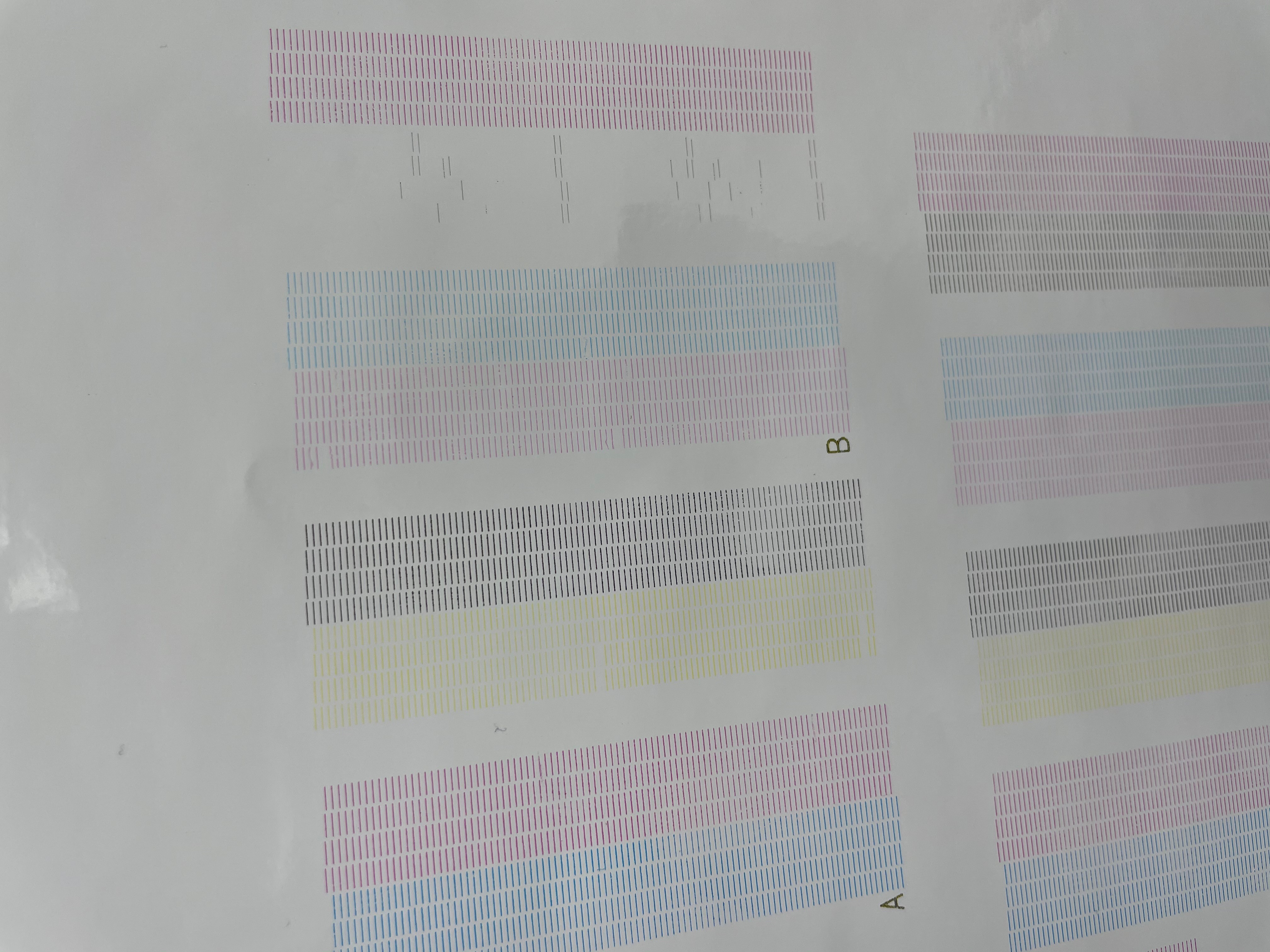

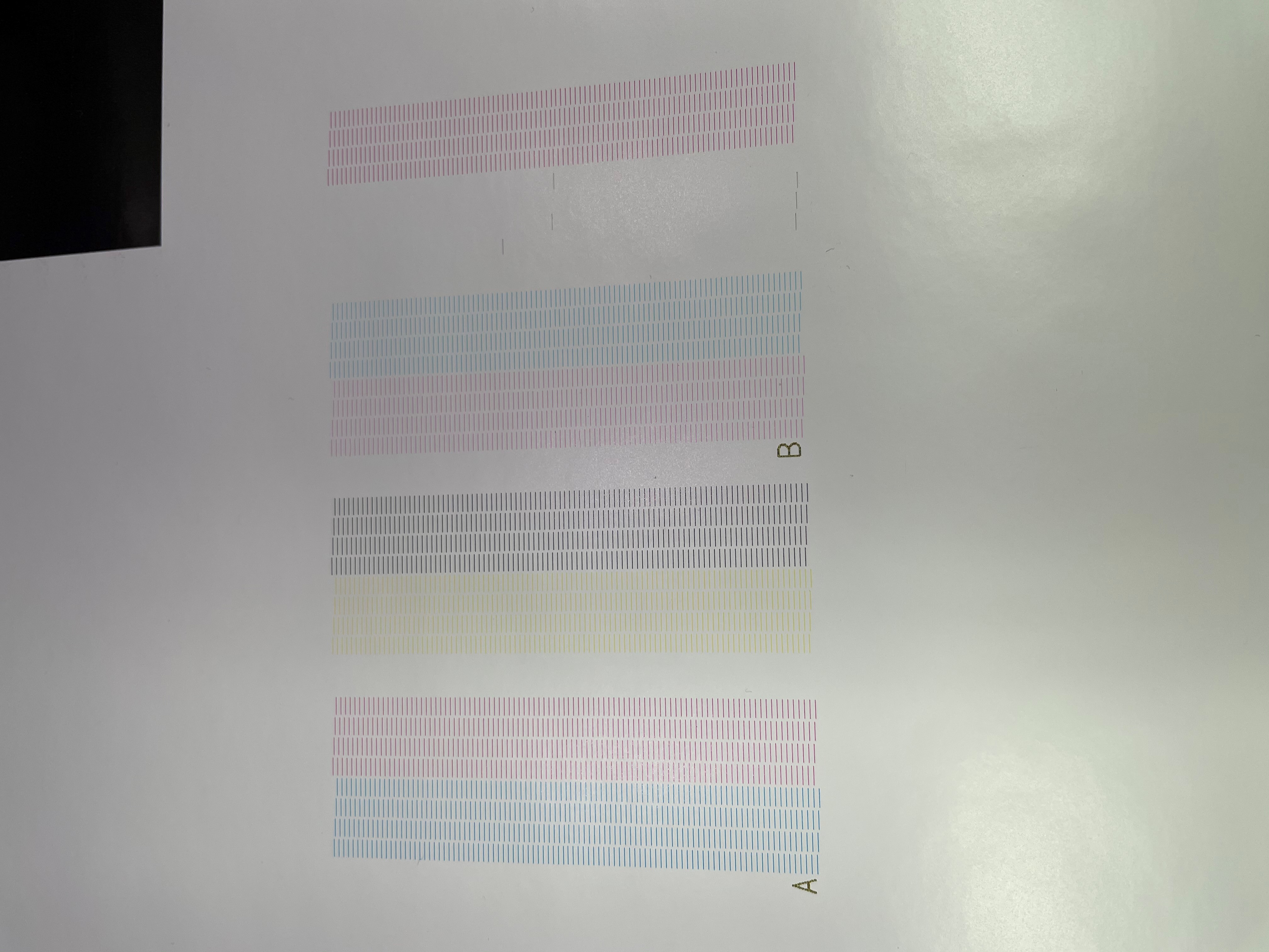

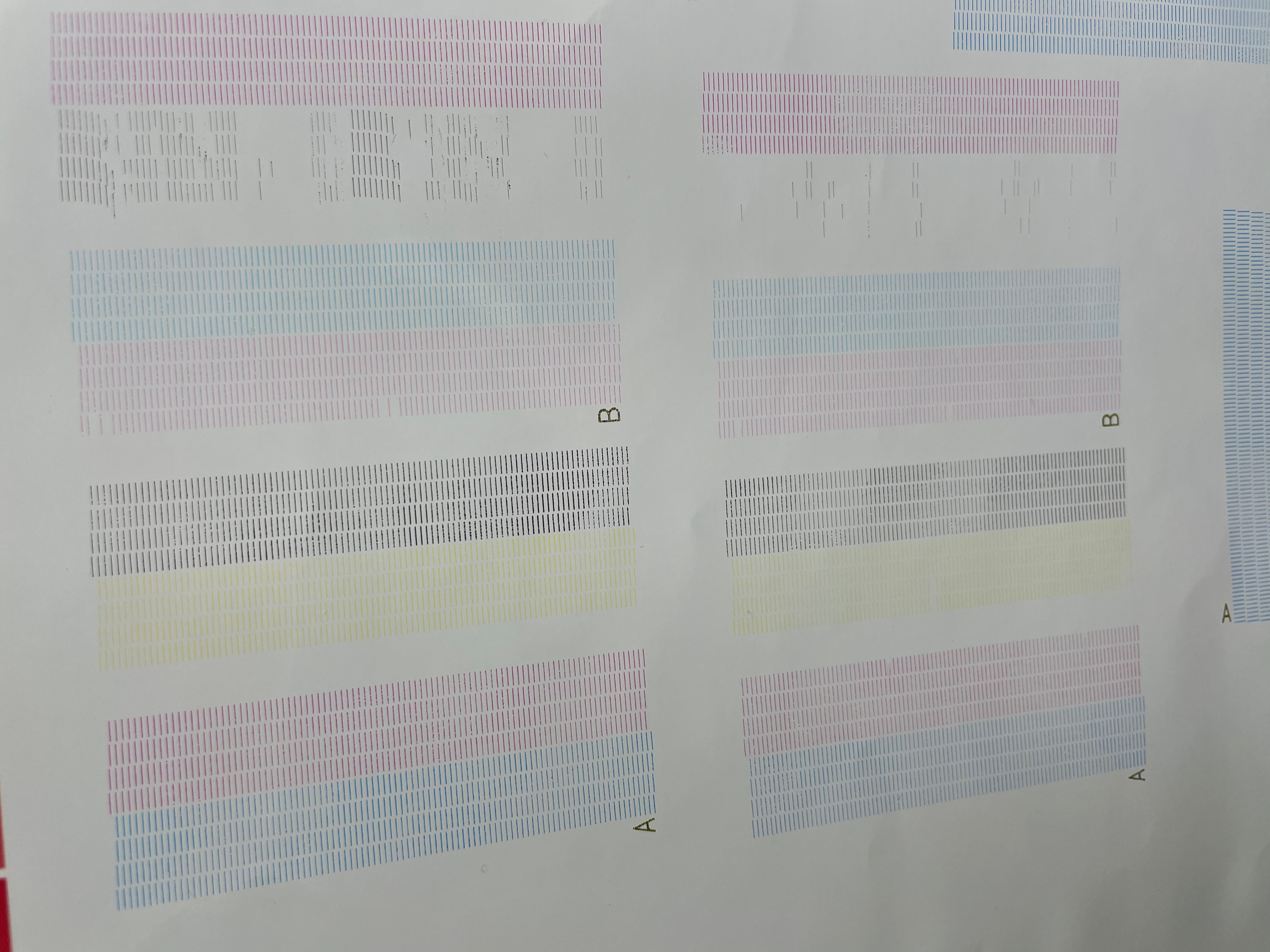

We contacted the tech and he emailed us the instructions to perform the damper fill. So we performed the damper fill twice on Side A and it fixed the ink dripping issue but after performing a test print (attached), The black on the last head was dropping out significantly. We then performed a damper fill once on Side B thinking maybe it needed to be done as well to fix the dropout issue. But that did not fix the black dropping out. We performed a normal clean and also a manual clean, this did not fix it. I then soaked the head to see if it would fix the drop outs but it only got worse (image attached). Any thoughts?
