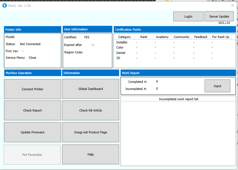

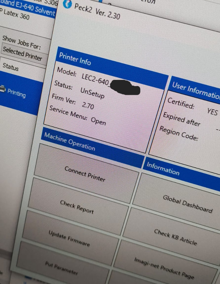

Heads up! I have the Peck2 which doesn't want you to have a FSE account.
PM for the details.

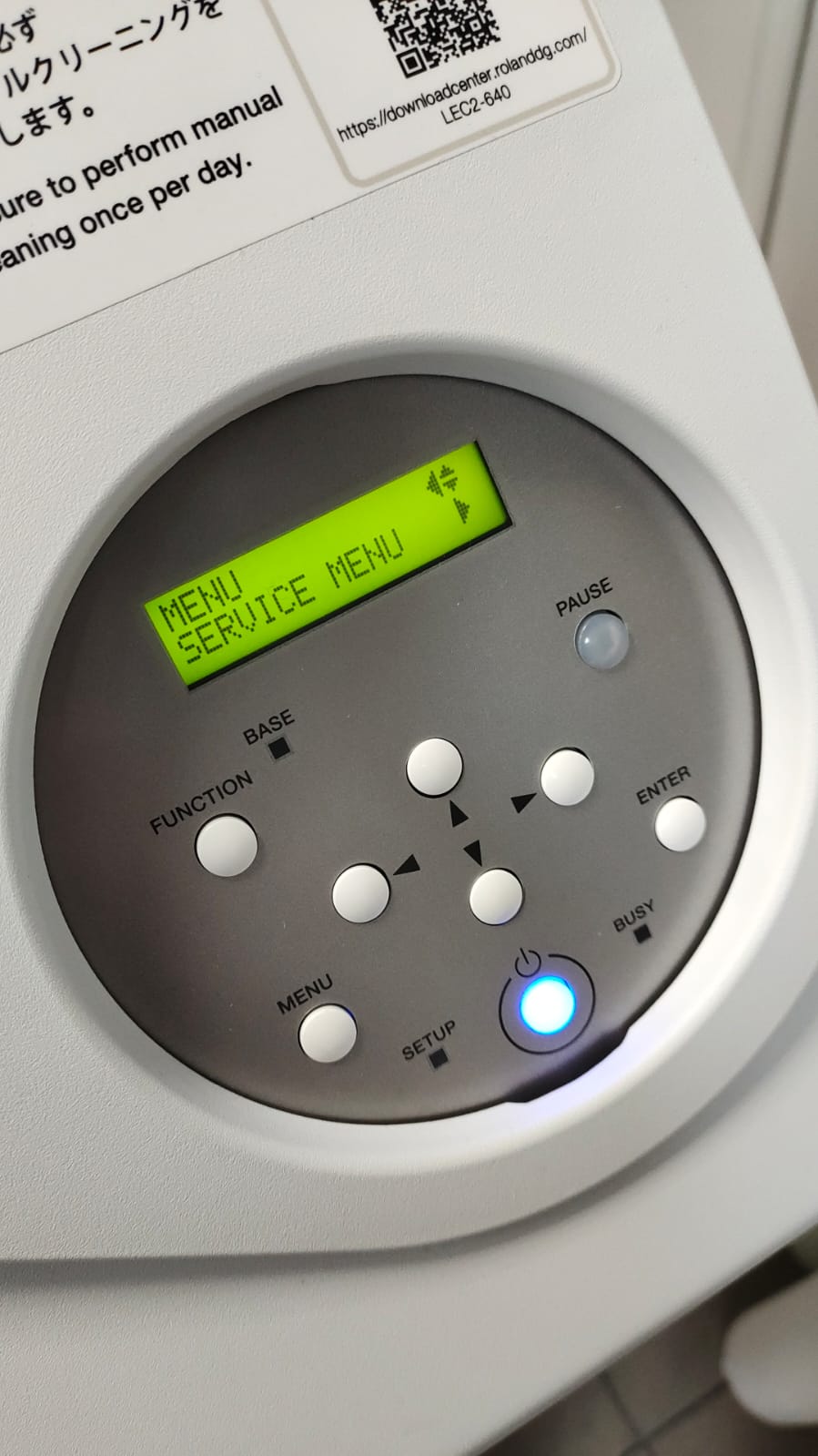

I have two VG2’s and I am able to get into the service menu of both. They are both running TR2 inks. Is there something that I need to avoid to prevent being locked out of them? Our nearest service center is 3.5 hours away. I can’t afford to pay GSG $1000’s just to perform a calibration that I would normally do myself.

Now I could be wrong, but my understanding that anything that runs TR2 inks (upgraded VG, VG2, VG3) has the service mode locked out. You can still perform basic maintenance tasks, but advanced procedures are locked out. I have a VG that runs firmware 3.10, but thus far have been avoiding upgrade to TR2 (firmware 4.50) due to the impending loss of service mode it would entail. I don't use the advanced features of service mode often, but have been tossing around the idea of losing them so that I no longer have to sweat the dwindling supply of white ink. I just worry that if I give it up, then I will surely have a need to read out that sensor voltage!

Both of our VG2's are running TR2 inks and we have access to the service menu.
