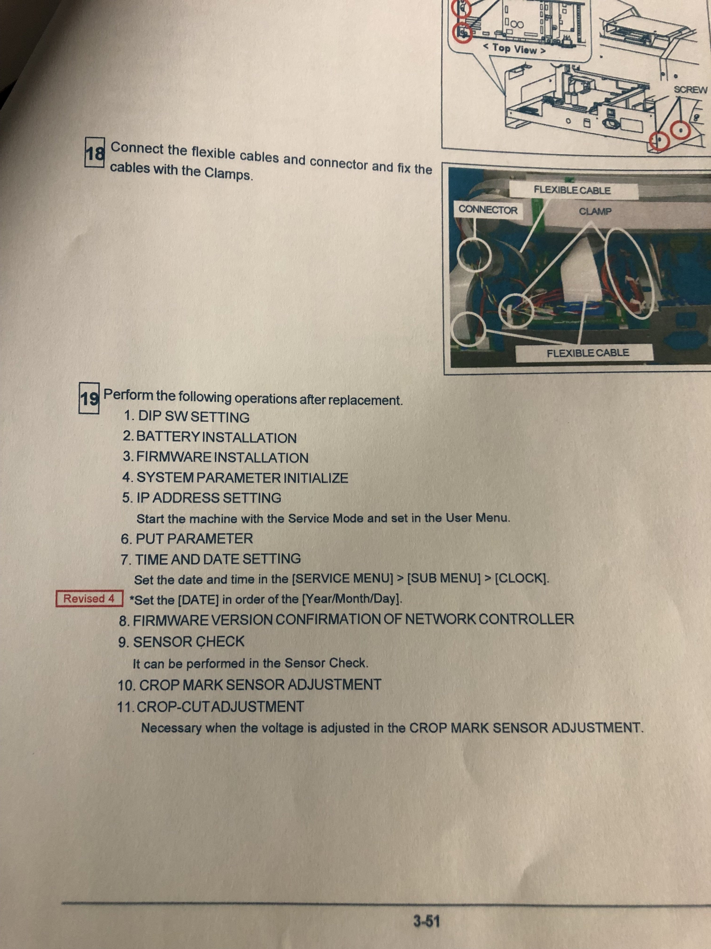

thanks again for the quick reply.
Excuse my lack of knowledge in this side of things. The most I’ve done in the past is keep it maintained.( clean head, cap tops ect)
How do I do the dip switches?
I’ve got the service notes booklet I downloaded which shows how to replace main board but it’s the bits after that get me.
1. Dip SW setting
2.battery installation
( Which logic says to me if it’s In The main board this should be done before you put it back in? But it doesn’t say that.
3.firmware install
4.system parameter initialise
5.ip address setting ( I know is in in user settings)
6.put parameter ( I guess is from the peck?)
7.time and date
8.firmware confirmation of network controller
9.sensor check
10.crop mark sensor adjustment
11.crop cut adjustment
Seems like it would take me a lot longer than 10mins lol.
But I tend to agree with you regarding just changing over the boards and keeping the rest for parts. It makes sense seeings that what I bought it for.
But what makes me think I could get the heads back is I think it was dtf ink which came off from around the heads very easy. And also cleaned the tubes out easily too. Part of me wants to try then the other parts like no just do what you intended ‍♂️
So are these dip switches on the boards? Or in the settings?
Thanks again for all you r help

Before you put the new mainboard in, go into Service Mode and get the head rank for all 4 heads to enter into the new mainboard. Also go into the head adjust section and write down the horizontal and bi-direction settings. In addition, go into the crop-cut and print-cut alignment sections and record those numbers. This will save you from having to run the alignments again.
