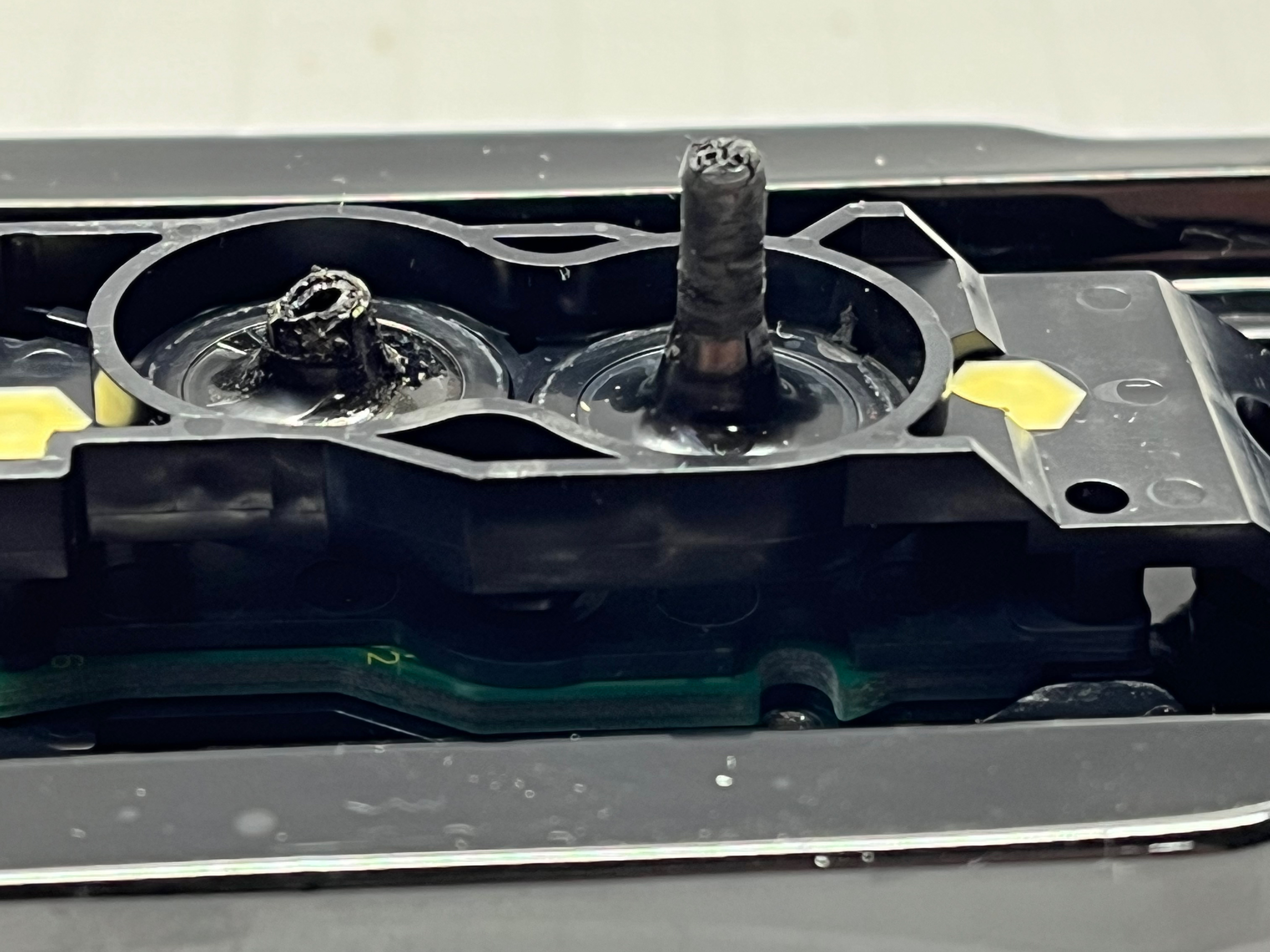

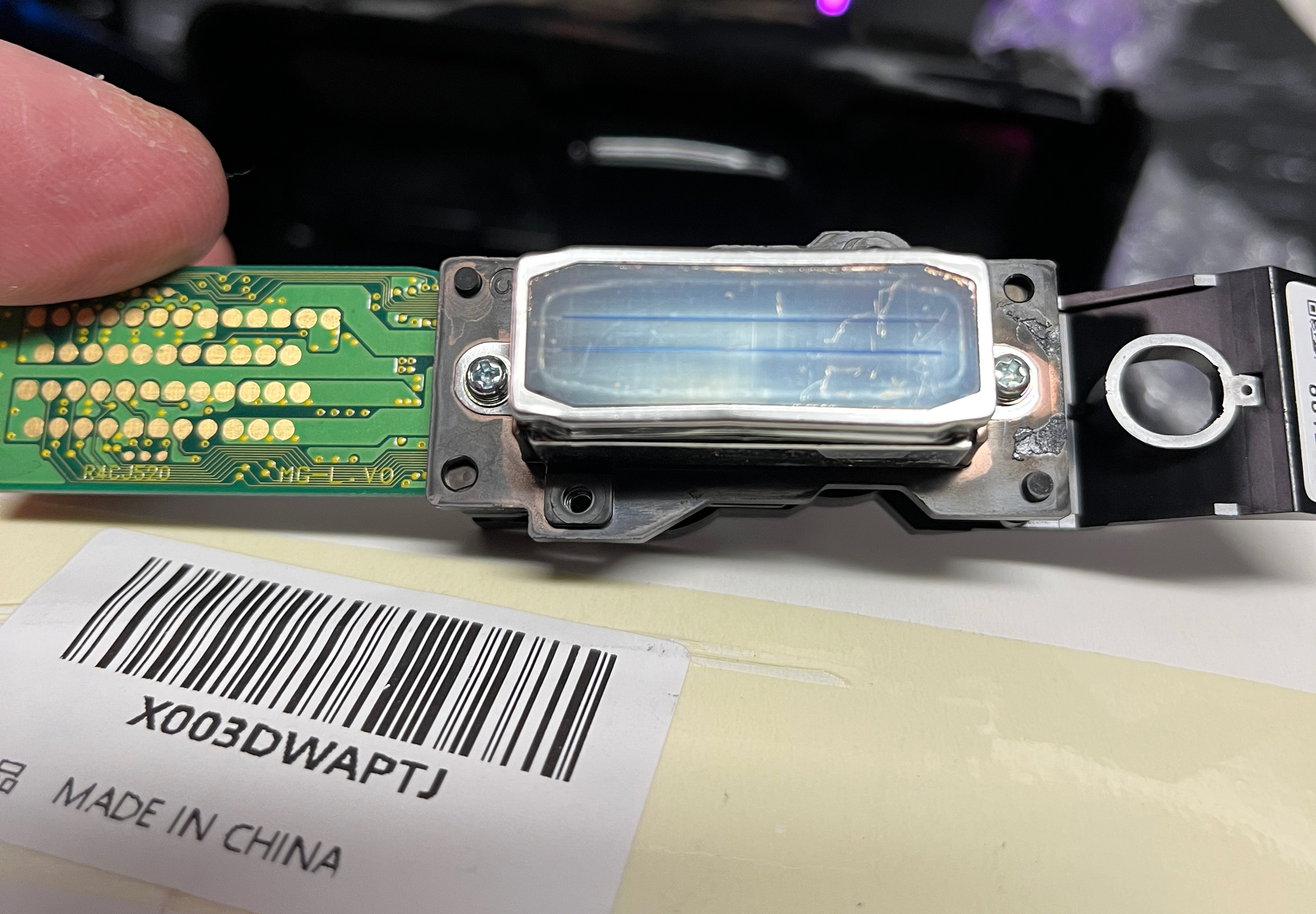

Hello, I made a mistake by buying a printer head from amazon (kind of on the struggle bus and took a chance on a cheap one). I replaced my old head, which was starting to have that overspray effect. I watched a few old videos and was confident enough to try this on my own. I replaced the head and noticed right away that now I had nothing for black printing. I saw a few posts saying to bleed the line and some to use a syringe manually. Before I could do this I took the line off and noticed that 1 of 2 nipples was missing, I was like how did I break this off? I took out the printer head and inspected it, I had to take pictures to get close but the result was that the nipple was glued on and when you look at the other nipple it was deformed and looked nothing like the original one. Story short, I got scammed.
Moving forward, I tried to put back the old head, as I went to put the bladder back on I noticed it was not going in, I looked at the bladder opening and found the broken nipple. I was like fine ill take it out but it was basically plastic mush or maybe even glue. It was not solid at all, after I cleaned the bladder out, I tried my best to clean it with the Roland cleaning solvent. once I felt like I cleaned the bladder enough I went on with the installation and again no ink. I did the Head fill and then also manually tried to fill the head with ink and still nothing. I also tried a head soak and used a syringe to make sure the head was not clogged and I have a good flow on both sides of the head.
So I am stuck, the original head was working when I took it out, and now it is not.

- Some ink spilled on the edge of the printhead circuit board, I do not see ink around the ribbon cable area, cleaned as best as possible and used isopropyl alcohol just on the edge. Did I "F" this up by trying to clean it?
