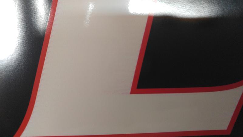

Can someone tell me what is causing this? I was leaning toward the Encoder Strip but would like to make sure before I tear it apart and it be something else. Thanks

Is your head height up? Have you checked the area around your heads? I've seen some fuzzle around the base of the heads do something similar but not quite that extreme.
Just trying to throw out some easy things from first glance.
tintwizz
I have tried up and down and I have cleaned around all 4 of my heads and have inspected with a light and dont see any fuzzies. I am baffled.
