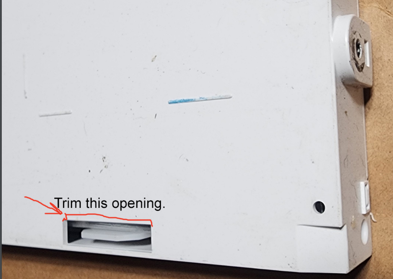

Hey Jim, would you mind clarifying which tab you are talking about and where you trimmed it? A photo would be appreciated. Thanks!

Here you are... It will be a bit of trial and error on the trimming, as you cannot see the sensor arm very well with the cartridge installed. Be careful not to cut the bag!
Thank you! So basically you trimmed this end on the opening?

That is correct. The ink end sensor arm is a 1/4 inch in height, so the opening should be a bit larger than that, otherwise the arm will not drop into the slot to monitor the ink bag.
