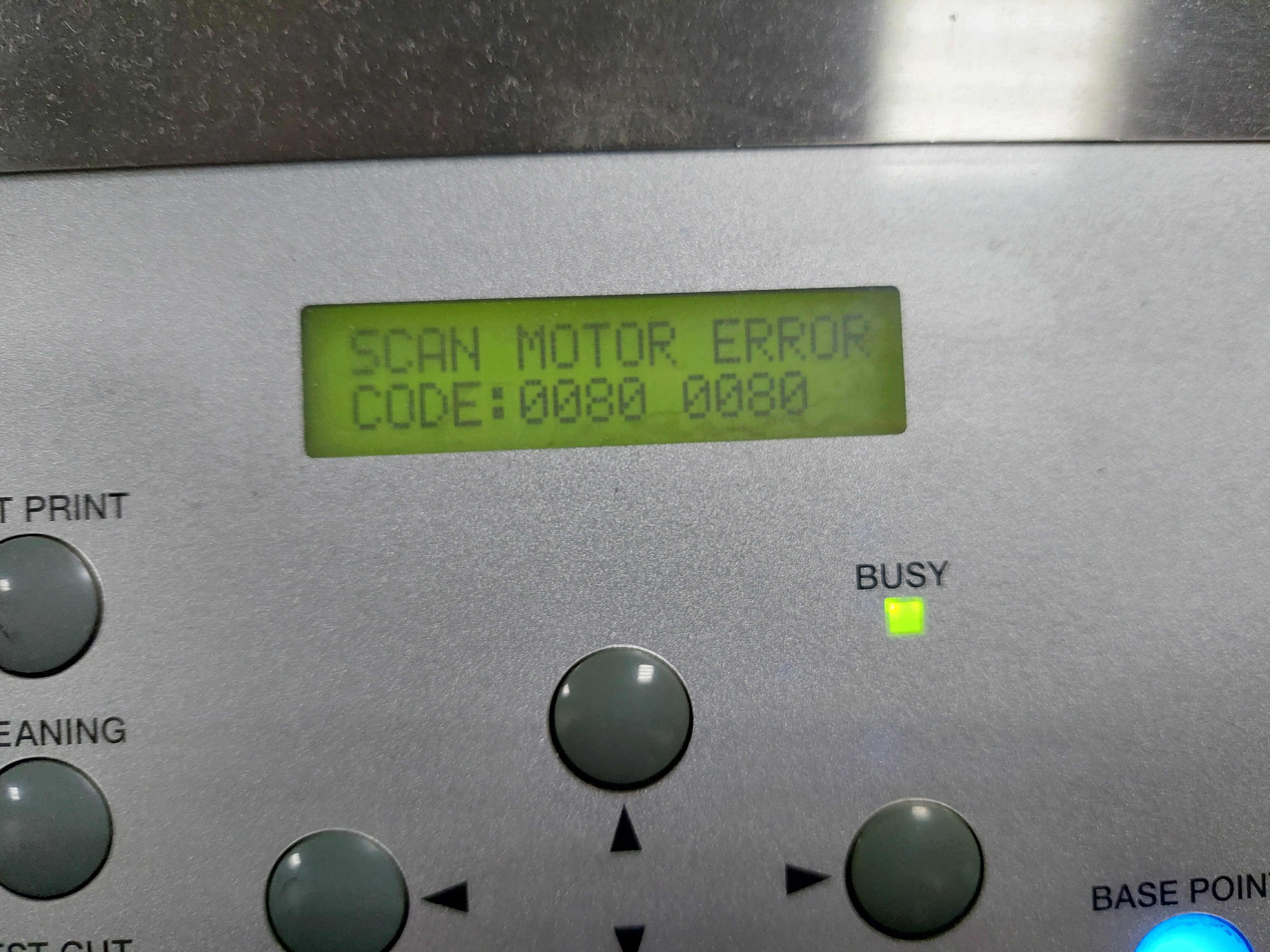

Also, I have also got MOTOR ERROR 0080 while only performing a cutting job, with a strange noise.
That's an over current error, which means there is too much pressure being put on the scan motor. Really sounding like the motor, as bearings rarely go. If you haven't replaced that motor and it has many hours on it, I would say there is a good chance that the motor is the culprit.

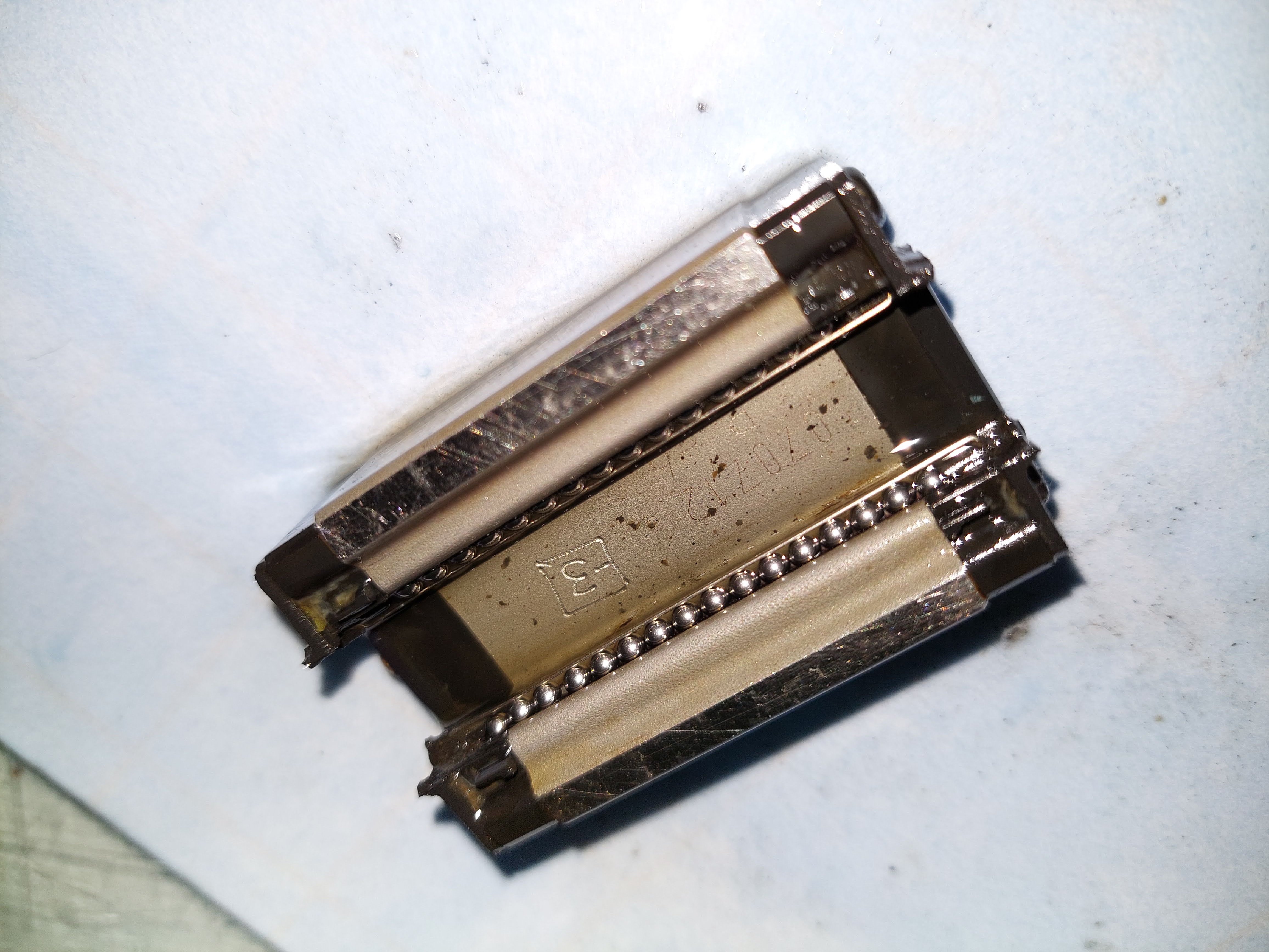

Just want to update the thread if anyone is facing a similar problem, we tried another scan motor, it wasn't the problem.
It was the bearing after all, it was missing balls and was out of grease.
We temporary re-greased the bearing behind the cutting carriage, and ordered a new bearing from Ali Express, when It'll arrive we'll change it to the new one
The machine now works flawlessly without noise.
