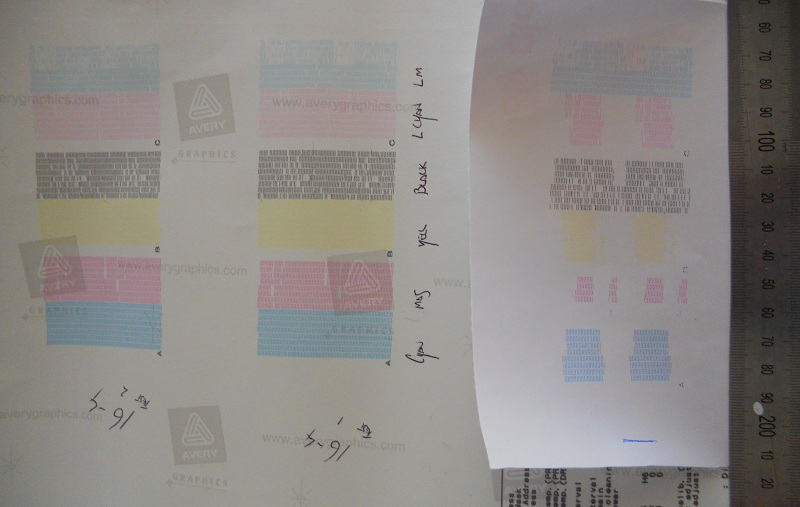

I cleaned with a swab again last night and a medium clean not much difference from a few days ago (still waiting for the parts to come) the image attached is from the first print test to last night
and you can see my progress I think the black mabee worn out as its the color you use the most

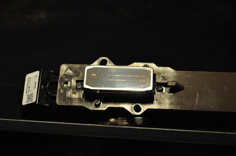

Got all my thing in the mail today and started to replace the dampers and the sent the wrong ones, too small and the hose nuts didnt fit either so once I pulled the dampers off took to the head screws and
pulled the head out to flush it with the dampers they supplied with a syringe. the light cycan and majenta under a good magnifying glass I looked at the head and it looks like they had what I call headstrike
anyway I flushed them and pulled the ink thru and no difference at all mabee 1 or 2 bars better no biggy so I ripped out the Black Ha Ha Ha I condemmed it as soon as I looked Picture says all
there is a good side of the story yellow and cyan's good not even touching that, My fairy tale just had a major car crash, I thought I had hopes to help others but I did pull 2 colors to 100% mabee this was crook from the other person who owned it. This picture of the black head the other two were nothing like this one

I replaced L Cyan L Magenta and Black heads I thought I could get by with the rest (see pict above)
I guess when I wound the heads down manualy to replace the caps and clean it when I first got it, it pulled the coating off the head face
as well as it also had headstrike
No I couldnt get away with the Majenta as I did all the aligning and adjustments when I printed some colors that made up CMYK banding was bad

Back to the remaing head I put a new one in and no banding perfect print so have a look at the majenta in the jpeg above and if your head testprint I would say
you have banding problems too my yellow has one jet blocked but it doesnt seem to matter
