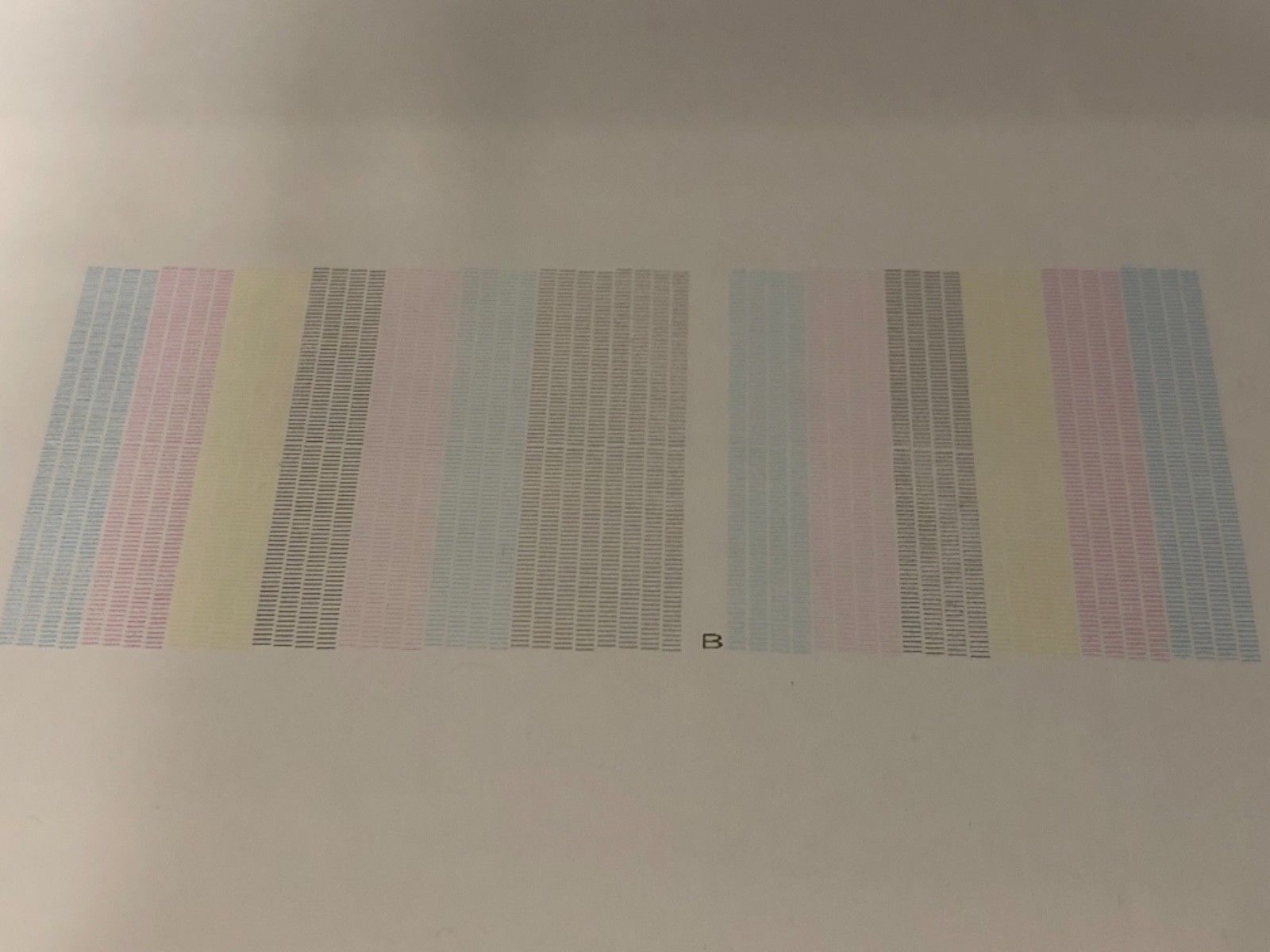

Can anyone advise me how can I pull history report from Roland XR-640? I am newbie in print & cut, previously I have been working with vinyl cutters only, but looking to get into printing as well, so I'm checking used XR-640 in few days time and would like to get understanding of print heads condition by checking shot count. Owner of XR-640 does not have history report and I could not find any information in XR-640 manual on how to get that report...
And what do you think about attached test print?

Broome Signs
test print is fine
