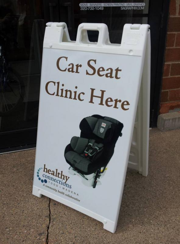

I use a good quality plumbers torch and map gas for "torching" all my signcade frames. I do about 4 of these a month. Even when reapplying after a few months another torching is needed for the application area. I have not seen a failure yet when doing this.
Do the water test on them before and after. You will see a huge difference.
